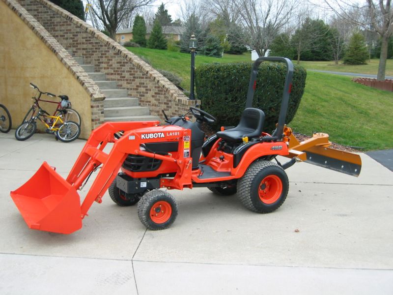

I love the loader!!! Have not used it much yet as I just got it this fall. I moved some railroad ties with it and some sand.
I purchased the RBC60 woods rear blade as ballast. Works great and I get the added benefit of using it for snow removal.
You will love the bucket.
