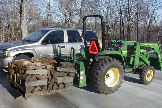

Finished retrofitting the Deere loader forks to attach to the iMatch quick hitch so I could lift pallets of dried, split firewood and carry them to the house. Followed a pic posted here sometime back for the inspiration to do the fabrication.
Pic shows the first pallet of wood yesterday (no snow yet).

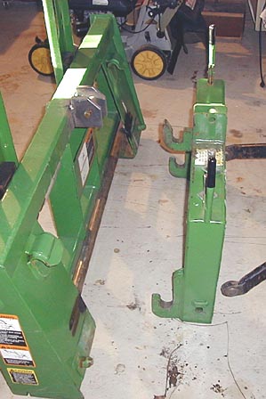

Lined up iMatch between 'new' forks and 3pt arms showing the 1¼" rod welded across for lower hooks to engage, and the top brackets and pin with bushing for the top hook of the iMatch to engage.

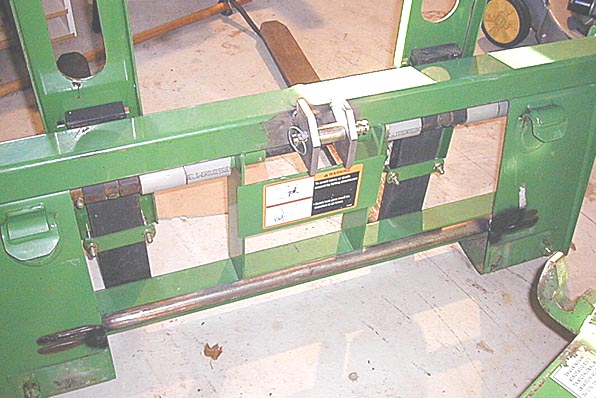

Another angle showing the rod welded across the bottom of the forks (can see weld marks on both sides) and the top bracket with pin and bushing in place. It is ready for the iMatch to engage, or it is ready for the quick tach hook-up to the FEL. Used it in both positions today. With snowplow on, and without the FEL on, wood will be hauled in using the forks on the iMatch (drop the ballast box, and pickup the forks).
The time will come when the T-n-T will be real handy adjusting these forks to slip into the pallets. Maybe this spring, if all goes well. /forums/images/graemlins/smile.gif

Thanks for the compliment (JackIL as well). I can't think of a reason to make the top adjustable. The three hooks on the iMatch are fixed in position, so I don't see any need to do more than make the receiving pins fixed to match. Do you have something in mind I may have forgotten?
I will try to get a pic of the back, but the 1¼" diam bar is about 4" longer on each end than the opening between the steel plates to which it is welded, and it is welded tight against those plates. One pic shows the two weld lines in the paint pretty clearly. Position is the only critical determination.
With the weldment that I did, this fork won't fit the 3pt arms, as the bar across the bottom is too large for either cat I or cat II. It's stuck on a quick hitch for sure. /forums/images/graemlins/wink.gif

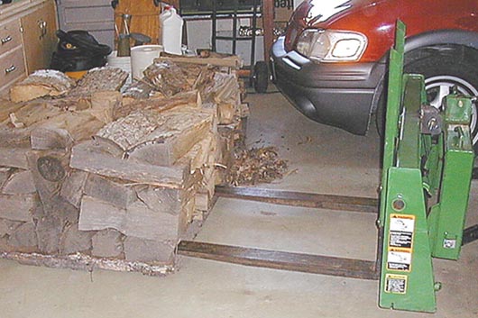

Here is a pic after dropping the pallet and pulling out the forks.

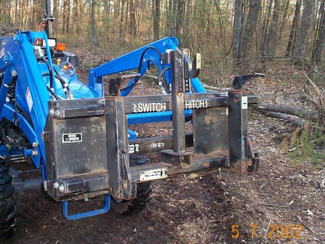

You did a great job with that conversion. /forums/images/graemlins/smile.gif Are those forks the Deere floating tine or fixed tine forks? What is the difference? /forums/images/graemlins/confused.gif
