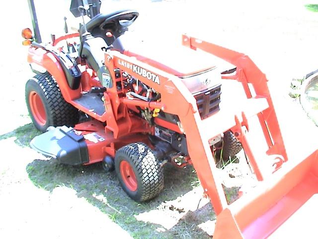

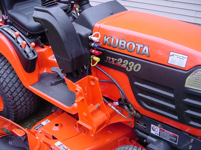

I am wondering if the loader support bracket that bolts to the frame for the loader is interchangeable between the bx1500 and the bx2230.
Reason being is the valve and control stay with the bx2230 real nice using the quick detach pins like in the photo i attached. On my model you have to remove 2 extra pins if you want to keep the control with the machine and not leave it on the FEL when you remove it Like in the 2 pic I attached below.

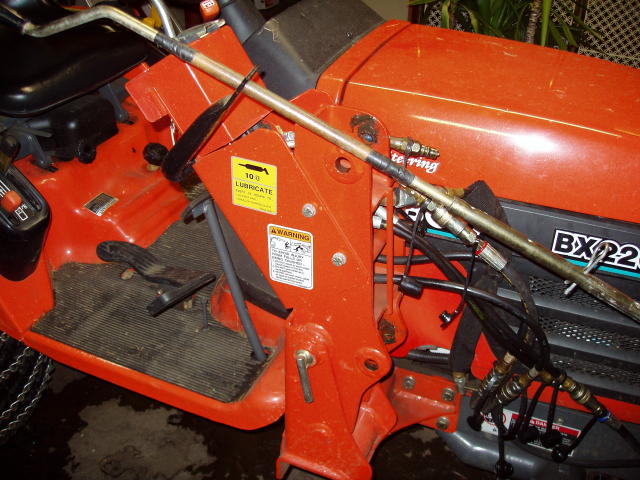

Here is how it is on mine. (not my tractor just a pic showing the layout)
The valve on mine shows its a bx1612 4 way valve........

Ive been looking at different pics since i posted this and it seems the new la211 loaders all come with the new style valve no matter which bx you have.
I was wondering if anyone knows if the new la181 also had the new valve that stays with the loader brace as in picture #1 above and not the loader arm such as in picture #2 above.
I bought my loader new but am beginning to wonder if it wasnt a left over unit. I first need to find out if the la181 has the new style "stay with the tractor brace, not the loader arm" type of valve.

   / Loader frame arm swap #6
The older LA211 controllers were mounted to the upright like your 1500. The attached pic is of my BX2200. As long as you have quick connects on all your hydraulic lines, it's no big deal. Remove the loader, then pull the 2 pins where the loader arms join the upright. Transfer the upright with the controller attached back to the FEL quick-connect.
The attached pic shows it mounted for use with the front snowblower.

I have looked at both pictures and I believe that what you have is the newer style valve that is mounted to the older style upright by the bracket plate under the valve. If you look at the picture of the 2230, you will see how it is mounted to the tractor frame. I believe that if you can fashion the bracket that is welded to the frame, then you will also be able to mount your valve to the frame just like the 2230. My guess is that your tractor was made before the second design was completed, and they ran out of the older style valves and just started to use the newer style valve with the older mounting brackets. One thing to check is if the brochure for the newest BX1500 shows a change in the valve to be like the BX2230. It might just be that since the BX1500 didn't get a model number change, neither did it get the upgrades that went with the BX1830/2230. It would be a easy upgrade for the Kubota dealer to do, since you already have the newer valve. It might cost you $100 to have them do the fabrication and modification, but it would be well worth it just for the convenience factor. The only way that you will know for certain is to find a dealer that has a new production BX1500 in inventory and for you to physically look at it. If it is different, take pictures and then start complaining. If it is the same, then you are stuck with what you have. One other thing is that Kubota reserves the right to make improvements at any time and that it doesn't require them to make upgrades to previously manufactured models. If you do find that a change was made, take pictures of it, so if you have to do the change yourself, you will have pictures for guidance
