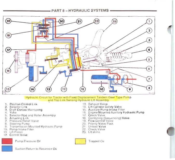

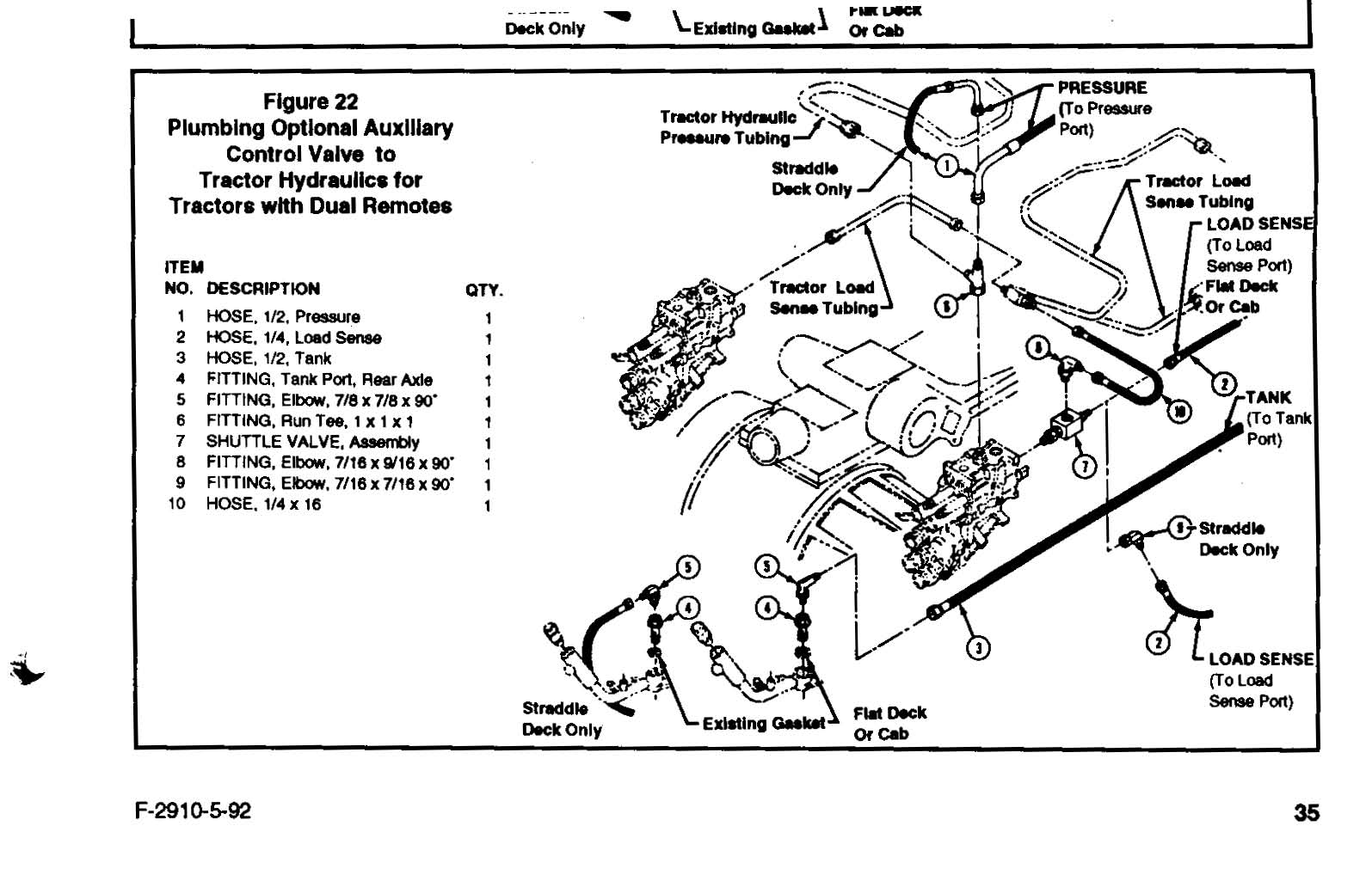

No there is no symbol manual I can find on some colored flow diagrams that show how oil flows through the tractor. Not the loader as it is an add on. I called my dealer to make sure and he said they didn't put symbol charts in the older tractor manuals and that there was no service manual for the loader only a owners manual. The loader owners manual has a picture of how to plumb it with the four remotes

According to TractorData.com Ford 6640 tractor information your machine has a Open Center (OC) hydraulic system. I noted in your other post you linked that you wrote this in response to Rick's question about how it was plumbed:
Its t'd into the steel supply line that runs between the proportioning valve and the rear remotes.
With an OC system, you can't have valve's paralleled or Tee'd into the system, all valves MUST be connected in series or the the hydraulic fluid (like electricity) will "take the path of least resistance". The symptoms you describe about having to deadhead the rear remote is the tell tale sign to me that it is plumbed incorrectly. It works when you deadhead the remote because the fluid is forced to the loader valve instead of going through it because it's easier.

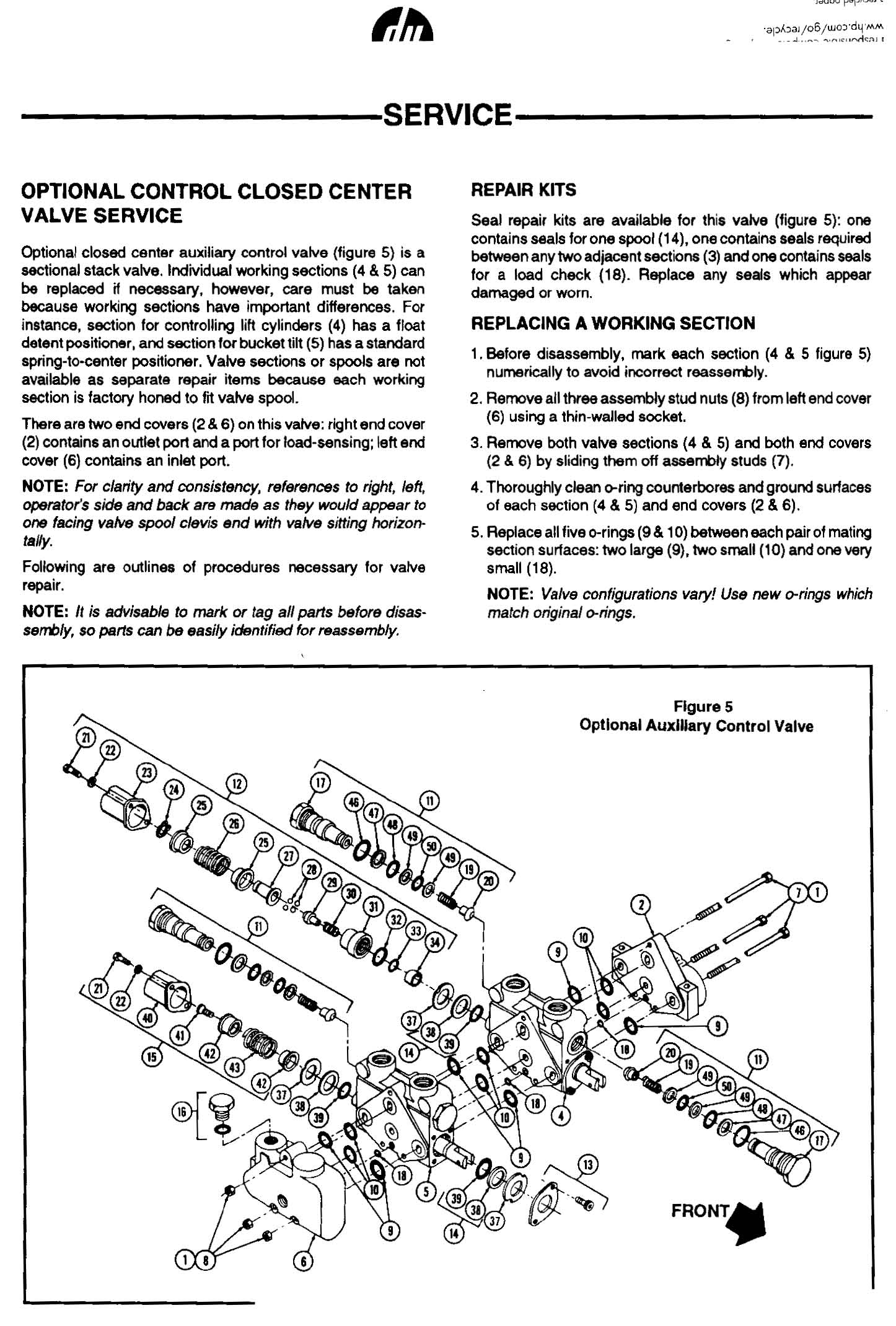

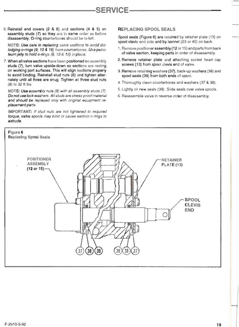

Yes loader was working fine until sometime in late April. Then it starting going downhill. It still will hoist slowly and lift a minimal amount of weight unless you deadhead a remote. I have never changed the plumbing this is how it was when I bought it approx 4 years ago. The Owners manual (there is no service manual for It) for the 7411 Ford loader says Optional control valve is a closed center (see attached pictures) This tractor has a fixed displacement tandem gear pump system. (Some of the other versions of this tractor have a variable displacement type) It has two basic pumps the main one on the side of the transmission and the auxilary mounted to the front of the engine as shown in picture I posted earlier.

Interesting:confused2:
This is contradictory though:
A fixed displacement pump indicates an OC system requiring a OC valve.

I think that is why Ford/NH uses a Priority valve pack on top to the differential. That way they can use the same rear remotes and auxillary valves with either type pump they put on the tractor see attached picture.

It might be one of these closed center/fixed displacement pump systems with a load sensed dump valve (indicated by pos 2, combining valve, on the attached picture)
