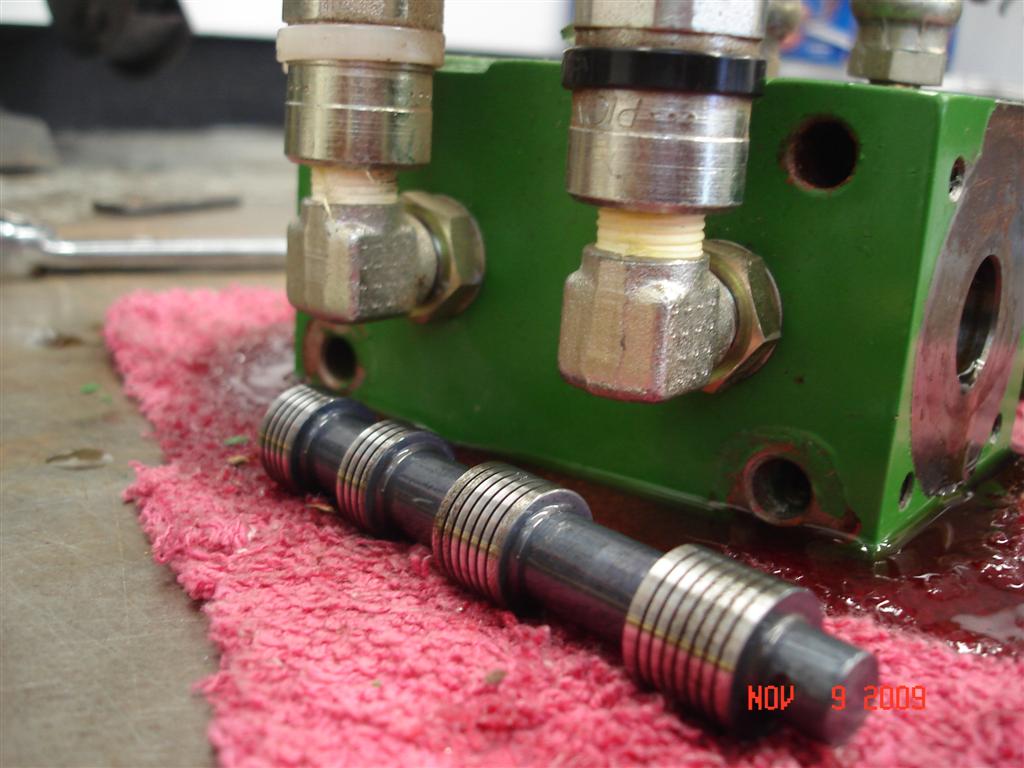

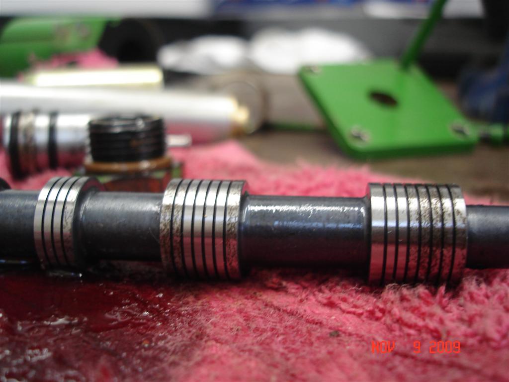

Two years ago I went to use my grapple, and the diverter would not work...I finally had to take the valve apart and I found that the spool had corrosion on it! Not much-but enough to keep the spool from sliding in the bore (see pictures below) This was before I had my pole barn and I kept the loader outside under a tarp. I guess there was just enough moisture in the fluid to do this.
My point of the story is to let you know that it only takes a very little something to stop the spool, and if its getting stuck then I think that may be the problem. Most spools have a hole so you can manually operate the valve, Nelson describes in post #8 of this thread.
Is yours a WR Long valve or Kubota?
