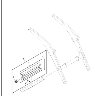

I think I could make some FEL cylinder locks out of some pieces of angle iron for a lot less $$$$. The locks were listed in PC for H180 FEL(N American edition) BW16466 SERVICE LOCKS AND HARDWARE ADD 218.90 USD

A piece of angle iron and some band clamps is a fairly standard method for blocking a cylinder extended. I suppose one could use zip ties instead of clamps in a pinch. You don't need a U-channel piece.

If you look closely at the photo I posted JD supplies four(4) zip ties with their $218.90 bargain.
