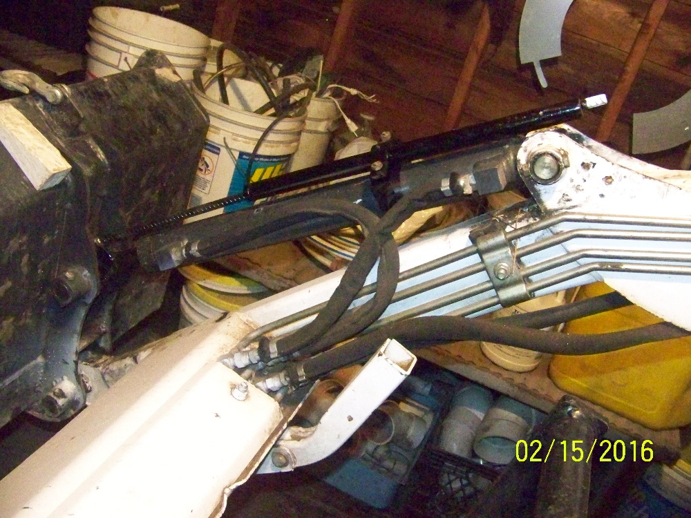

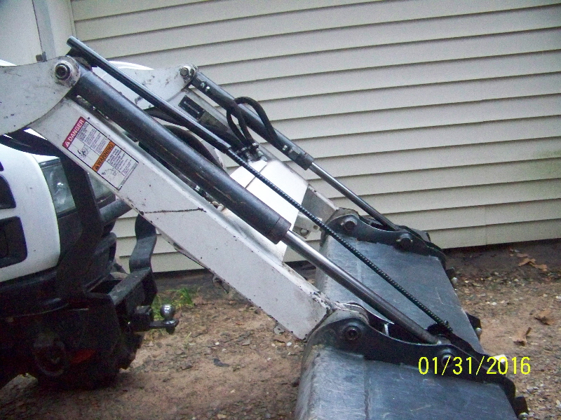

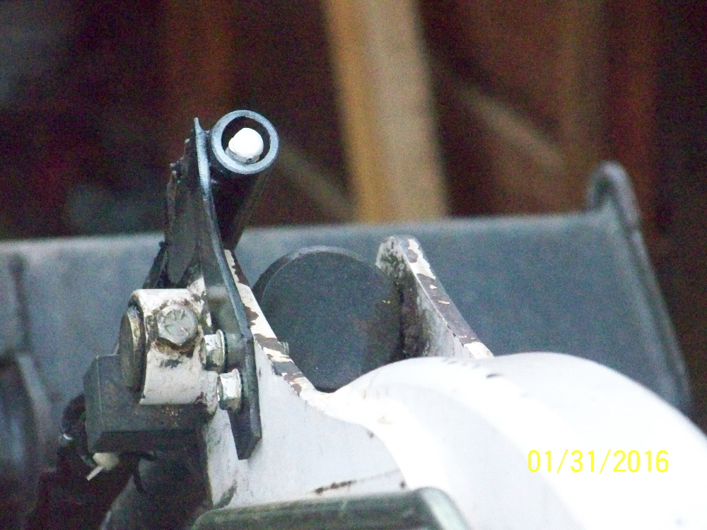

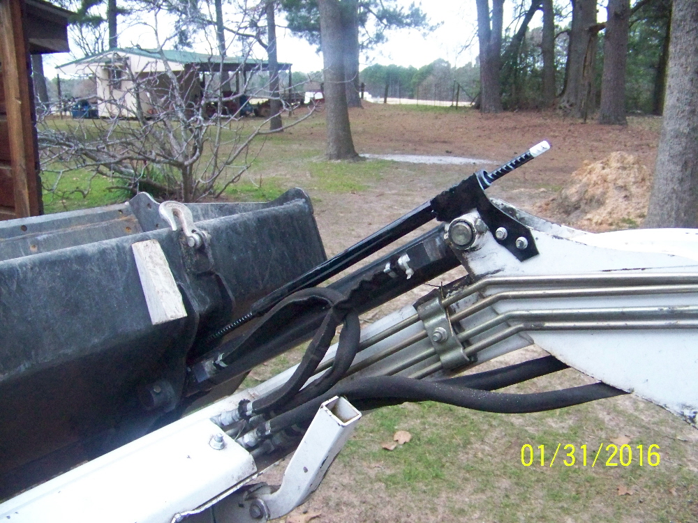

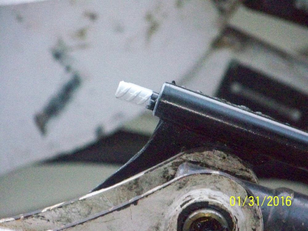

My effort for a bucket level indicator. When the bucket is level on the ground see photo one. when bucket is in dig position see photo two. A piece of 3/8" rebar, small section of 1/2" pipe. Upper mount a small piece of 3/16" flat metal, lower mount a small piece of 1/4" flat metal.

Nice add on but what happened to the original one that comes the loader? On the original the tube clamps to the cylinder so it is adjustable for amount of rod protrusion desired and with it clamped to cylinder the angle of the tube to bar always stays the same so rod is not rubbing on tube in full dump or roll back.
   / loader level indicator CT235
No idea it was suppose to have one. I will investigate and maybe change a bit.

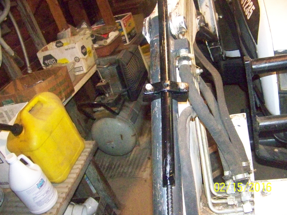

Thanks to SSdoxie I went to the Bobcat parts pages, took a look at the Bobcat indicator and believe I have now fastened it similiar to theirs. It works anyway.

Does it rattle?
Hard hearing as I am I couldn't say it does or doesn't. Engine noise is definitely louder than rattle if it has one.
   / loader level indicator CT235 #8
Same here. If it does rattle, it blends in with other noises of tractor. If rattle was noticeable the outer tube could be made using PVC.
