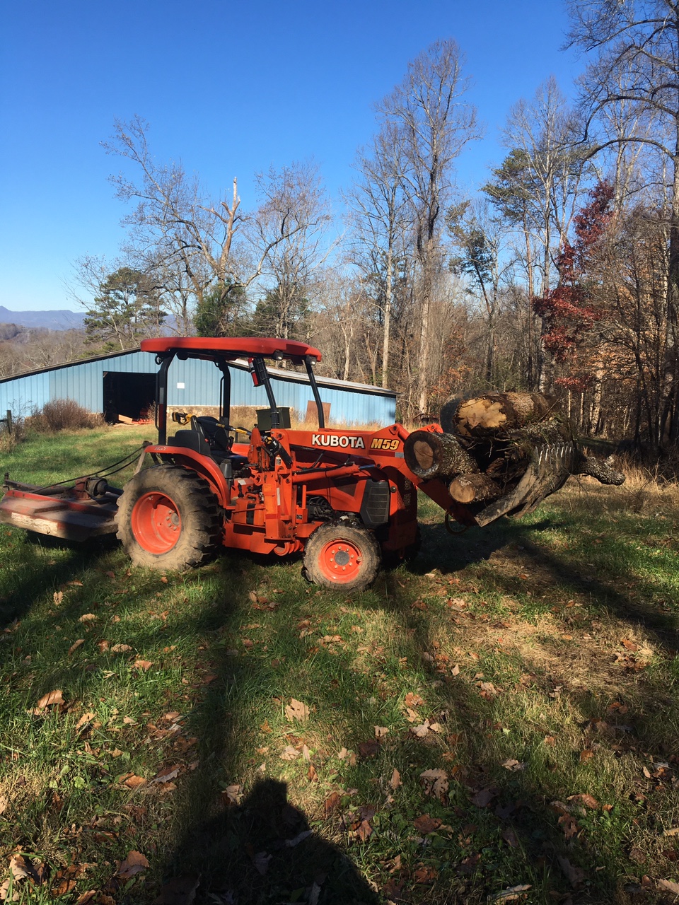

Recently retrofitted a Kubota Soft Ride (KSR) system to fit a M59 loader. Nice upgrade and would highly recommend this option if available. Greatly reduces stress while carrying loads.
Added a permanent pressure gauge at the same time. Anyone else monitoring their loader lift pressure during use? Advice?
Not only did I want another way to evaluate the KSR system but learn more about the dynamics of the hydraulic system. See if I could use it to roughly measure the weight of what I’m picking up. Large loaders at quarries use similar system.
Only on for a few days so trying some experiments to evaluate if this is something that is practical.
Grapple empty 630psi.
Grapple I think is 850#
Need to measure with the grapple off.
How the weight is measured relative bucket pin.
Dead head lift into brush pile, 2600psi. Slightly lower than the 2750-2950 spec. 1400+hours.
Could curl while at max lift 3700psi. Showing how trapped fluid in a circuit can exceed pump relief valve pressure by external force. Curl, grapple, push/pull driving, and bouncing.
Curl effects lift circuit psi. How high you lift. Some loaders have graphs showing lifting capacities along their lifting range. Sitting with engine off, grapple empty but not on ground after using has 1800psi I guess due to thermo expansion. Lot to consider and respect when seeing how much pressure is in the system.
Don’t have many known 500#-ton weights sittings around to calibrate.

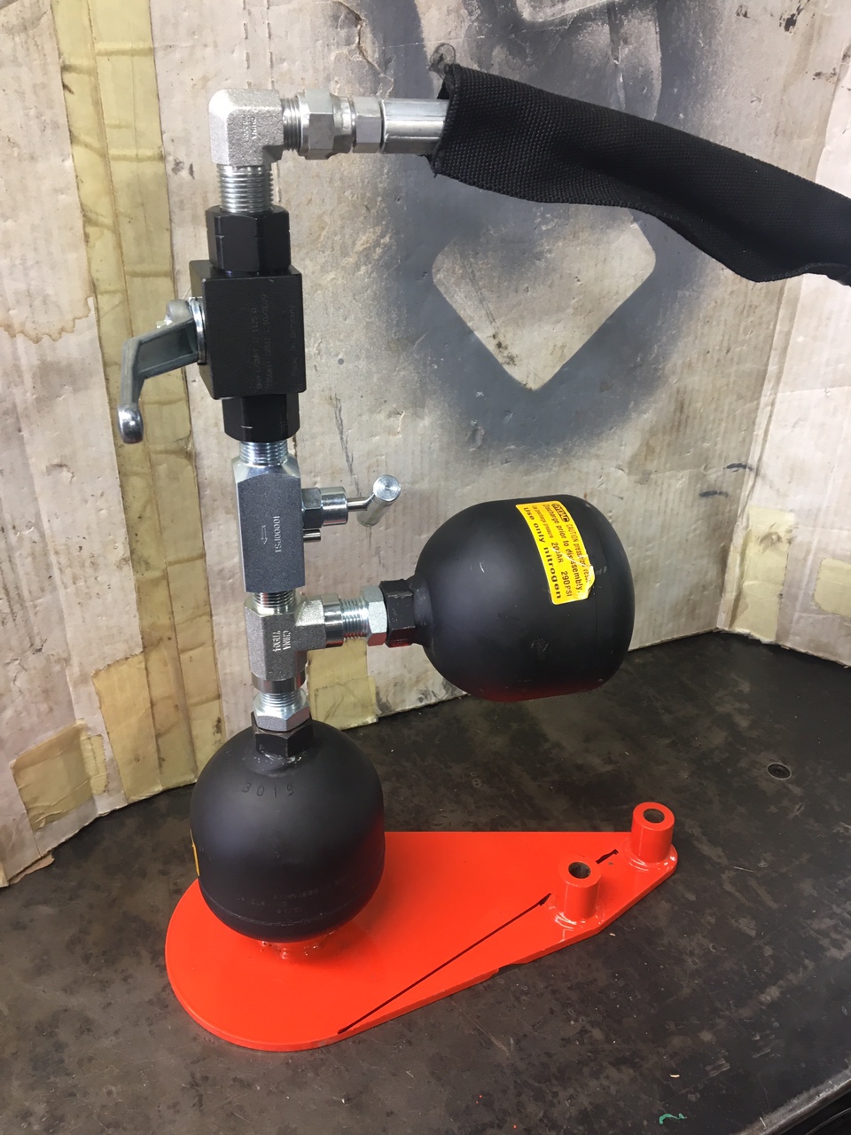

do you have any pics of the actual soft ride system. where did they mount the accumulator. are they piston or bladder type. one or two?
the wr long system has two bladder type but I'm thinking of using two piston type but i'm having trouble figuring out the size required.
   / Loader lift pressure gauge
I bought a KSR NOS kit on eBay for $200 for LA-1953-2253 loaders. A little bigger capacity than my TL-1350. Only used accumulators and one bracket. The rest custom to fit my tractor. IMG_1589.JPG
About $150 in valves, fittings, hose and gauge. Unit sits well protected on top the 3rd function cover between the loader tower and engine, attached with three bolts. 5’ hydraulic line tee to lift cylinder bottom.
The accumulators are Bosch brand, bladder, precharged to 280psi on one and 580psi on the other. One is sealed and the other has a bolt in the bladder side so I don’t think they can easily change the pressure or recharge on these.

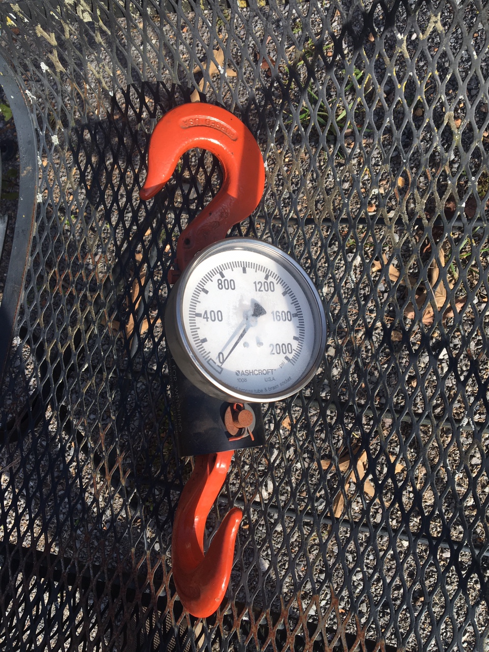

Weight scale.
Working, stacking, grubbing etc. If you install a real-time gauge needs to be a least a 5,000#. I’m using a 10,000#.
The M59 engine strains a little when lowering a load. This feature helps control heavy lifts. It also can give high lift pressures when the grapple is empty. Raise a little and goes to normal. Noticed after dumping load, dropping the grapple to travel would have as high as 2000psi.
Made a 3pt concrete and steel counter weight back in 1981 to help the MF135 with a trip bucket loader. Used a weigh scale to weigh it 980#.
Chained to the back of grapple, scale to counter weight. Lifted till chain lined up with lower loader bucket pivot pins. 1232psi.
1232 - 630 Grapple tare = 602psi
980#/602psi = 1.63#/psi
Or maybe rule of thumb 1000# for every ~600psi? Seems a little high so got to due some more thinking.
