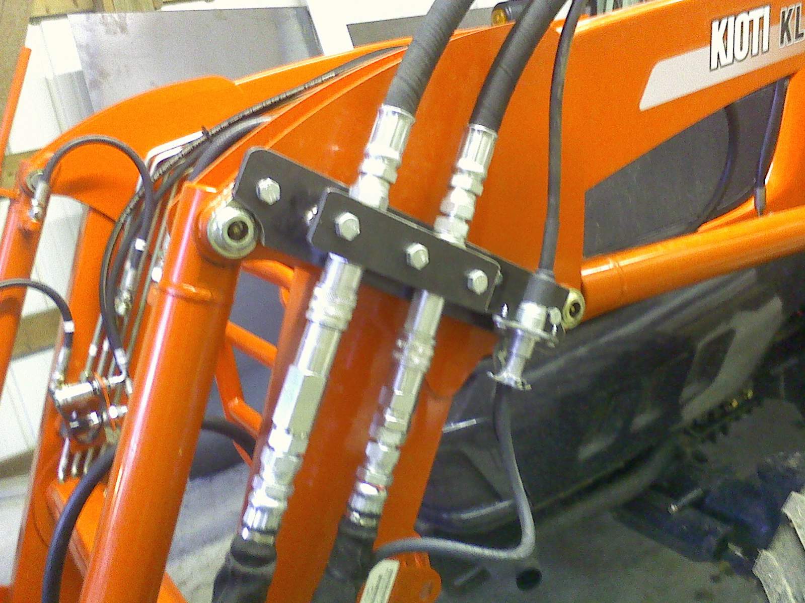

The reason of the high price is that you have to buy a hydraulic system to drive it. You will have a tank and pump which will go on the three point to power it and store the fluid.
There will be hoses that will run to the front from the rear that will go under neath the tractor to the loader frame.

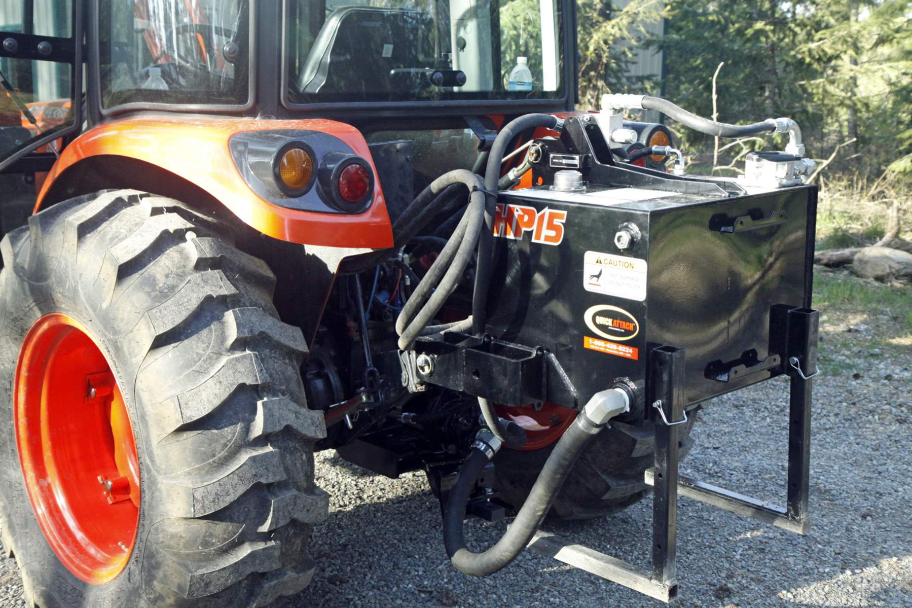

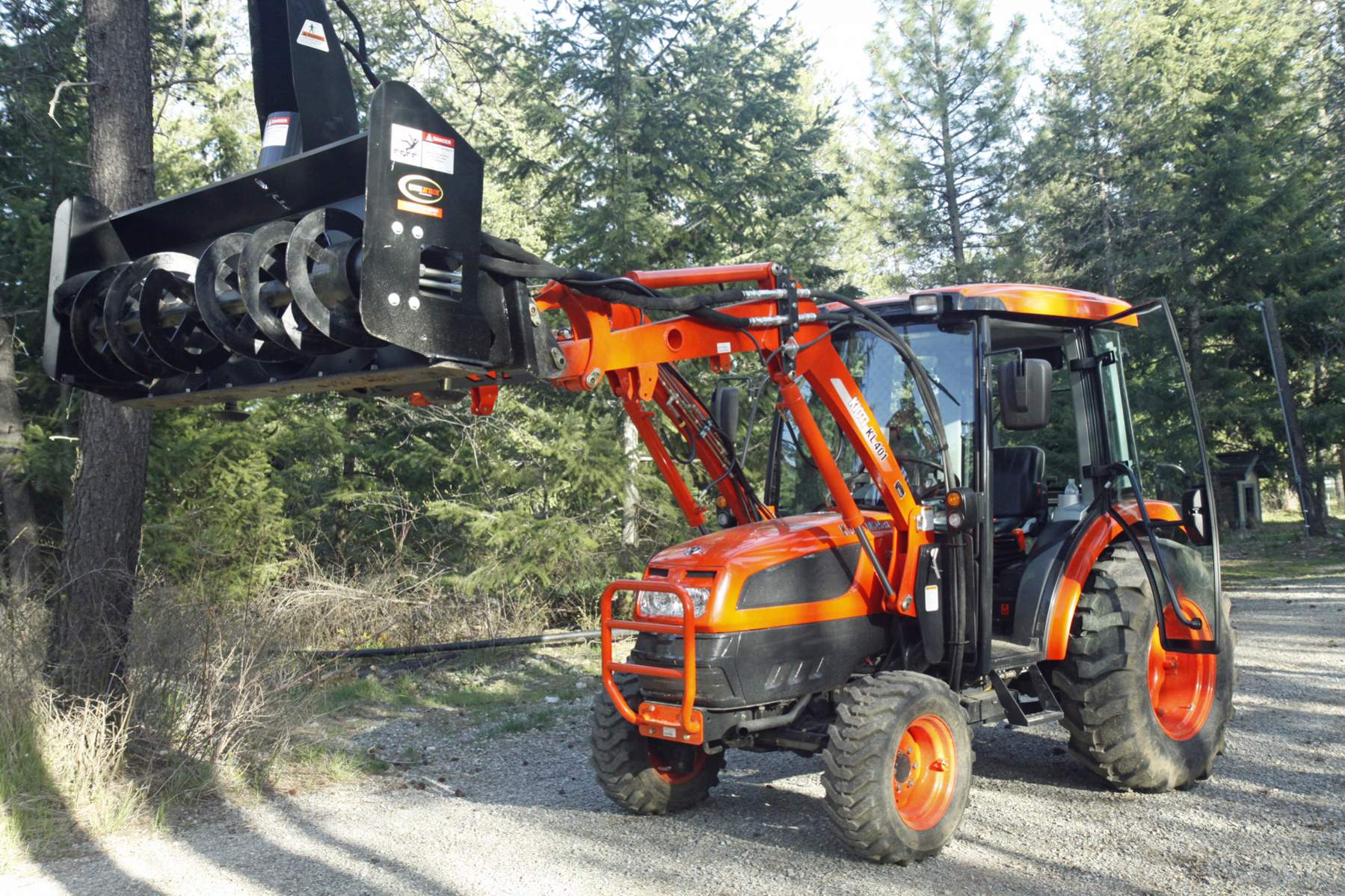

Mine has an exterior tank that mounts on the 3 point hitch, holds 25 gal of hydraulic fluid and runs at 3,000 psi and 15 GPM.
I paid about $10,000 for my setup. Then again, with a 45 HP tractor, i was getting estimates in the 5-6,000 range for a USA made HEAVY duty rear drive snowblower. I'm not talking about the cheaper ones like my old farm king.
The new loader mounted blower is 79" wide and composed of 3/16 and 1/4" plate steel. Its made like a tank.
All the flighting is braced and cross braced. This thing will last many years. The problem with running a cheap lightweight snowblower on the larger HP tractors is the blower gets damaged. Even my old 28 HP tractor damaged by old farm king blower. I had it in the weld shop 3 times over the years. Mostly due to flighting issues. It was just too thin. always bent.
I guess yo get what you pay for.
We get at minimum 3 month and as much as 5 months of snow here. Average 120" per season. I have been driving backwoods since 1996...and i have had enough with that. We have had as much as 36" of snow overnight before. Luckly we average 4-6" per storm. I also have a loader mounted snowblade for the lighter snows and early seadon snows.
Well see how well this loader mounted unit works, but i don't gpm any issues as i have an HST tractor, so i can adjust my speeds as necessary.
