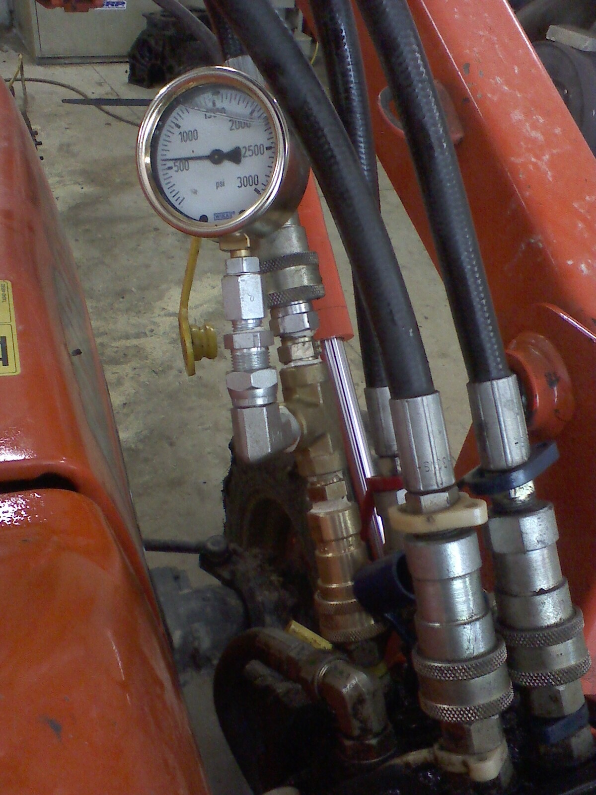

Just thought I'd share a pic of the pressure guage I put on my FEL.
Hooked up with it's own quick couplers, so I can put it on any of the four curcuits anytime I need to diagnose something.
I like leaving it on the loader lift circuit because (with a little figuring) gives me a good ballpark Idea of how much weight I have in the loader:thumbsup:
Enjoy

Looks like a good idea- but I was told you couldn't "T" in as you did? I always wondered how much weight I had in the bucket.
   / Loader pressure guage
Do you remember any reasons why you were told not to tee in??
