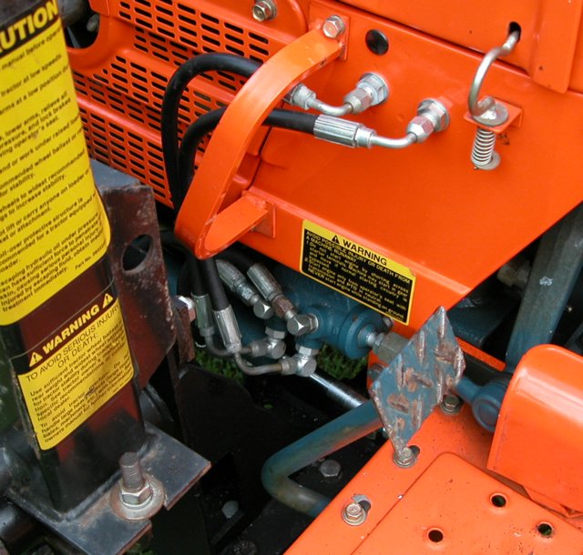

   / loader problem found #10
Who knew to check loader mounting bolts?? When I added power steering to my B8200 Kubota, I had to modify (i.e., cut out some metal) the loader frame at the rear. The loader is a Bush Hog universal model. In order to make sure I didn't loose any strength, I installed a bracing tube under the tractor to tie the two rear mounts together and support the area where I had trimmed... used grade 8 bolts, oversized at that, and painted everything when I was done. I figured the extra weight, down low, wouldn't hurt anything, either. So far, no problems. But I will check tightness of everything I can access, just in case. If you look closely at the foto, you can see where I trimmed away steel on the original bracket, for clearance of the steering cylinder, and the new tube/ bolt heads below.
