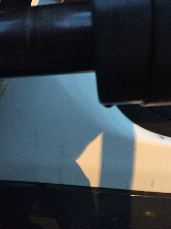

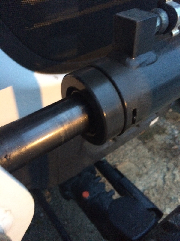

have any of yall had to replace the o rings for a leaky hydraulic loader ram? I have one that seems to have small leak. just wondering if they have kit for it because I didn't see it in t he online parts diagram.
   / loader rams
#2
Here are some pic

Sorry different post been having problems with app since iOS 8

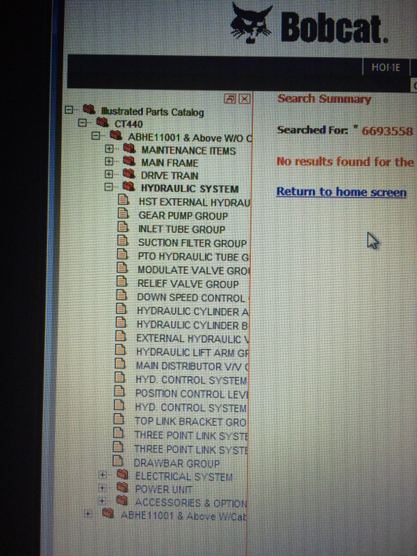

Ssdoxie. I don't see that. I put in that part number under search and it didn't find it. Here is what I see.
   / loader rams
Is that part number for ct440? Forgot to mention that
   / loader rams #7
I didn't pay close enough attention to the model, that part number is for a 7TL on CT2xx models with Rhino loader. To find it in online catalog: Scroll down through the model selection to find "Loader", click on that then it will bring up a little box on the left column for "compact tractor", from there go down until you find bucket and lift cylinder for (in your case) 9TL with the correct 1st 4 digit serial number.
The picture you posted is for a 9TL Rhino built loader serial number starts with AE35. Lift cylinder kit - 6693747 and tilt kit - 7003599.
