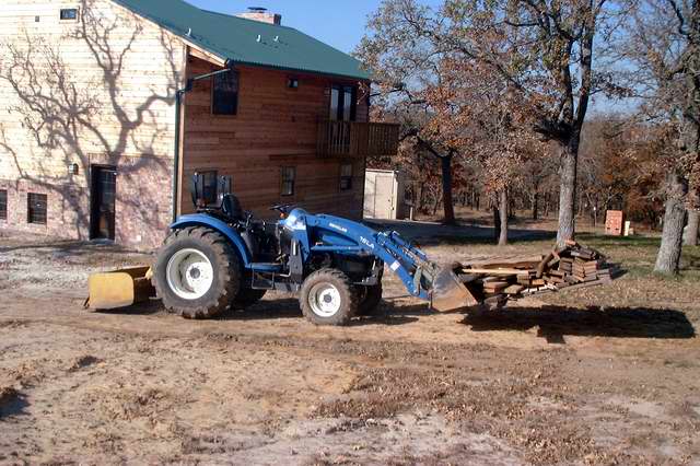

Mike, I don't mean to be putting words into Mike10's mouth, but if you lift a heavy pallet, you can't help but have half the load much farther away from the pivots than the standard bucket. Isn't a standard pallet at least 3-1/2' wide? I have chain-on forks for my bucket, so I'm really at a disadvantage. I tried to lift a pallet with 25 bags of mortar mix and all I could do was scoot it across the ground. Just look at the attachment to see how far out my forks are in the attached photo. I have to be really careful not to end up on my blue nose. /forums/images/graemlins/blush.gif

I see your point. I have my heavy box blade on the back and just figured that I could get my rear tires loose before I actually maxed out the lift capacity. Guess that just means I got enough weight in my tail.
