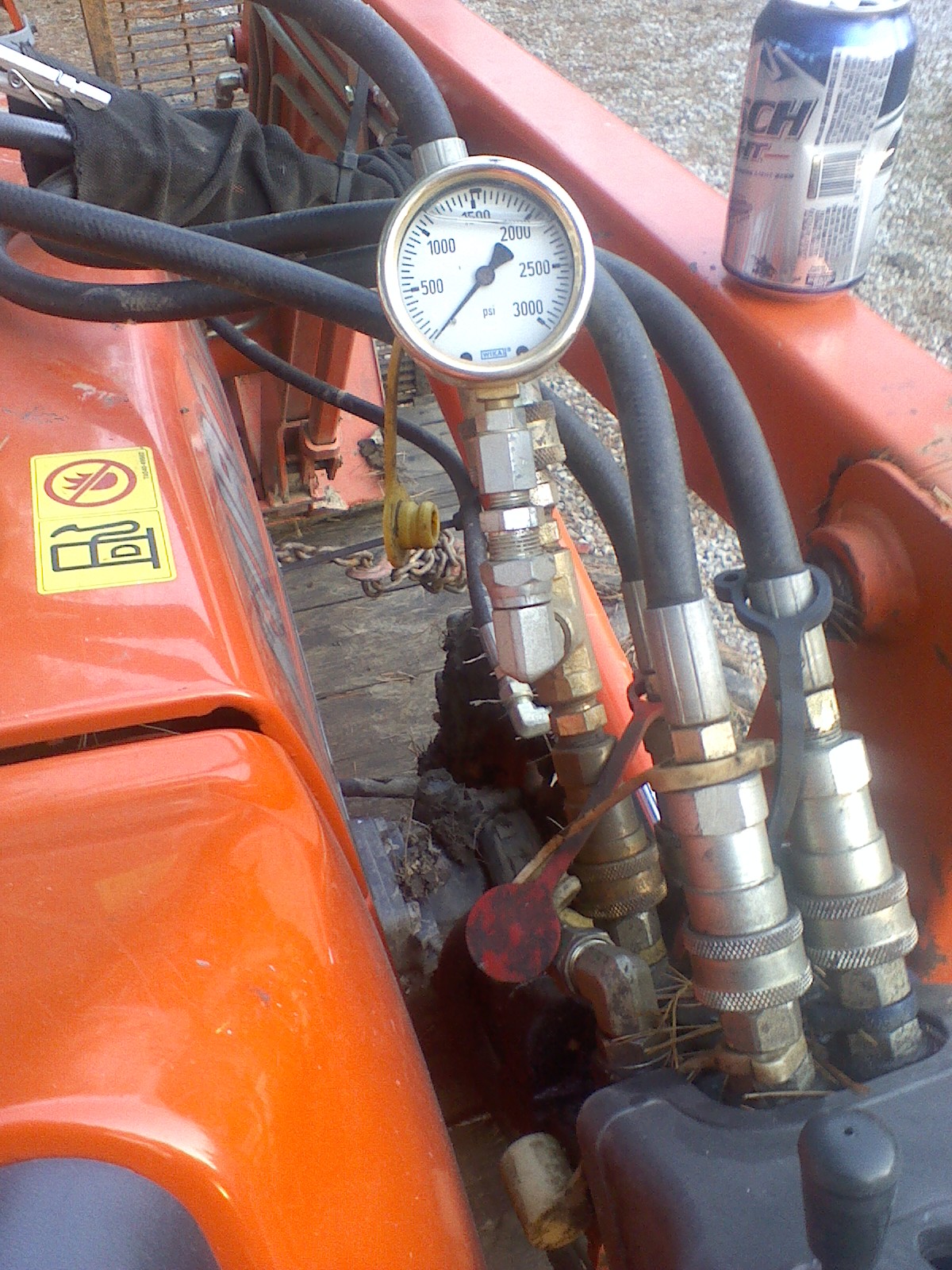

Ar you guys just making a JIC adapter to gauge and hooking up to a JIC connector?

I just plugged a gauge into my rear remotes.

You can use a hyd gauge in several ways.
You can build a hyd tester and plug into the valve work ports you wish to check or install a hyd gauge in the IN port of the first valve and use it to monitor and troubleshoot the hyd system.
Tractor normally comes from the factory with one relief at the 3pt area, or hyd block, and they publish a setting for that relief valve.
After attachments are added such as a loader, the loader valve normally comes with it's own relief valve.
Since the loader valve is now first in line, it is set to the tractor relief setting.
If you do the plug in work port hyd gauge setup, you are only checking the relief valve for that valves work ports.
If you install the hyd gauge in the IN port of the first valve, the hyd gauge will read any pressure developed by any hyd component on the tractor.
Logically, you would set all the relief valves the same.
In an open center hyd system, you would consider the first relief valve in the series flow path the main relief.
Relief valves are usually set with about 10 GPM pump flow.
Some relief valves are set using adjustable relief valves, and others by using the correct shim to correct the pressure.
The lowest relief valve setting upstream will set the limiting pressure. Set the first relief valve first.
