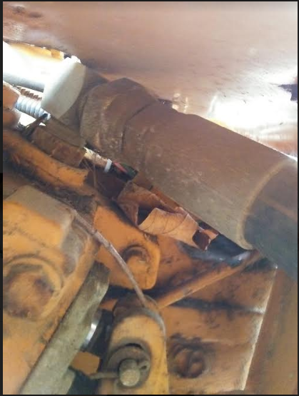

I just looked at it, the return looks like it dumps right into the rear axle, it doesnt go to any valve block (like my rear aux does, because they have reversable flow).

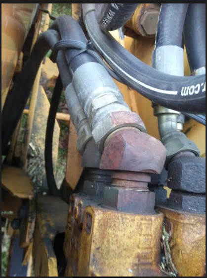

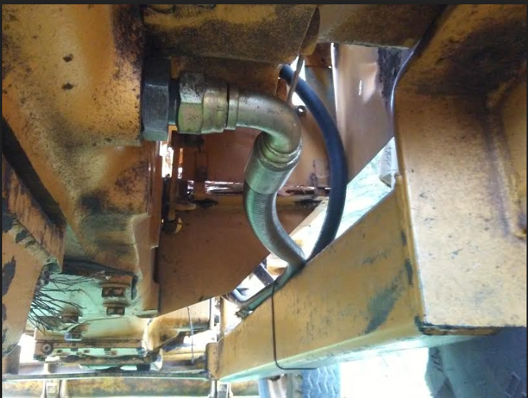

Tractor data has it as an open center system. Put male-female couplers (1 set ea side) on the 4 ends that connect the loader valve to the tractor. If there are hoses at the tractor side, simply connect them together. If they are ridged mount, get a hose made and connect the tractor ends together. You need a loop so that the fluid can constantly flow. ;)

Thanks MtnView, figuring out the couplers and hoses wont be a problem. Essentially your saying to plumb the supply back into the return when the loader is off, right? Ok, lets say I do that and it turns out we're wrong about being open center, will it hurt anything? I wish there was a way for me to confirm that its open center
The 1st pic below is the supply & return at the loader valve, 2nd is the supply coming out of the tractor's system, and 3rd pic is the return below the axle

Ditto if supply & return hoses for FEL control valve aren't looped together on open center hyd system when loader is removed hyd pump could be damaged when engine is started

If the return line goes into the transmission case, it's power beyond.
