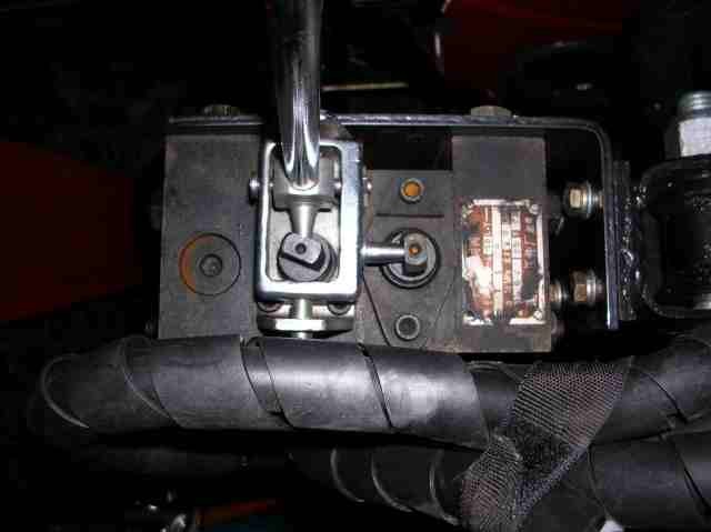

What loader and valve do you have? Most joysticks have a rubber boot covering the linkages that actuate the valves. Have you removed this boot to examine the mechanism? You may be able to limit the linkage travel and control how much the lever moves the spool valve when lowering.

I have the factory jinma loader that has a single joystick. Interesting you mentioned the rubber boot, as my loader never came with one.
I looked at the joystick valve but am not sure what to adjust. There is the linkages attached to each spool on the valve body but I think this may only adjust travel and not speed, but I have probably overlooked something.

Remember. .. if the spool uses linkage/valve travel to open orifices.. then if you limit the travel to limit max orifice opening.. then you have limited speed. I've never seen that perticular valve and am unsue if you can limit 'exhaust' without limiting 'extend'

I will need to look at the assembly closer to see if the stick movement can be reduced then the valve piston will also move less resulting in slower loader drop. Seems like it should work as long as the linkage will allow this adjustment. I was hoping there was an easy way to reduce total flow through the spool controlling the drop.
I will check it out and let you know.

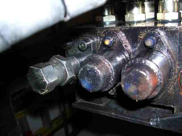

There is a linkage from the joystick to each spool plunger, but there is no adjustment to limit its travel.
I will take a picture of the assembly and post it for suggestions.
