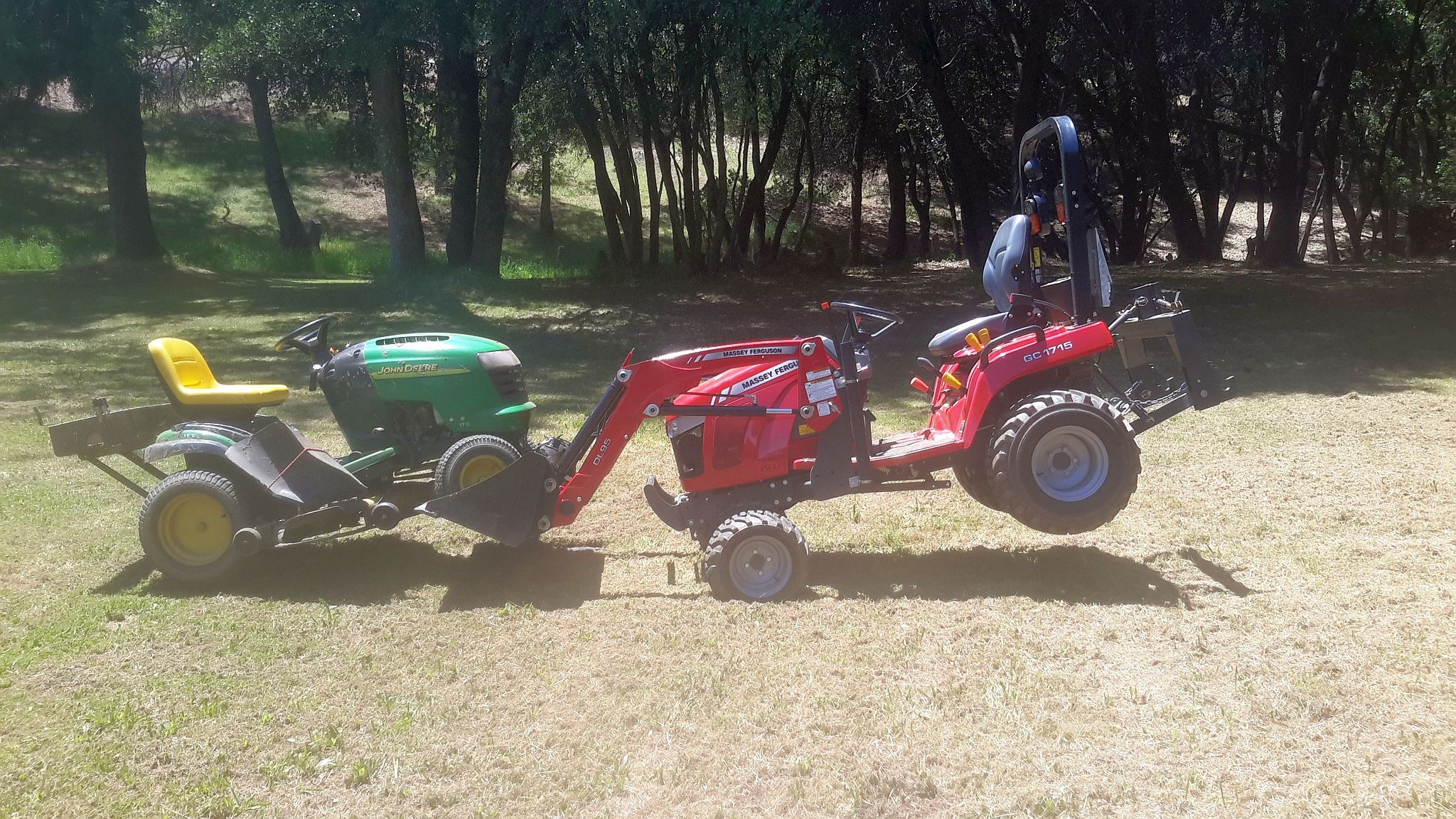

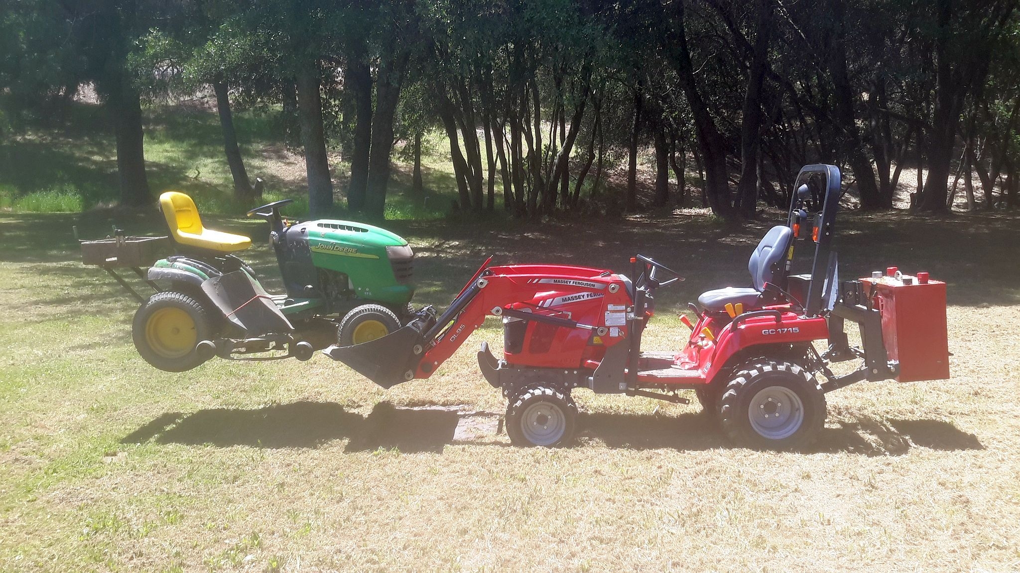

Keep in mind the further out the "weight" is in from FEL the more it effects the stability of tractor.... Its sort of Archimedes principle of "give me a lever and fulcrum and I can move the world".... The front axle is the fulcrum. The weight in FEL can be the lever or the ballast weight on rear can be the lever....
IN the case above the JD mower is 520 pounds, the ballast weight in second image somewhere between 500-600 pound's

   / loader to counter weight calculator #10
I'm very confused by this picture. How is that lawn tractor not tipping backwards out of the bucket?
Red lawn tractor doesn't have enough counterbalance on it's rear to offset weight of front of green lawn tractor therefore red lawn tractors rear tires rise from ground. Counterweight in photo below makes up the difference.
