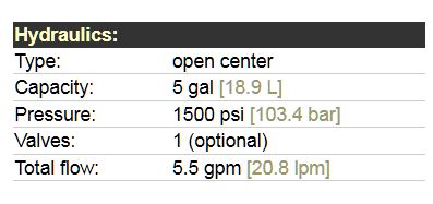

I'm looking to add loader controls to my 5254 tractor and use the on board hydraulic system. I have a 6' Myers plow I want to modify to fit the tractor and control with hydraulics. I also have intentions of building a loader come spring. Does anybody know what valve I'll need to use for the controls? I saw the oem one on eBay but will need a lot of small parts to complete it. I would like to buy the valve complete with joystick and make a bracket to fit in the spot the tractor has already. Thanks in advance for any help.
   / Loader valve for cub cadet 5254 #2
You can probably get a valve at Surplus Center but it needs to meet these spec's
