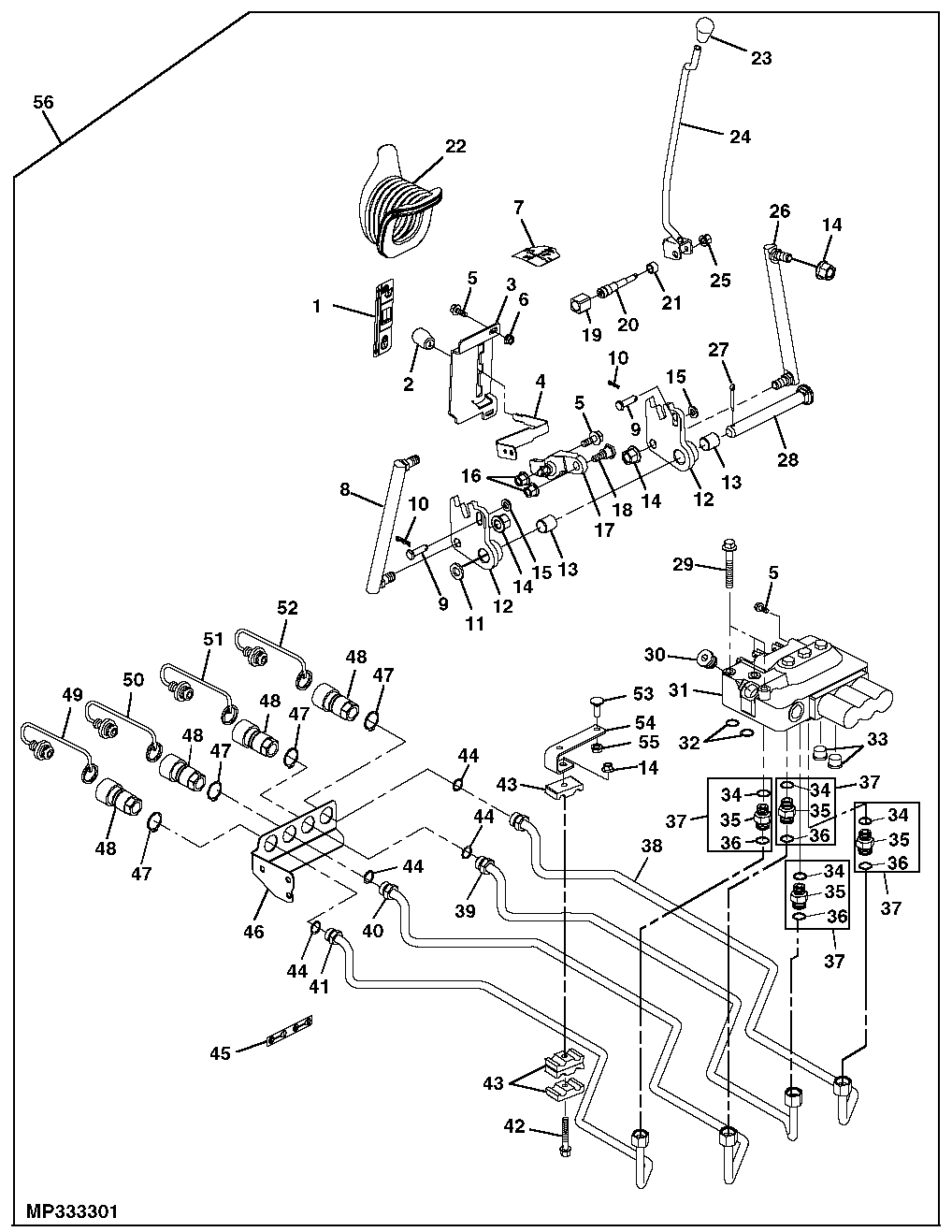

I have a 4410 with a 430 loader and recently the loader control lever has become "sticky" when using the bucket curl function. The lever does not naturally return to center during curling, but does on the up and down loader function.
What makes the lever return to center on the valve?
Is this problem hydraulic related or lubrication on the linkages?
What is the best way to access the linkages to lubricate them? Pulling the boot off the lever doesn't reveal very much!
   / Loader Valve (SCV) sticking on 4x10 #2
There are springs in the valve that center it (the spool). Most likely your problem is external linkages not being lubricated.
Below is a picture of all the parts, Fluid Film works great here.

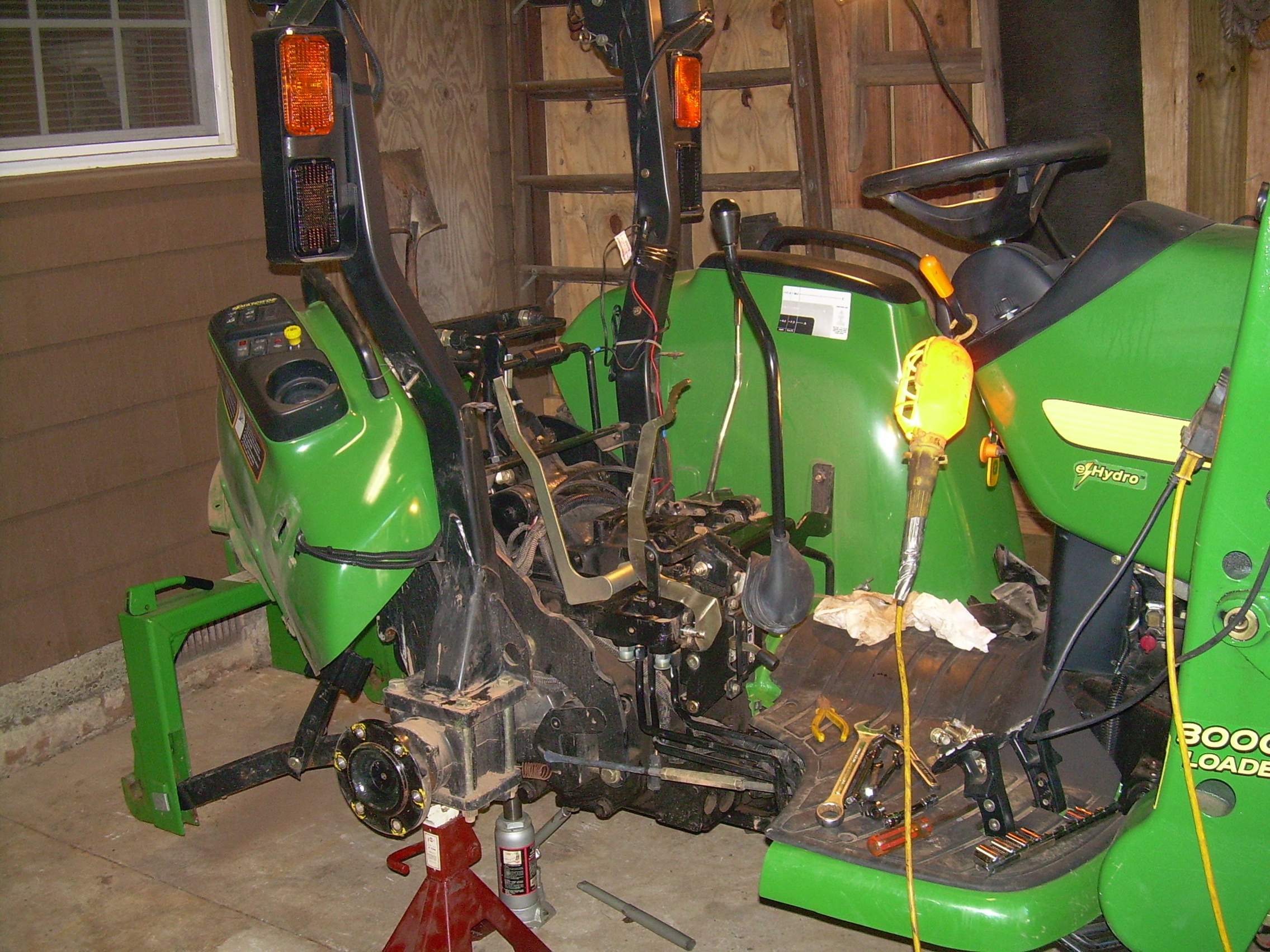

I would just spray the lube all around the moving parts from the top and bottom. Should probably do mine before it gets sticky.
If you have to get your hands in there you do have to remove fender and seat and wheel. The seat skirt is the worst part of that job.
I had to go thru all that to install the hard lines and lever for my 3rd SCV set up. It was well worth it though.
I saved that picture for the next time I'm feeling ambitious!
