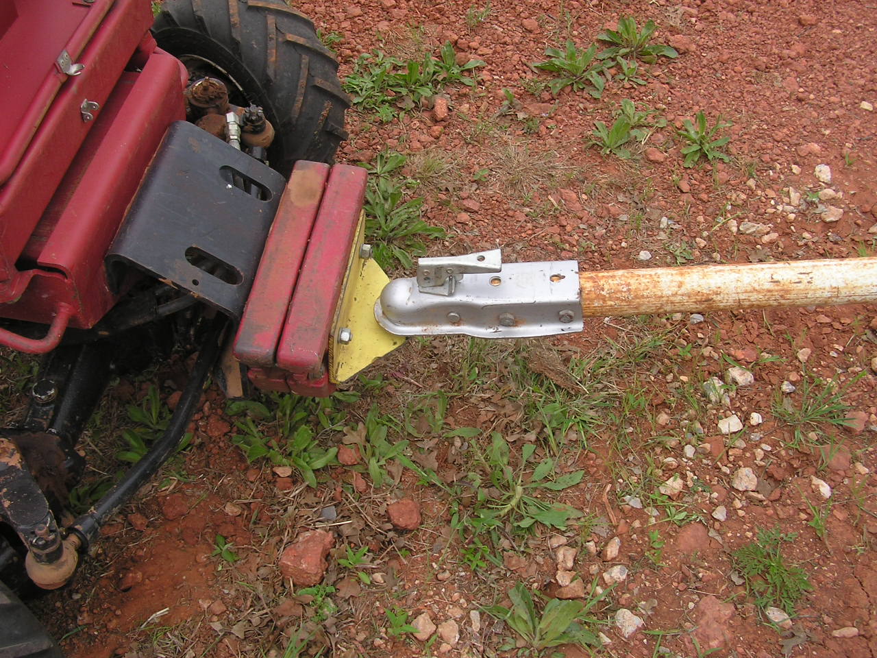

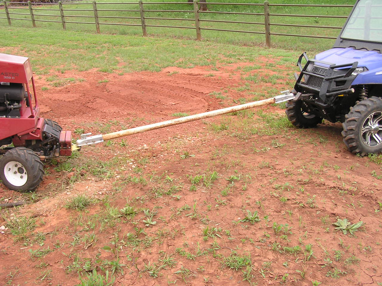

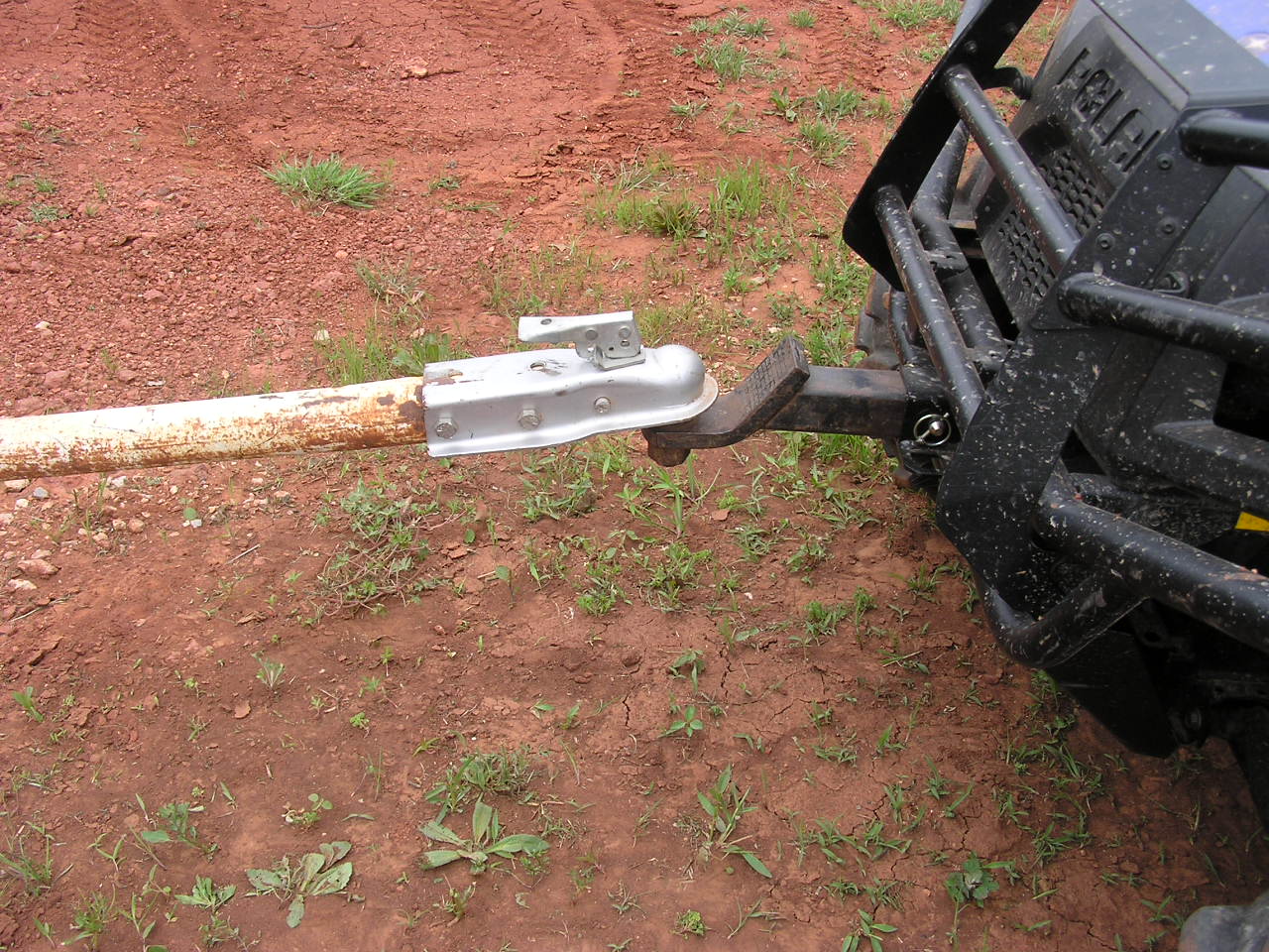

I made this push/pull pole from thin wall tubing many years ago when I had a tractor. Used it to push a Oliver OC3 crawler up onto a trailer.
Have used it a lot for trucks and tractors, don't have pictures of the big stuff, but here is how it works:
