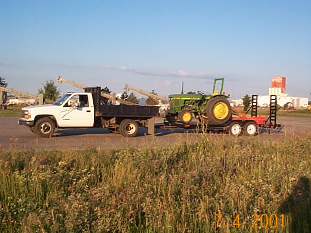

   / Loading tractor on trailer #9
Alan,
I load my B2710 backwards on my 16 ft. trailer when I have the FEL and bush hog on. If I hang the bush hog wheel over the front there is just enough room for the FEL, and the balance on the trailer is good. The other way I don't have enough weight on the front of the trailer. I guess all trailers are different. Attached is a photo of my old B8200 loaded on the trailer this way

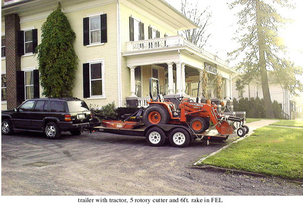

   / Loading tractor on trailer #10
I load both the 1050 and the 955 on a 16' t/a trailer forward. It easier to load this way, and obtains proper weight distrubution on the trailer. For those of you loading backwards, don't forget to make sure your hood is securly latched. I saw someone a few years ago, the wind cought the hood of the tractor and almost ripped it right off.
