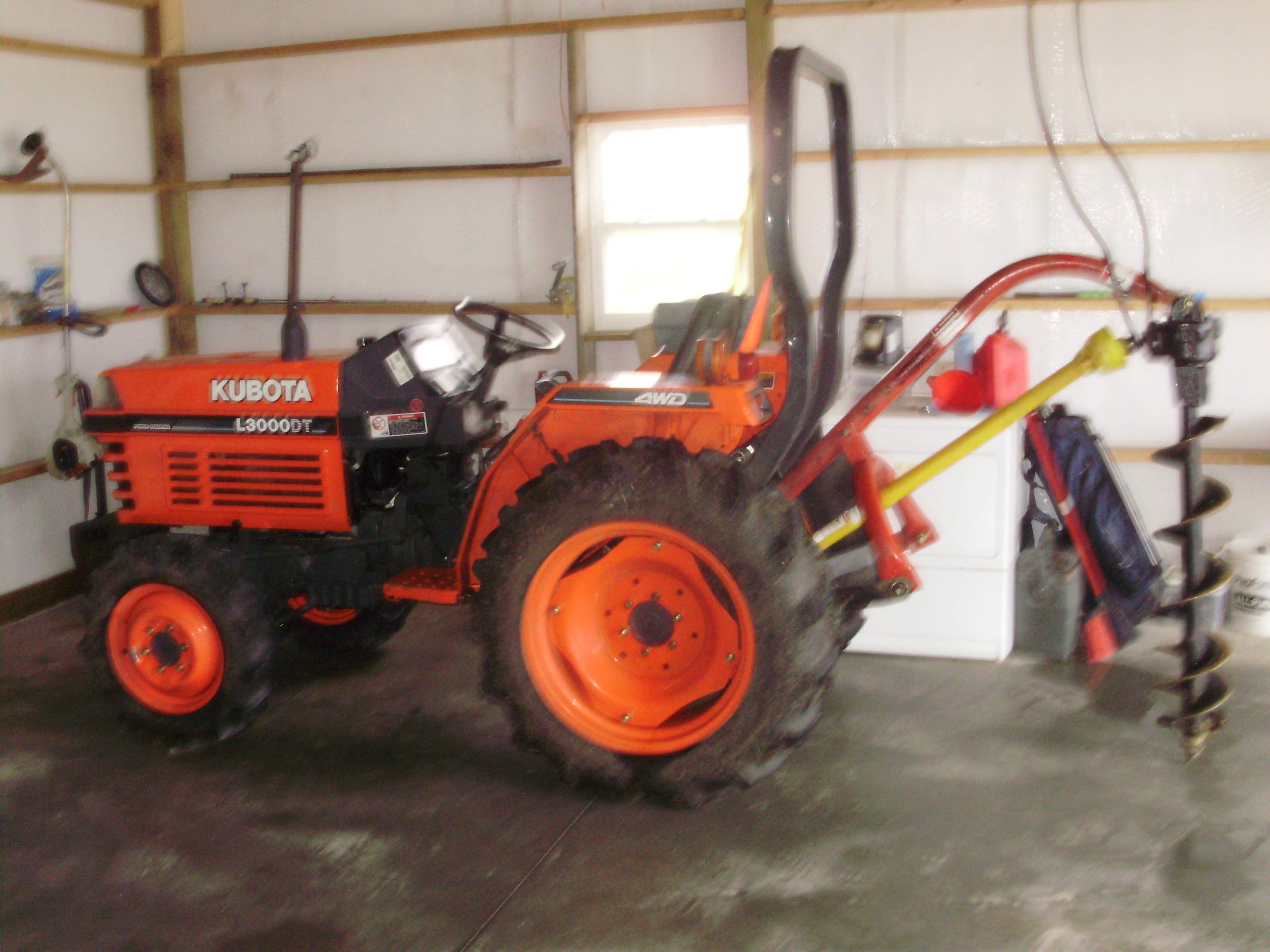

A friend wanted to borrow my Kubota L3000DT to put in some fencing so I loaned it to him. He just called and told me the brakes are not working well. He thinks maybe the park brake was left on when he was driving it. My question to you all...[ is how hard is it to repair the brakes on this tractor and how much will it cost me to get it fixed? I don't know how this could happen when the park brake was on you could tell it would really bog down the tractor. Looking for any advise other then not loaning my tractor to him again.

There should be an adjustment for each brake. Check in your manual under the maintenance section for a procedure to adjust the brakes.

Not owning one, but thinking they are wet internal brake. It can somewhat labor intensive to change them out. It is a paper like lining glued to a disc. I have seen the lining come off the disc before from driving with the parking brake on for long periods. If it gets peeled off the disc it turns into 2 sheer pieces of steel with a film of oil between them and you have no stopping power.

It sounds like that may have happened, he was not real sure. He had a Amish friend drive it while he guided him.

I can see why you say that but I knew he would have to get his brother or a friend to drive it. My friend is on Social Security disability because of severe neck problems. He can't turn his head around to look while sitting on the tractor where he was drilling the post hole. So that is why he had some one else drive it.
   / Loaned my kubota L3000 DT to a friend and now the brakes don't work #10
being a good guy sometimes comes at a price seems hard to believe that it could have been driven all day with the parking break on
