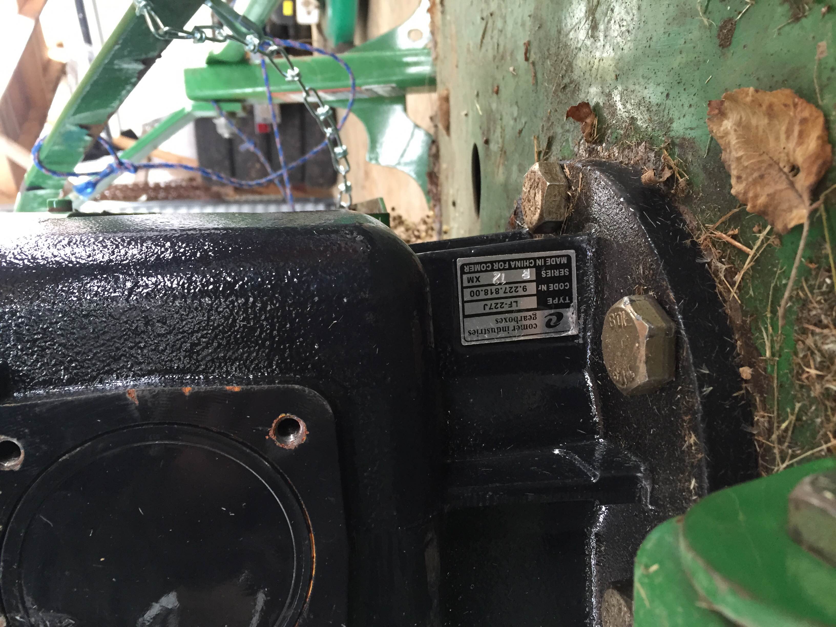

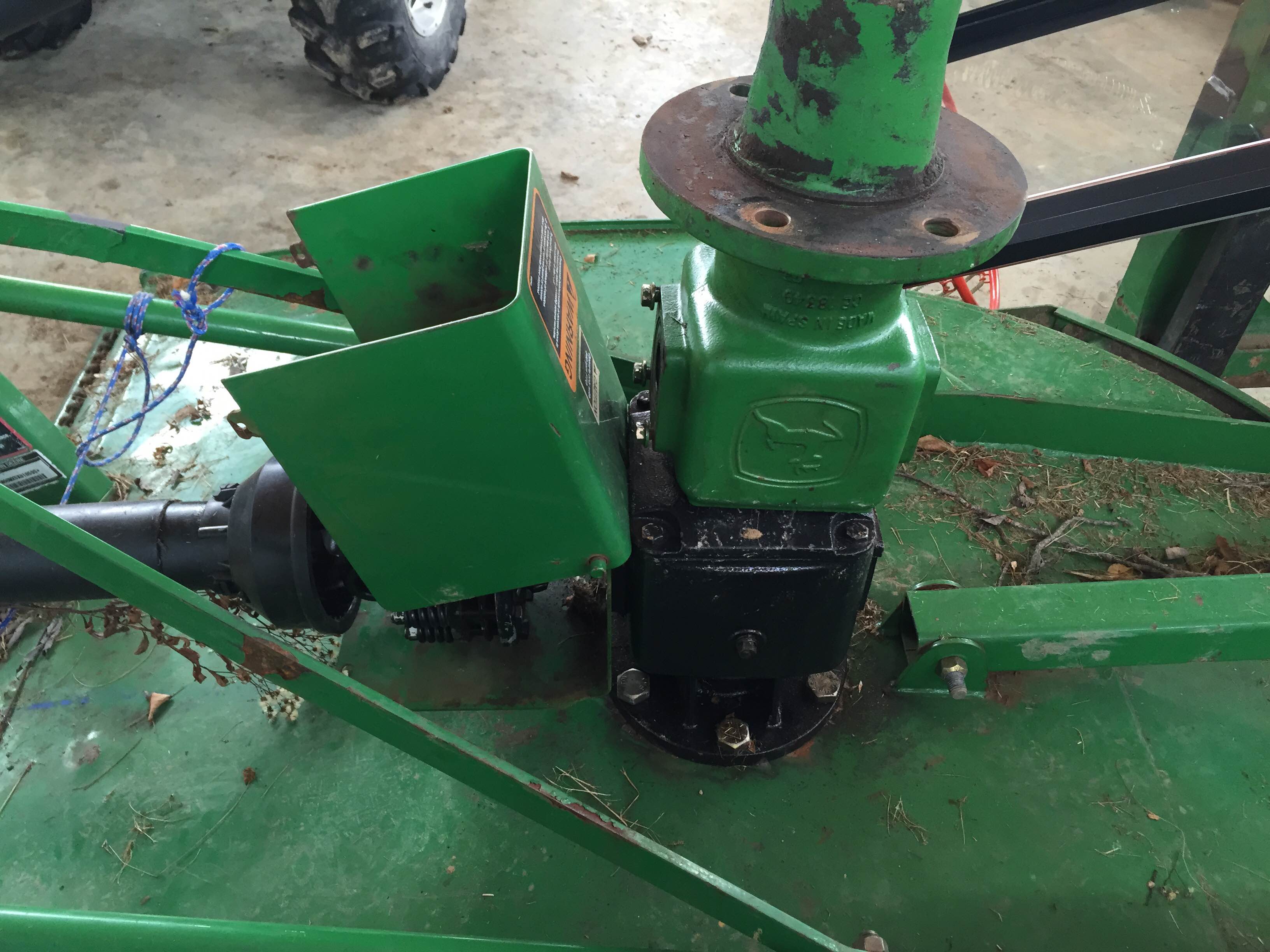

I'd been mowing trails with my MX 5 and was transporting it back to mow my lawn. Driving over an area I didn't intend to mow without any unusual noises the tractor stalled. I disengaged the pto and restarted the tractor and attempted to re-engage the PTO. The blades didn't spin up and there was a hint of smell like the clutch was hot. The gearbox was quite warm to the touch. The gearbox fluid level checked and smelled OK. I looked underneath but didn't see anything that might be jamming it up.
Thoughts?
   / Locked up MX 5 #2
Can the blades/pto shaft turn when disconnected from the tractor? Can you tie it up against a tree so you have access to the gearbox and underside? Usually when the MX's self-destruct the whole stump jumper and lower shaft assembly drop out the bottom. Every failure bemoaned on here happens when the output shears at the sharp snap ring radius just above your attaching bolt. I have not heard the later castle nut designs failing. Sounds like something broke loose. Get a good look and see if it turns. If not, drain the gearbox into a bucket so you can see what comes out, then have a look.
Comer made those gearboxes--either in Spain or China.
This was the same casting for the bottom of the gearbox, with larger input and output diameters. I never disassembled it to see whether they radiused the snap ring groove--I hope the extra steel will hold up better.

At full lift, I disconnected the shaft from the tractor's PTO and was unable to spin the assembly but that doesn't surprise me. The stump jumper and blades are still attached to the rest of the assembly. Driving to work today, I tried calculating the hours on the unit and it may be under 20 hours - I just don't use it that much - but I've had it for years and wouldn't expect warranty coverage.

It sounds like he has a problem in the cutters gear box. Not the tractor or slip clutch. He disconnected the PTO shaft and it will not spin. Sounds like a new gearbox is in order or something else. Do you check the oil level at least yearly, seals can let go and leak out and you might not know and cause major problems.

It's at the dealer service department. Initial inspection was the clutch didn't seem damaged and everything under the deck seems normal with no signs of damage or leakage.

It was the gearbox. waranteed.
