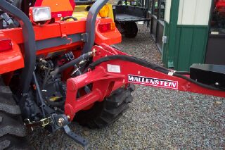

Mike How about something like this, of coarse you will ne rear remotes.
The price is around $1,500-1,700

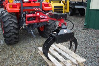

   / Log skidding #11
another picture
