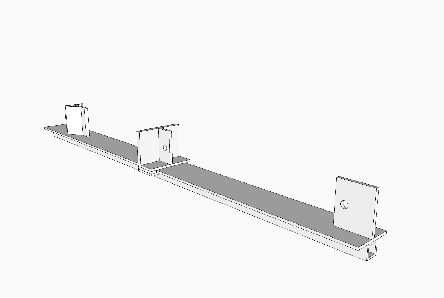

I'm going to build a log splitter and I was hoping to use some metal I have around the yard.
Rather than buying an I-Beam, I am considering building one out of 3/8" x 6" plate over a piece of 2"x2" 1/4" wall structural tubing.
Would this be strong enough for a cylinder with a 24" push of 14 tons?

No. Not by a long shot.
   / Log Splitter Beam Question #3
Have to say X10 on that. Minimum of 3/8 I beam for that 14ton. The beam is the major strength of the splitter. 7/16 or half would be even better. Might want to put a larger cyl or engine later on. If you had a 1/4X2X6 tube under that 6inch plate that would work for torsion, but still that plate would get bent up I would think.
   / Log Splitter Beam Question #4
2x2 would fail with 10 tons.
On the one I built, I used 6x6" H beam that is 5/16" thick with a 4" bore 16 gal/min pump and 8hp engine. No problems out of it after years of use. Might be able to get by with lighter material if you made it like a truss and just used a heavy bearing surface but that's a lot more work.

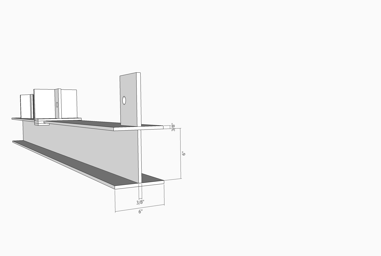

Would this beam work?
6" top, bottom, and middle. all 3/8" plate

Yes. My 18Ton is on a 6" beam with 4"Wx 0.40Thick" flanges/rails. An I beam is rather fragile in torsion and those forces develop inevitably when splitting and can finally crack the rails. To correct this I split a 3" pipe and welded it back together on the web of the beam. That was~35yrs ago. It has been trouble free.
larry
   / Log Splitter Beam Question #7

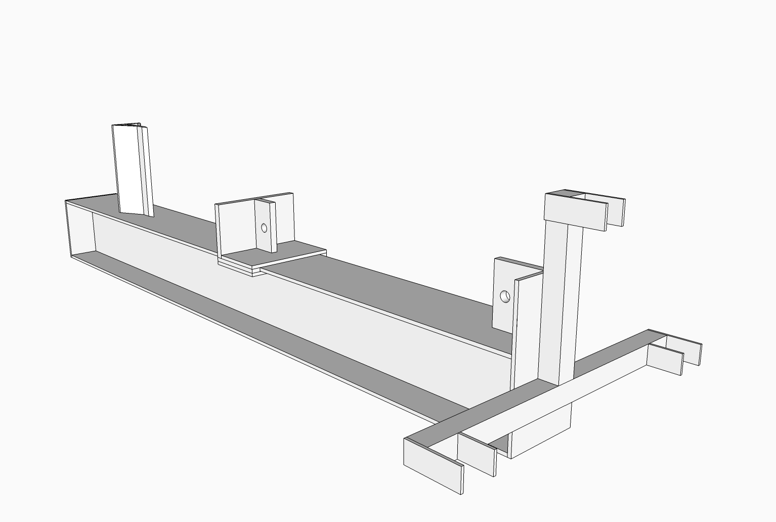

You may want to enclose the end of the beam with some 1/2" plate. I tweaked mine pretty bad when it was open ended and had to heat it and beat it to get it back in shape. Good Luck.
   / Log Splitter Beam Question #8
Yes the 6x6x3/8 will work. I made the base of mine on the end and the splitting wedge is the part that rides back and forth.
This allows you to use it horizontal or vertical. Vertical use allows you to split logs without lifting them off the ground.
   / Log Splitter Beam Question #9
I used square tubes on mine. It has worked quite well. 4X4X1/4 for the beam and a 5X5X3/8 slide. I put four blobs of bronze in the top and bottom insides of the slide and two blobs inside the sides of the slide. These blobs I ground to fit the outside of the beam for bearing surfaces which I keep greased. If I did anything different it would be to have used 3/8" tube for the beam too, though the 1/4" has worked out okay.
   / Log Splitter Beam Question #10
I like the square tube idea. I know a guy that used a 6"x6" 3/8 wall and the tube held his hydraulic fluid.
