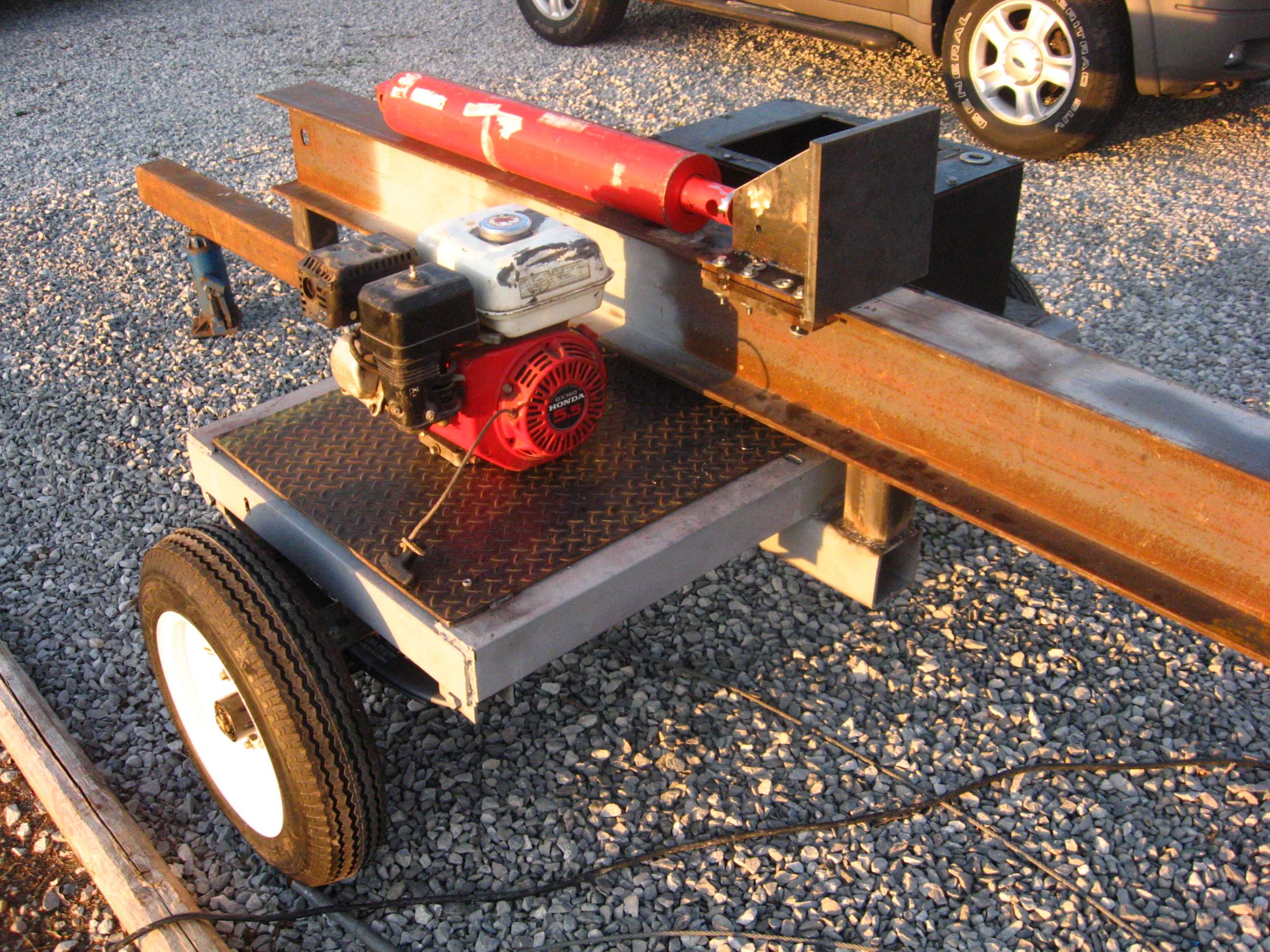

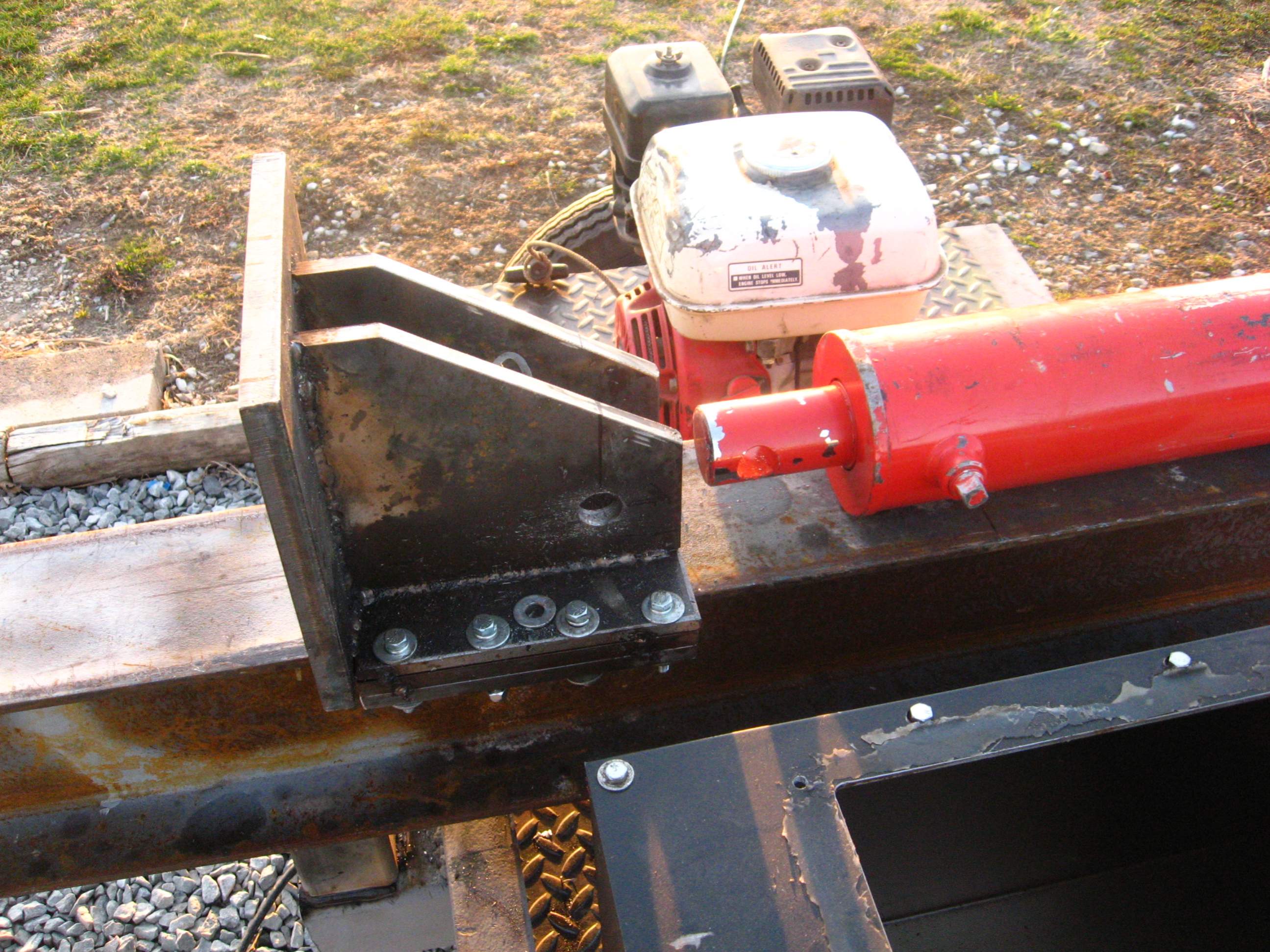

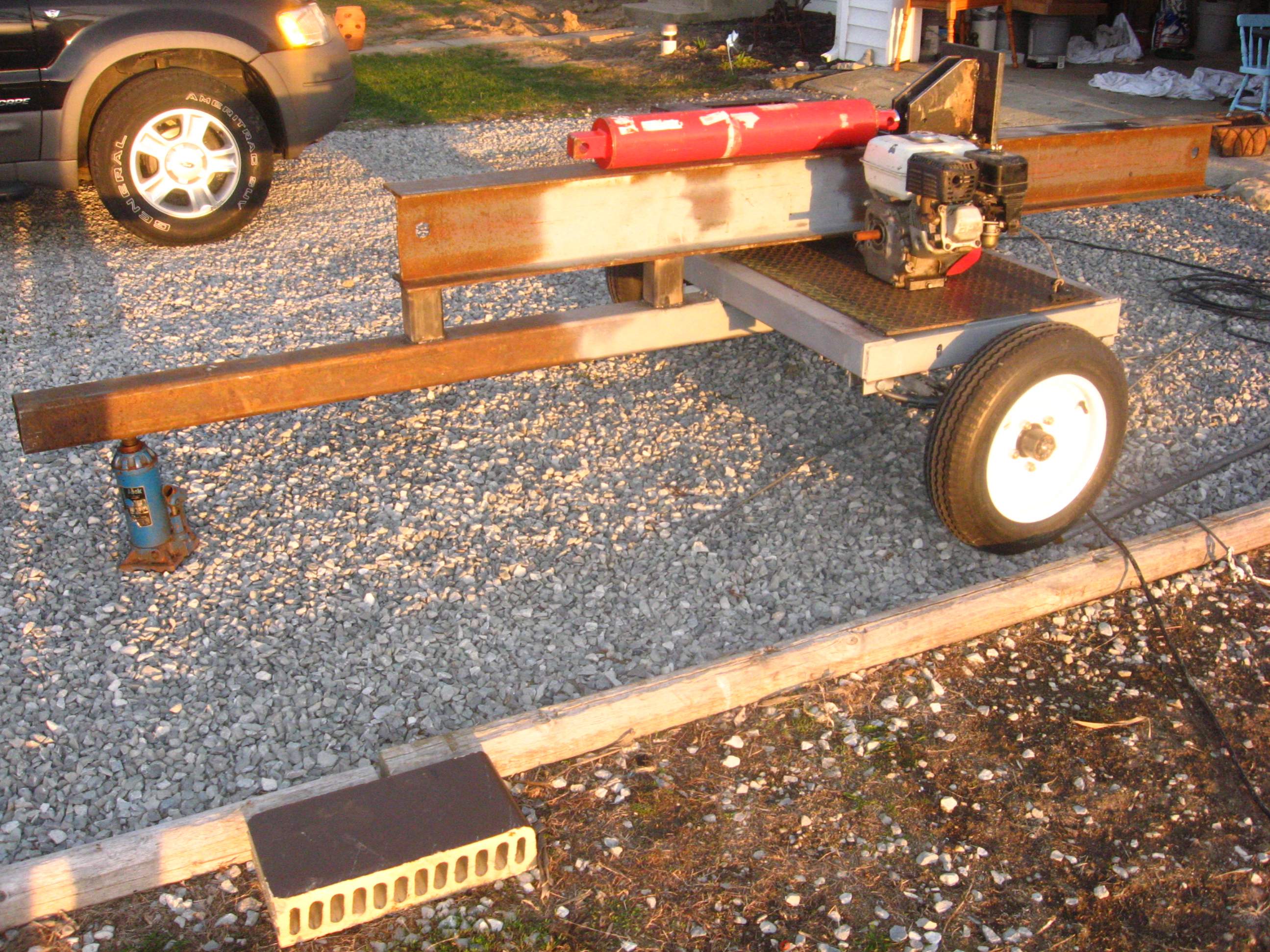

Hi there everyone. Hope everyone is safe and sound tonight. The lovely Ohio weather has me cooped up inside due to a tornado warning and funnel cloud spottings. Anyway, I've built the frame of my new log splitter and am in the process of 'ebaying' a Haldex Barnes 11GPM 2 stage pump. My questions are as follows:
1. Is it better to put a filiter on the suction side or return side?
2. What size inlet/outlet ports?
3. Should i buy an 'in tank' suction line strainer?
4. Is it a good idea to put a pressure gauge in the system?
5. If so, where?
Northern Tools website and my local Tractor Supply has filters on the return line. But I thought you wanted to protect the system before the dirt went thru. I was thinking of putting my 'in tank' strainer on the suction side, and the filter head on the return side.
Any pictures or detailed explanations are much appreciated.
I'll now try to add 3 pictures of my progress.
FYI-Anyone trying to bolt a pump mount onto a 5.5HP Honda GX160 engine should go to their local hardware store and buy 4 (four) M8 bolts that are one inch long. I dont know how the metric system works, but my Ace hardware had them in up in the bins. They were $0.09 cents each and 45 cents sure beats buying the 'kit' from Northern Tool for $4.00.

   / Log Splitter Hydraulic Filter, Gauge Questions #2
Tank screen is a good idea.
Placing the tank pickup (suction to pump) above the bottom of the tank also good idea as that way the pump suction cannot ingest sediment.
Filter would go on low pressure or suction (between pump and tank).
A 'breather' on tank with filtering to keep out bugs etc also good idea.
An inline filter on pressure side is rare and not pratical due to the high pressures.
Good luck!
   / Log Splitter Hydraulic Filter, Gauge Questions #3
Filter on the low pressure side prior to pump, on my backhoe I mounted it right off of the tank. Definately need breather on tank.
I ran 3/4 to the pump from the tank, 1/2 should work for all other.
I had a strainer in the tank where which the outlet hose then fitted into.
I ran a guage on my old back hoe, I mounted right off of the valve body, trying to remeber where exactly, I think there was a fitting on the valve body.
You could always T fit it on the hose going out of the valve body to the piston, you'll get pressure reading there.
Looks good,
Joel
