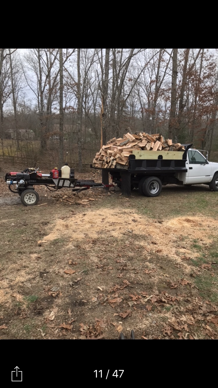

I added about 30” inches on my splitter tongue so I could keep it hooked to the truck and load the truck. I’m considering counter balancing the back because it’s too heavy to lift the front by myself. IMG_7070.JPG

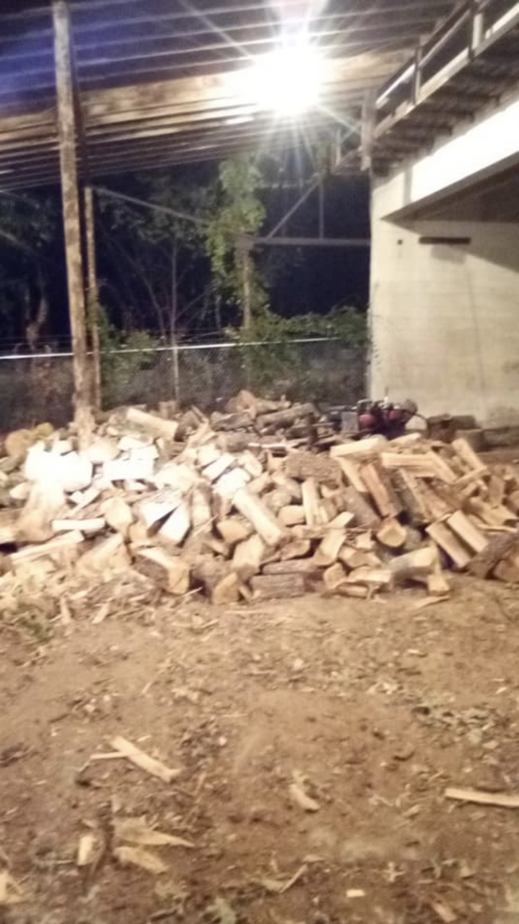

I don’t think the Honda puts off much if any available electric for powering a light. You might use a deep cycle battery that you take off to charge. Second option is a generator. I do most of my splitting under a cover and I put up four 300 watt light bulbs. IMG_7774.JPG
