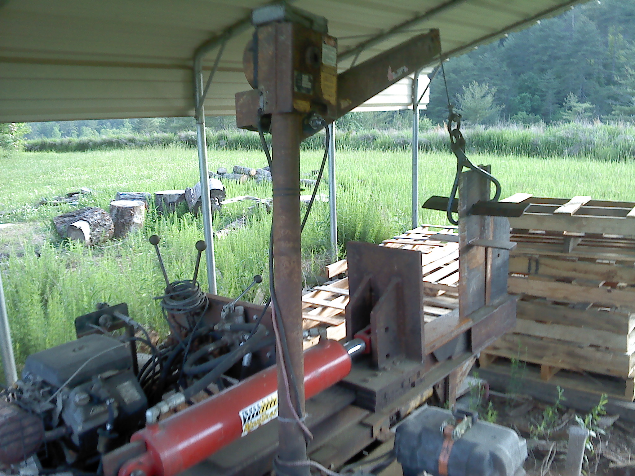

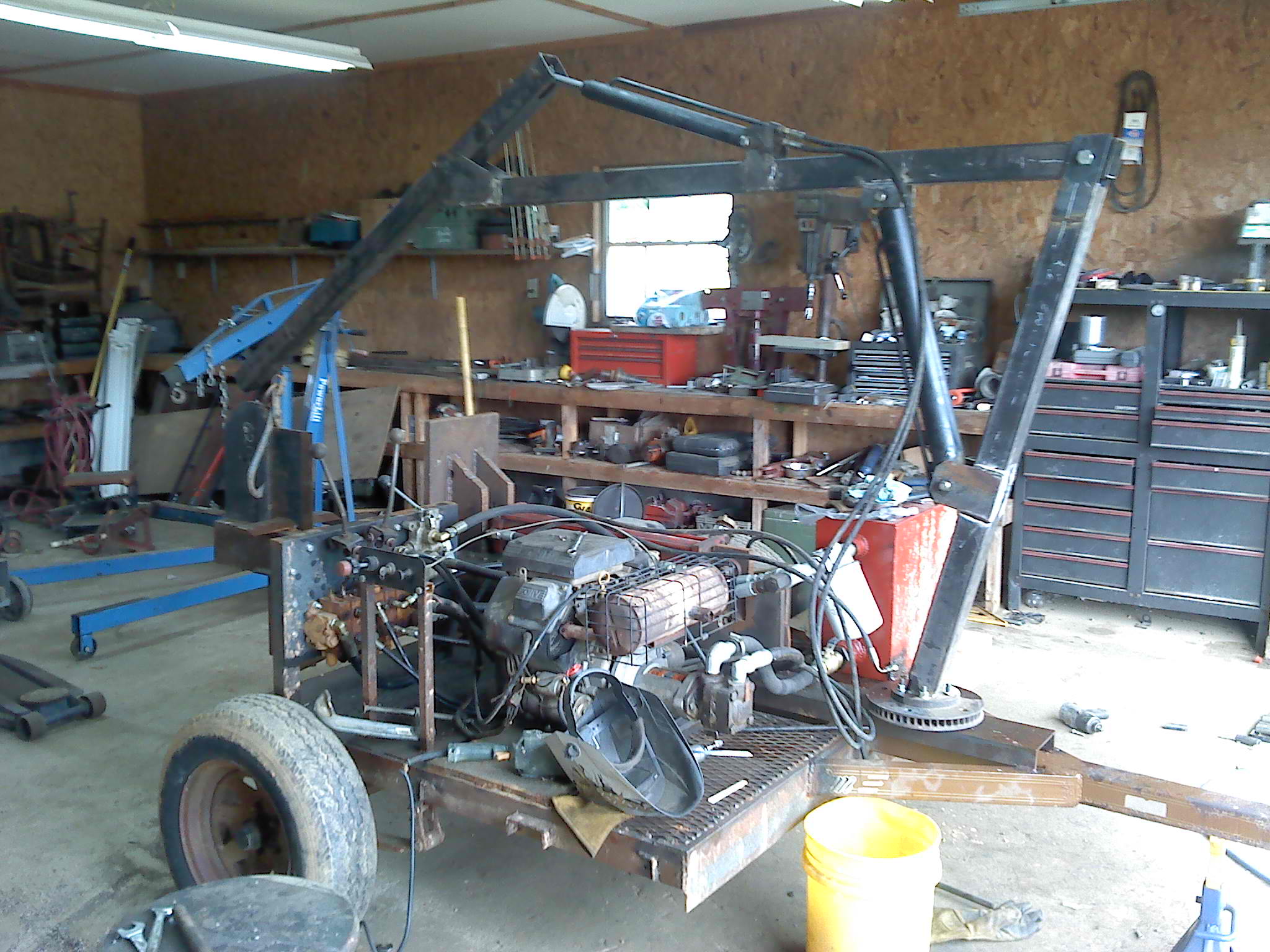

I put this on one splitter. mini knuckle boom 0610121308.jpg swapped it out for this 0517151915.jpg
   / Log splitter plans #10
Second setup is definitly the better of the two. While the knuckle boom worked "alright", , it just took to much effort to swing the boom, hook up the tongs, and put the log on the beam. The old mechanics boom does have a winch. I made a remote cord 20ft long, I can hook up a large round 20ft away from the splitter, drag it up and load on the beam without breaking a sweat. My only mistake with the second setup is the boom isnt mounted high enough. I can only lift a round of just under 48in dia because I didnt leave enough room between the boom and the beam.
