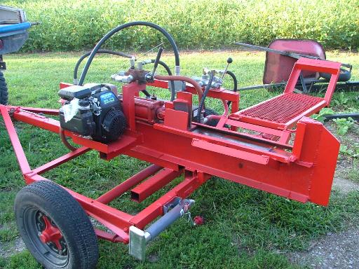

   / Log splitter plans... #8
The attachment shows what works the best for me in a splitter. You can stand up close, waist height, log lift that also gets used for logs to be split or the other half of big ones, 5hp honda engine, very easy on fuel and cost new about 200 bucks, 2 stage pump, 4x24 splitting ram, 3x12 log lift ram, and quite easy to tow.
I don't like the vertical models because you are always bending over, or on your knees to split the wood. If the pcs are that big, then the log lift will be used.
Junkman, you will have alot of fun building and using a homemade splitter, kinda makes you chuckle every time your able to split through those tough knots or twisted stringy pcs with something you made yourself. /forums/images/graemlins/grin.gif

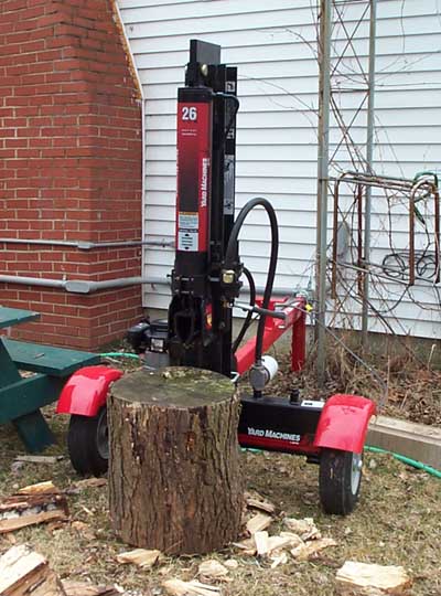

   / Log splitter plans... #10
My splitter swings down from horizontal to vertical, so I can use it either way. I suppose if you want the best idea it would be to have both. But I disagree with the others about this. I can use mine either way, but it is in vertical mode 99% of the time. I heat my house with wood (alone), so I split about 10 cords of wood each fall (it's almost time again). Most of the trees are 18 to 24" in diameter, and I just don't have the strength to lift up all those logs. So, I make a pile around the splitter, then stay on my knees for long bursts, I am not getting up and down. While on my knees I roll over a log, split it about 6 times, and throw each piece directly into the FEL of the Kubota which is parked right behind me. When the FEL is full, it's time to drive it over to the house and stack it.
