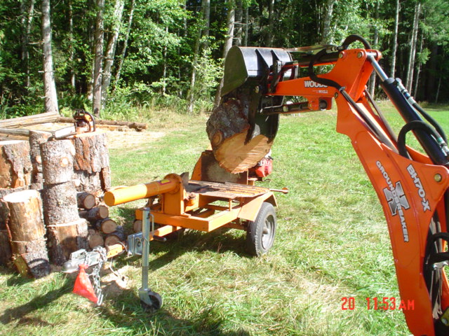

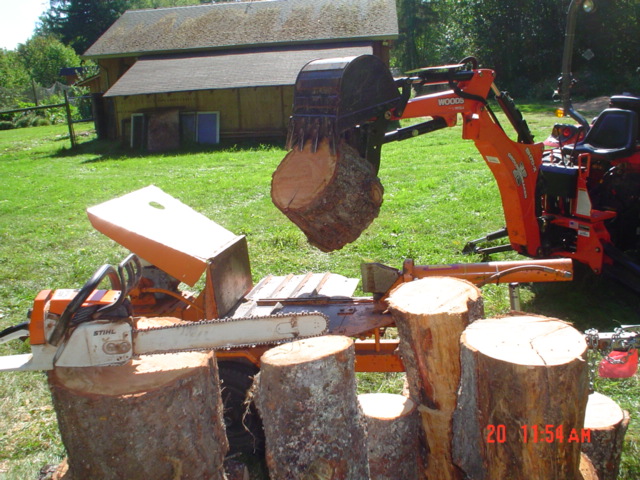

I am a big fan of warming up my splitter first it has a 12 Hp Honda on it. After the engine has run a few minutes I will cycle the ram. Seems to work fine for me. Although we don't get that many long cold spells here in the rainforest of Seattle.
And I give it a few minutes cool down period after splitting for a bit. Just the same as when I am out using my chainsaws.
