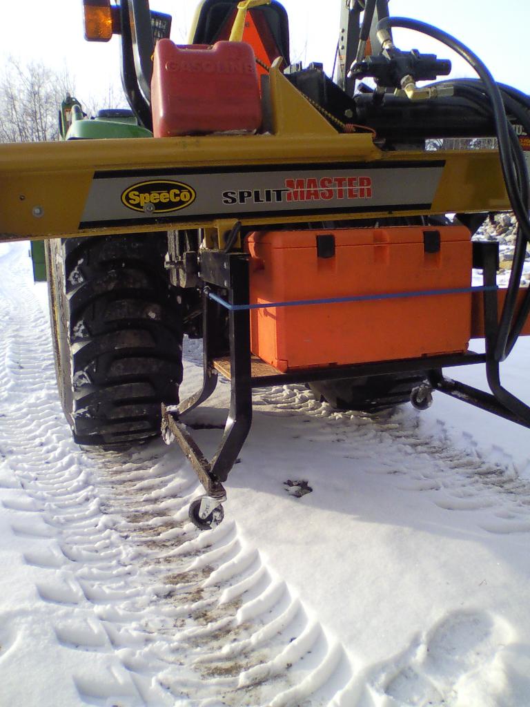

I agree that the legs are a little flimsy. I don't have any pictures but i actually welded a couple of frames around the legs and bolted casters to the bottom one. I shortened the legs by 4 inches so it didn't stick down too far with the casters on. The other frame holds a peice of plywood that works well to hold the chainsaw. When i take the splitter off i can just roll it around wherever i want to store it.
On another note, my Mid mount mower lift hydraulic connections on the back work real well to hook the splitter to. I have to take a "bungy" strap to pull the lift lever to put flow to the splitter.
