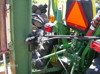

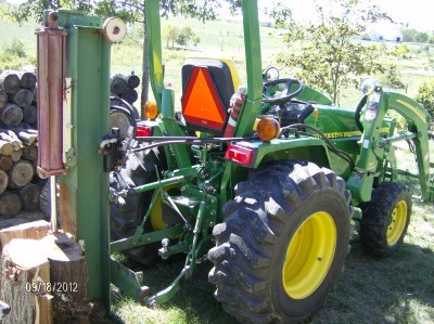

It depends on your needs. If you want to work faster, get the independent splitter. for me, a 3-pt splitter using the tractor hydraulics works fine!
I originally built mine for a 1958 JD 520, when I sold it, I added a control valve & longer hoses to the splitter & use it on my JD 790 CUT.
I hook to the loader bucket hyd. connections & tie off the joy stick with a tarp strap to the opposite fender. Not fast, but neither am I & I work by myself, so it keeps up with me. I have a total of around $500 invested in it, compared to $1000+ for a new self-contained model! ~~ grnspot
