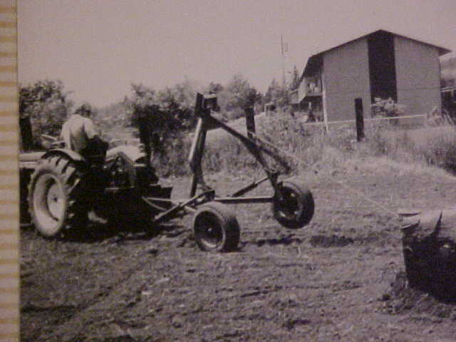

For you folds that do a bit of log dragging and such, I built this hydraulic trailer that doubles as a logging arch and a flatbed trailer. The arch part lies down and a bed is pinned on creating a dump trailer. You can also winch things right onto the bed by tilting it part way up and winching. I have it hooked up to my 8000lb winch. I have a 2 inch receiver built into the blade. It made it a lot easier on the tractor.
