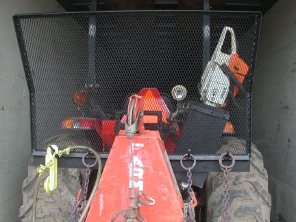

I bought this at a auction last summer and it has been very handy so I thought I needed to make some mods. For safety when I ran it from the tractor seat I made the guard. I don't need a cable in my teeth in case something broke.
I put a chain saw holder on the guard so that it was handy.

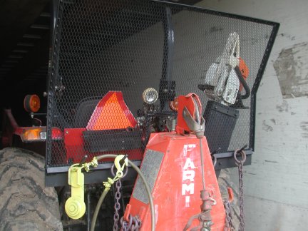

another view
The chainsaw holder was made from plywood and it holds the saw solid and safe and in a position that is easy to get to

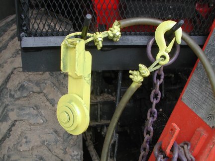

here is the release pulley I made. It work good and makes it easier for one man to work. I used cable covered with nylon tubing to keep from scaring the trees. nylon webbing like on the commersial ones would be better but since I'm on a budget and had the cable it works.

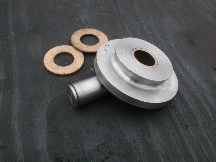

parts I had the local high school make for the release pulley.
The pulley is made so that when the slip holders go over the pulley it releases. The pulley MUST be used upside down so the cable can fall off. Also the strap must be inline with the groove of the pulley so it pulls right.

   / Logging wench mods #10
<font color="blue"> Have used a logging winch for years but never heard of a release pully.What is it's function?
</font>
Just looking at the picture, I'm guessing it's used as what I call a snatch block. /forums/images/graemlins/ooo.gif
