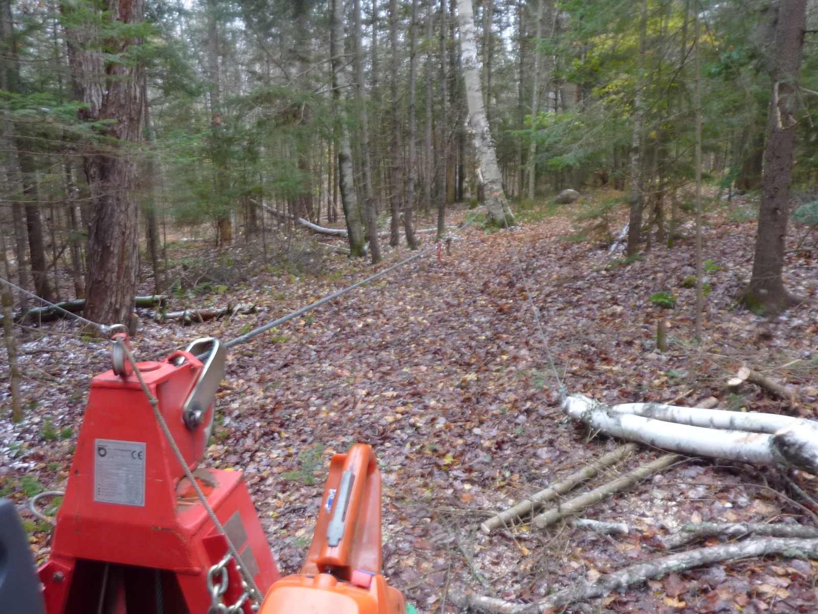

I know the topic of logging winch danger and safety has been extensively discussed in former threads. But this may be a new one.
I am 70 and have worked around tractors and the woodlot since I was about 10. I know things can happen fast and to always be thinking safety. I use a 52 hp Kubota with a Wallenstein fx 85 winch. Recently I had a mishap which really startled me. I twitched several tree length hardwood logs to the landing when one came flying up hitting the protective screen behind me and falling sideways.
Here is what happened. I always twitch with the pto off. When I get to the landing I switch on the pto, give the pull cord a jerk while still on the tractor to unlock the winch drum and drop the load, then pull ahead a few feet, dismount the tractor and disconnect the chokers chains. This time when I switched on the pto the winch came to life pulling one tree against the winch blade jill poking the butt and summersaulting the tree forward smashing into the cage behind me then falling to the side. This took a second or two and happened before I instinctively hit the tractor clutch. Very startling and confusing those two seconds! I shut down to assess what happened. Without the protective screen I would surely have been clobbered bad.
I always try to tie up the winch clutch pull cord safely out of the way. I guess this time I had not. Somehow the cord had become wrapped around the tractor axle and wound tight and engaged the winch clutch. So the moment I switched on the pto the winch came to life by itself. Looked like I had picked up some brush on the way to the landing tangling the dragging cord and somehow had pushed it forward probably grabbing the tire chain and wrapping the axle. But didn't break the cord so must have just happened as I was about to stop. This winch has a ball hitch mounted on it and I think this is what the tree caught on to jilpoke it so fast.
Needless to say I really make sure the cord is secure now. And I assess the winch before turning on the pto.
Anything can happen and given enough time it will.

I had something similar happen once with my old Fransgard after working in snow. The next day the winch clutch had frozen, so just as you experienced the load came in unexpectedly. I always release the clutch slowly though, so had it back in before anything untoward happened.
   / logging winch danger #4
That's a good warning Hoobie. Glad you are OK - sounds like a close one. You are right there is no end to the things that can happen working in the woods.
I had a similar experience but different. The rope was a little stiff from some freezing rain the day before but not to stiff. I winched in a small hitch in the woods. Every thing seemed fine. When I got to the landing, like you, I lowered the winch, turned on the pto, and gave the rope a jerk. The load dropped like I expected it to. Since it was a small hitch I didn't pull forward, just bent over and unhooked the hitch right there. When the chokers were free the cable and chokers suddenly winched in and I got chain whipped across the cheek and my glasses flew off broken. What had happened was the clutch didn't quite release all the way because of the frozen rope so as I unhooked the hitch it was slipping. When the weight of the logs were off there was enough clutch pressure to pull in the empty cable which whipped upwards when the slidders hit the top pulley. I put a knot in my control rope right at the pulley so now I can see at a glance if the rope is all the way back to the release clutch position. I check it now before I turn on the pto and after I release the clutch rope to make sure the clutch is fully disengaged.
gg
you know Gordon that is interesting.This is my second winch which I bought a year ago from the dealer. It was second hand....used one year and traded in. When I first used it there was a knot in the control cord. Real tight and still is there. Never thought much about it. But now that I checked it is right there by the little pulley when retracted. The former owner must have done the same as you.
