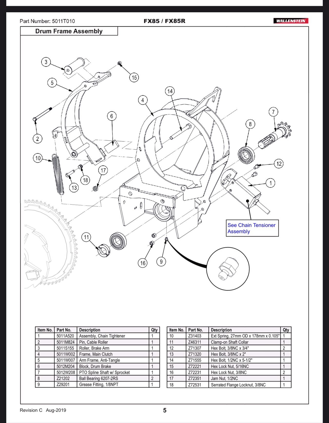

I have a Wallenstein FX 85 logging winch and have been very happy with it. Yesterday I had an issue. I destroyed the anti tangle brake mechanism. The cable feeds over a white plastic pulley down through a brake arm frame and onto the cable spool. When pulling the cable out the brake unlocks. When the cable goes slack a spring pulls the assembly and applies a small brake pad to the rim of the spool. This prevents the spool from freewheeling and tangling the cable.
Somehow the cable caught this brake assembly on retrieving a log and twisted it out of shape and ruined it.
Has anyone else had this happen?

What got destroyed?
Parts 3, 5, 6? All of them?
Never heard of that before. I’ve seen the brake arm (seems more like a tension arm thing), but never realized there’s a brake (part 6) to it. Makes sense.
I’m guessing something went wrong when you where pulling the cable out that let the cable destroy parts when you winched it back in. Think the spring failing would do that?

2,3,5,15. spring is fine Coby. the spring pulls the little brake pad onto the rim of the spool when there is no tension on the cable. my dealer says there was a loop or kink in the cable which grabbed some part. that is why the manual says to always rewind the cable under load. Cable can develop spool memory he said . and I sometimes rewind extra cable after I use snatch block to pull down lodged trees without load. and I had done just that earlier

Had a somewhat similar experience a couple of years ago although only broke the cable. Working with my brothers skidding out tops, I had explained about only winching the cable in under load amongst other things since neither one had used a winch before. One pulled the cable out probably 60 feet and then realized he needed to reposition the tractor. I stood 30 yards away with a running chainsaw and choose not to yell at him for winching the cable in with nothing on it. I think we winched 2 more times with no issue but the 3rd pull after that the cable had become hung up enough that it applied pressure to the clutch without the rope pulled and began winching itself in. Tractor stalled out just as the pto was disengaged, I believe the tangled cable was applying so much pressure that the clutch didn't slip as designed. Easily could have ended up with someone hurt in that situation. Kind of pain to disassemble with the cable tangled. Ended up breaking the cable at about the 15 foot mark and damaging it badly enough around the 30' mark that we had to terminate it there.
That said I normally work alone and winching extra cable in can be a pain. Anybody have any good tips for this? I usually just find a piece of wood to apply a bit of a load.
