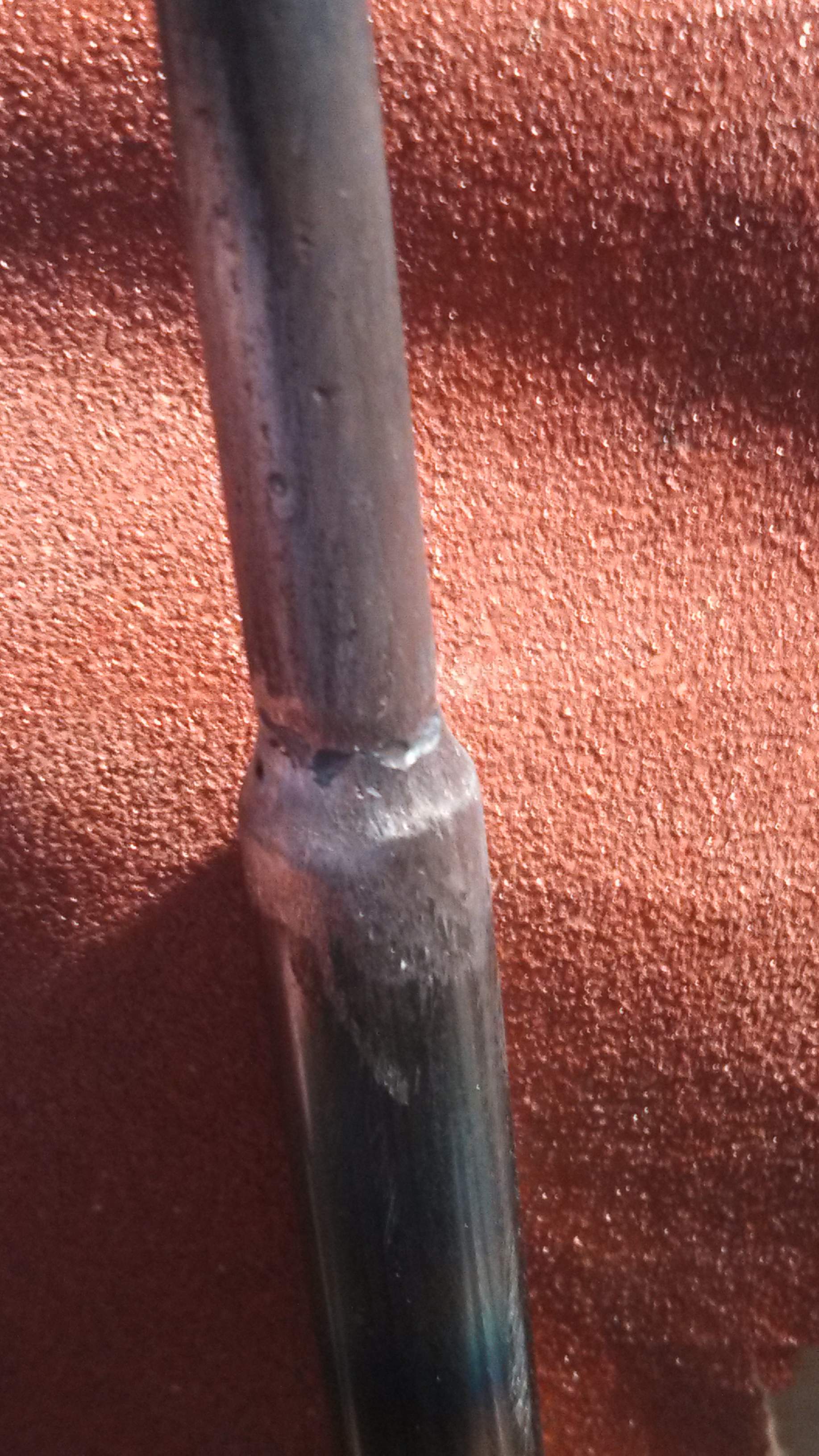

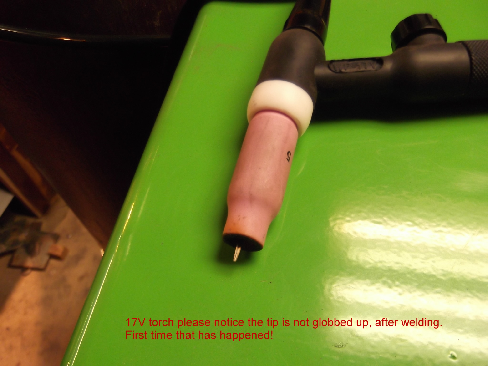

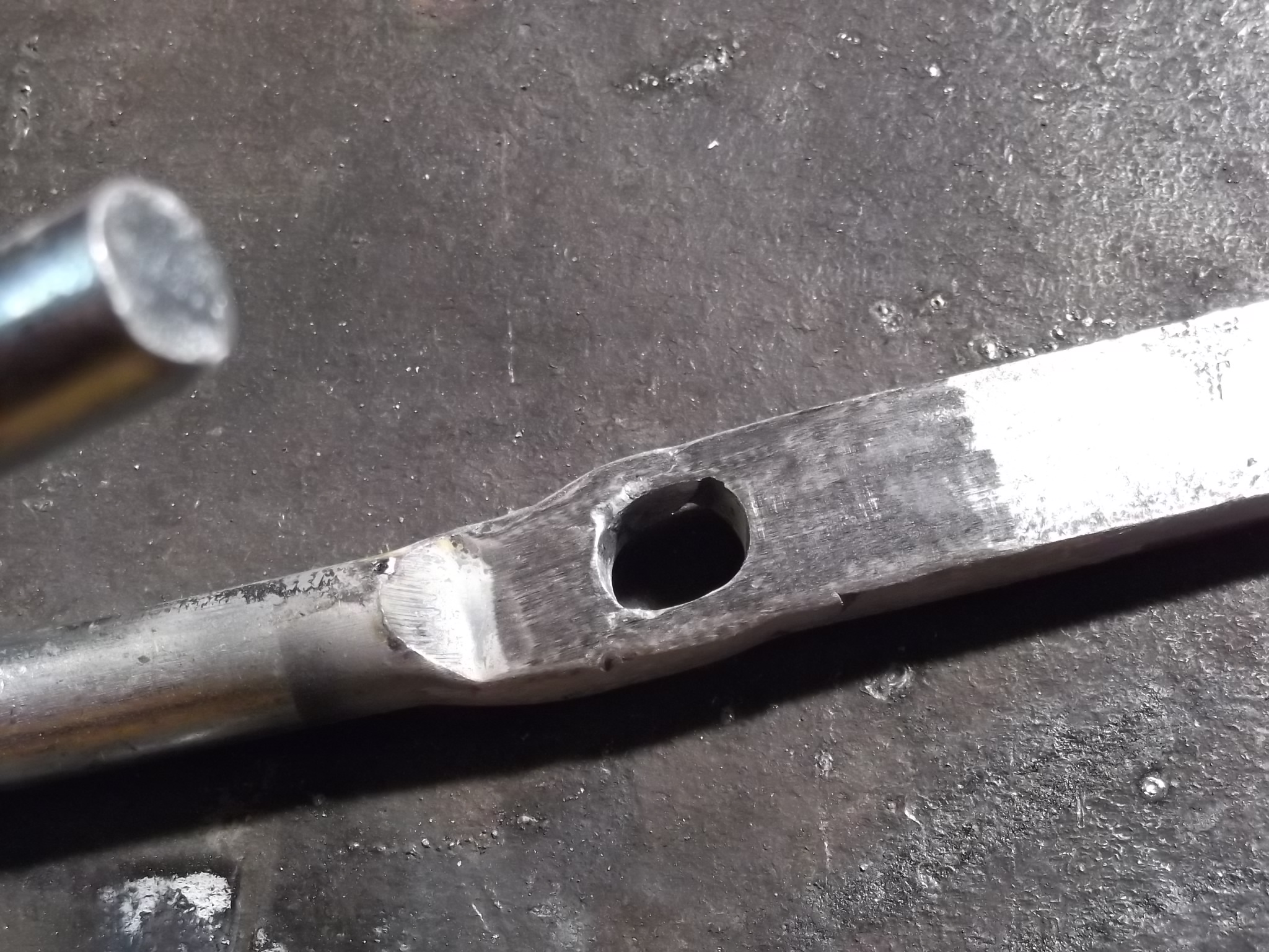

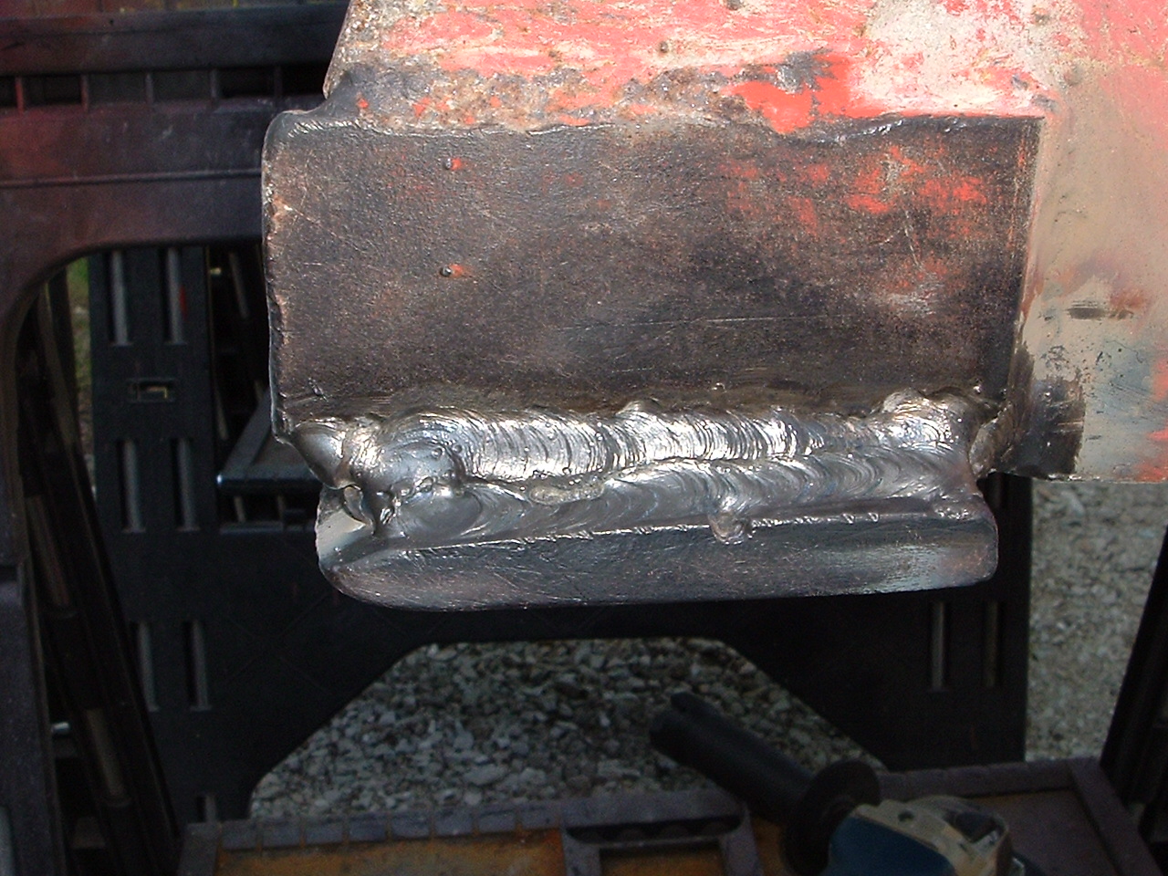

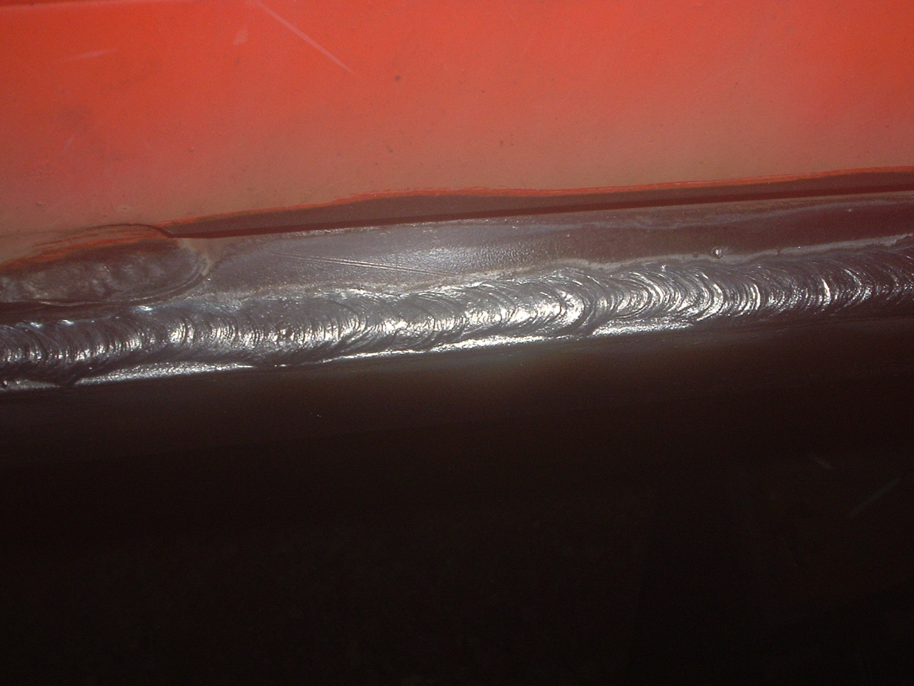

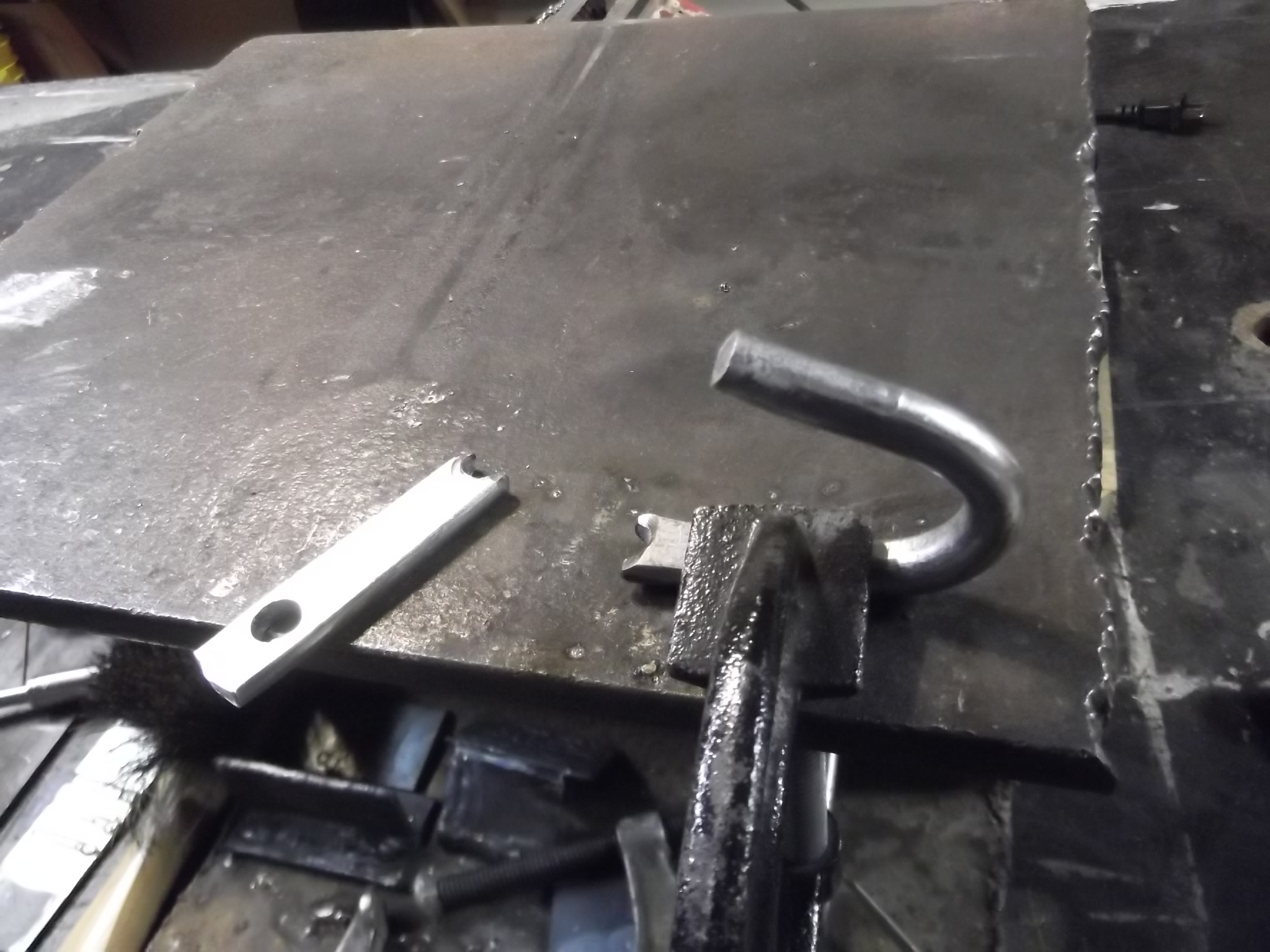

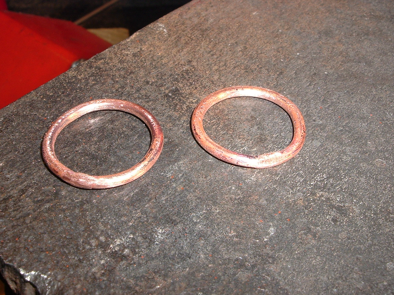

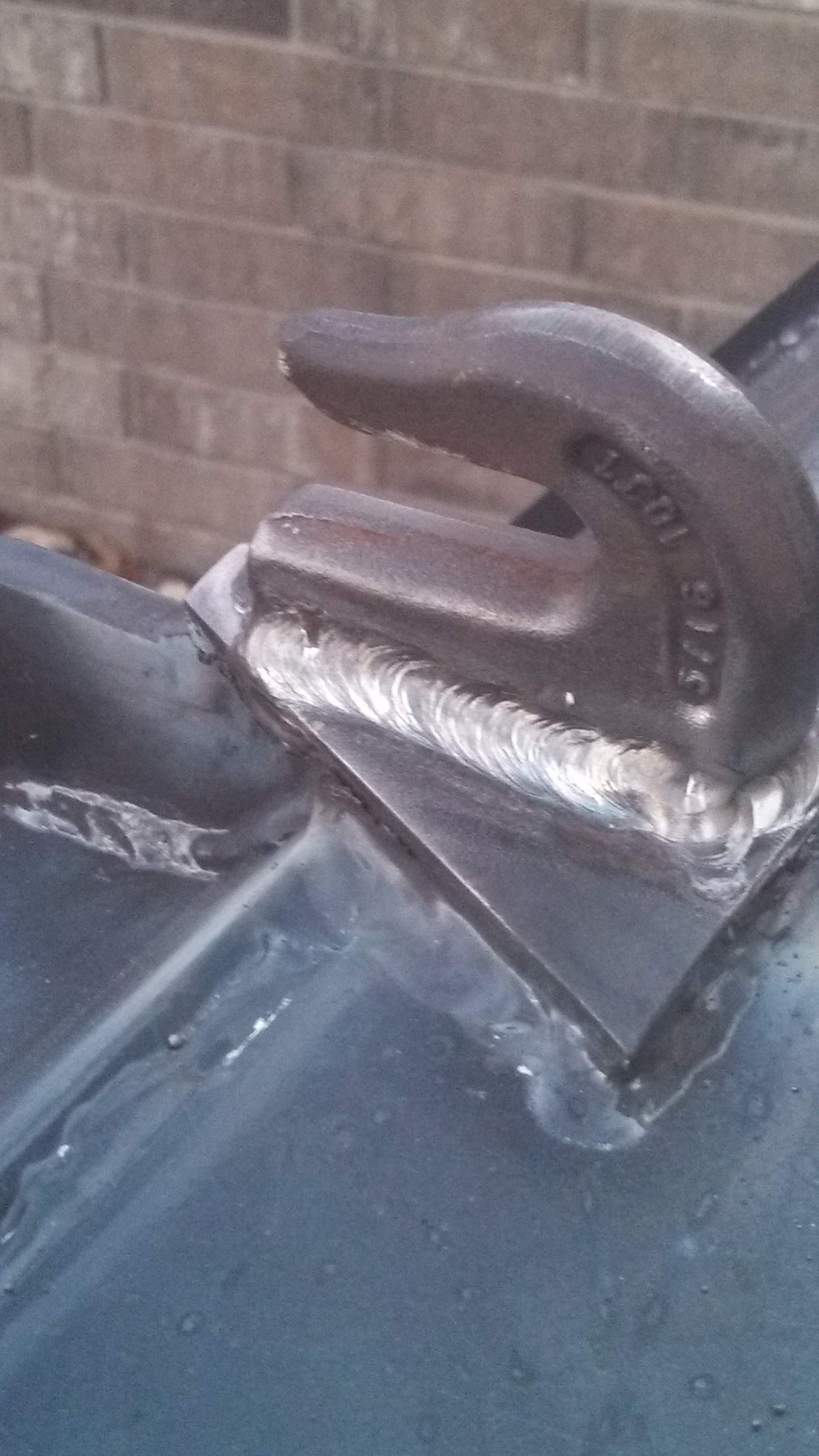

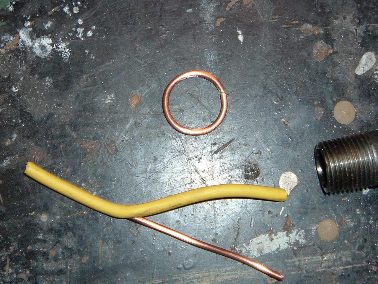

I am very pleased with my Everlast PA160 DC stick welder. I also use it to TIG with when I need to weld thin lightweight materials including brass and copper.

I am very pleased with my Everlast PA160 DC stick welder. I also use it to TIG with when I need to weld thin lightweight materials including brass and copper. <img src="http://www.tractorbynet.com/forums/files/welding/386971-long-out-practice-stick-welder-img_20131023_145811_920-jpg"/><img src="http://www.tractorbynet.com/forums/files/welding/386972-long-out-practice-stick-welder-tig-ground-jpg"/><img src="http://www.tractorbynet.com/forums/files/welding/386973-long-out-practice-stick-welder-dscf0525-jpg"/><img src="http://www.tractorbynet.com/forums/files/welding/386974-long-out-practice-stick-welder-dscf0520-jpg"/><img src="http://www.tractorbynet.com/forums/files/welding/386975-long-out-practice-stick-welder-img_20121117_165336_859-jpg"/><img src="http://www.tractorbynet.com/forums/files/welding/386976-long-out-practice-stick-welder-img_20121117_165303_772-jpg"/><img src="http://www.tractorbynet.com/forums/files/welding/386977-long-out-practice-stick-welder-6outside-weld-jpg"/><img src="http://www.tractorbynet.com/forums/files/welding/386978-long-out-practice-stick-welder-picture-015-jpg"/><img src="http://www.tractorbynet.com/forums/files/welding/386979-long-out-practice-stick-welder-picture-006-jpg"/><img src="http://www.tractorbynet.com/forums/files/welding/386980-long-out-practice-stick-welder-picture-007-jpg"/><img src="http://www.tractorbynet.com/forums/files/welding/386981-long-out-practice-stick-welder-picture-011-jpg"/><img src="http://www.tractorbynet.com/forums/files/welding/386982-long-out-practice-stick-welder-17v-torch-jpg"/>
You know James, I never get tired of seeing that pic of hook on your loader bucket. I like it!:)
Terry
It is all I got Terry.:laughing: You should see some of my failures!:D

I tell you what though, welding those chain links or welding those copper rings was a heck of a lot harder to do!

Here are some fairly decent beads welding on a piece of reinforcing flat bar on the top of my old Kubota bucket.
