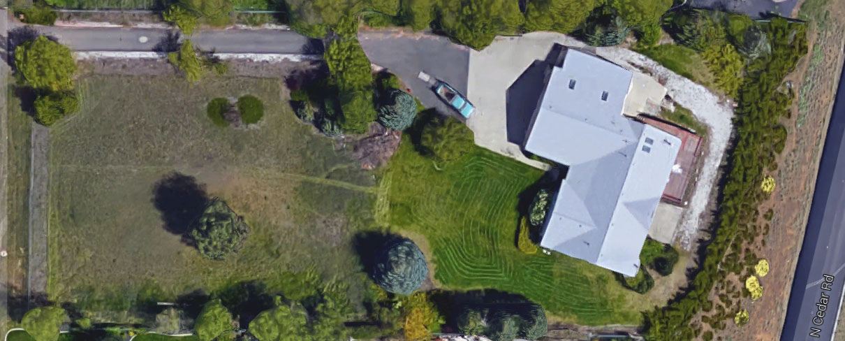

Lots of good information in your opening post. Except diameter of trees, size of stumps and contour of your property.
Rather than spend $6,000 for a Backhoe, perhaps you should hire out the stump and tree removal. A Tree Service would be the tradesman to call. My guy (INSURED & BONDED) charges $1,200 per day for a 8,000 pound skid steer with Stump Bucket, operator, three laborers and all trash hauled away. Your need might be only 1/2 day. Pros work fast.
You will not find enough use for a Backhoe on 1.25 acre to justify $6,000 cost. Sans Backhoe your tractor-loader will be mechanically less complex and your Three Point Hitch will always be available. Use the $6,000 for implements. You will likely want a 3-Pt Landscape Rake with gauge wheels early on.

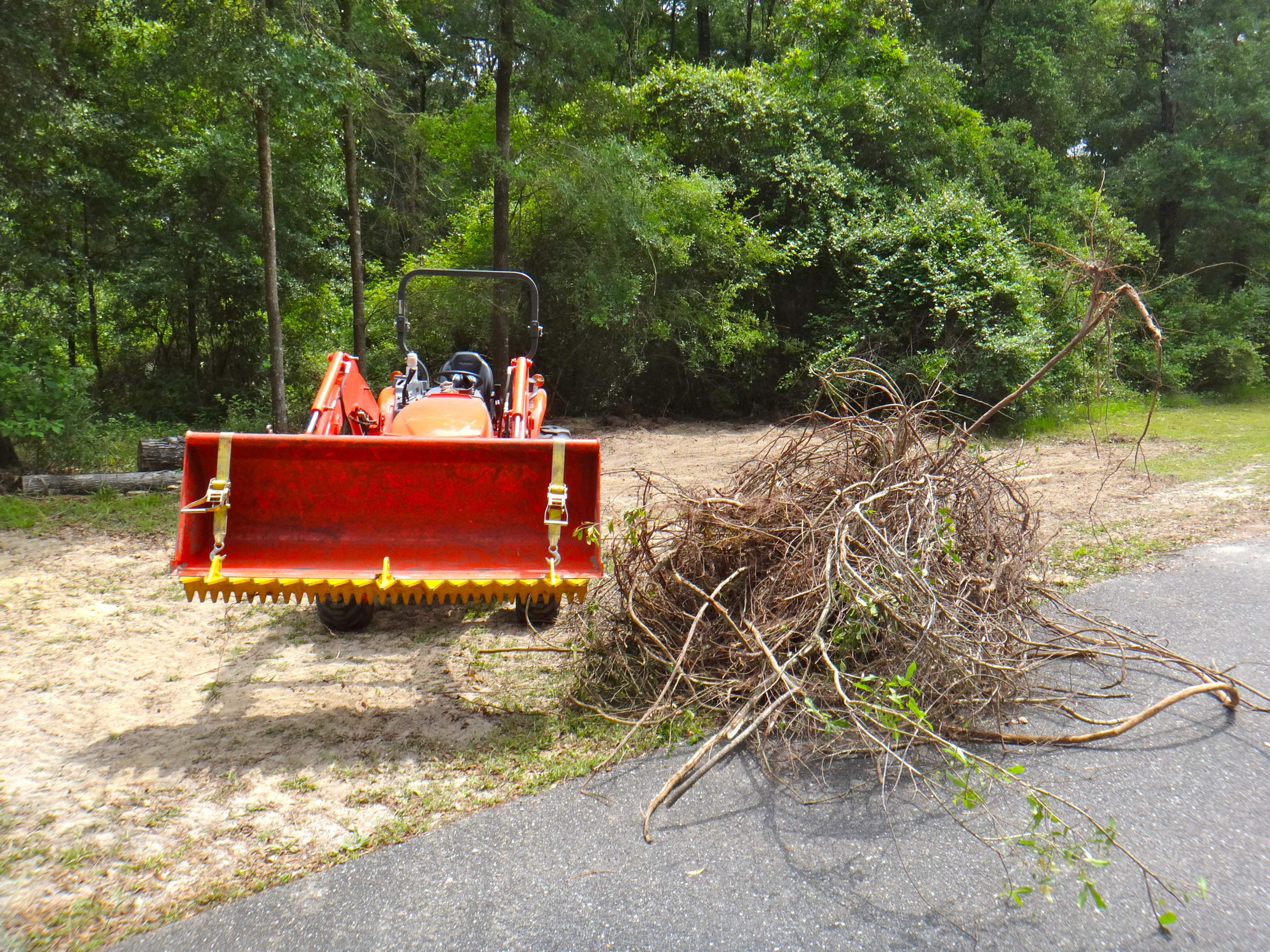

Ratchet Rake photos from Saturday last.

I have three SCUTs, L5740, M8540 and some others and for what you describe, I'm in agreement with jeff9366, we have several hundred acres and still find it makes more sense financially to rent a backhoe or excavator than spend the money on one. For some this won't be the case.
As to the HST, we have a John Deere as well as BX and I can use either, my wife hates the JD, some hate the treadle. My wife didn't like the Kubota at first as e had used side by side for years.
Both are good machines as I'm sure are several other brands.
   / Long time lurker - now at the point of pulling the trigger #5
Listen to jeff9366. All that work is a one time only work, not worth buying equipment for, hire the help and then get the equipment for what you'll do afterwards. If you are going to cut grass then you'll have money for a ZTM.

I absolutely appreciate the comments - Just for clarity sake, I have attached a Google Maps picture of the property to give you an idea of what I am contending with.
1) Jeff9366 - OK - this is true for a one time deal - they are pulled and done. I was also envisioning other work and as you can see from the picture, I am anticipating removing part of the chain-link fence, removing/replacing a sprinkler system, deck rebuild and regrading and area in the back. So, I suppose it wouldn't be a one-time thing per se. The stumps will be left-over junipers mostly - about 6-8inches in diameter and one larger stump - about 14 inches. I also have garage space for one device, but not two. I plan on having a secondary garage in the future to accommodate further fun stuff. I certainly know there will be a learning curve, but this house is a 10 year project, I have all the time in the to play with it and get work done. Plus there is just the fun of it.
2) Yes, it was Cascade tractor - I didn't see any LS tractors out front. They did have the Mahindra's and Massey's. It was a relatively small lot in of itself. I also felt sorry for the guy at the desk - he apparently broke his arm pretty well in several spots and wasn't at his best that day. That and it was raining:)
3) TripleR - I guess I am so used to thinking of the HST from a car perspective that I can understand where your wife is coming from.
4) Trillium Farm - And this is exactly why I am coming to the forum to get additional input.
OK - now that you have seen a picture of what I am up against, what do you all think? There is certainly work for a FEL and MMM - no argument there. I will question the utility of a BH, but considering the work that is there will be used and it will have use for several years from what I can picture.

If you want a tractor and can afford it, buy it.
You will probably move someday....and have more property with who knows what kind of projects:confused3:
1 acre, 40hp would be perfect..:D
Really, no BS, get what you want if you can afford it, take care of it, keep it out of the weather it will hold its resale value if you ever decide to sell it, and it's there if you need it.
   / Long time lurker - now at the point of pulling the trigger #8
Yes, the BH is a bit of a luxury but I have dug several long trenches, dug more than a few decent sized evergreen stumps, and enjoy it when it is on my machine. It is a very fast job to dig a hole to plant a bush or fruit tree, or... and it is easy to remove and store on a dolly if you want a different rear implement. Yes I said, a luxury but if you have lots to do around your place... I do and I have 1.5 acres... it is nice not to have to hire or rent. It can do pretty big jobs just takes a little longer than a pro. Oh, and fun and a feeling of accomplishment! As you can probably guess by now I am a huge fan of BX25D's! I have 230hrs after almost 2 years of ownership.
