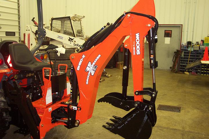

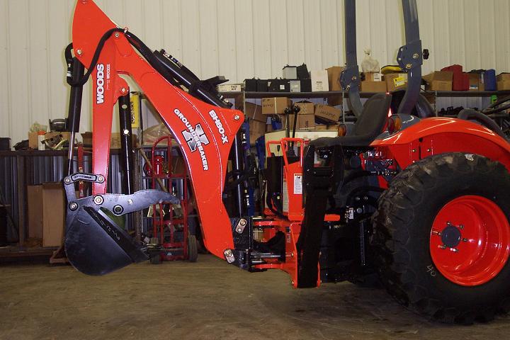

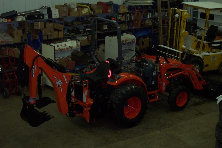

<font color="orange"> This is a 4 point mount and you can also run a mid mount mower with it. </font>
What do you mean by 4-point mount? Does it have a subframe? If it does, how can it be used with a MMM? Again, if it does, how low does it hang as opposed to the Kioti brand hoe?

</font><font color="blue" class="small">( What do you mean by 4-point mount? )</font>
There is a subframe that stays with the tractor. The BH is set into two hooks on the bottom and then moved into two pins at the top. When it's removed, the subframe part stays connected and rides several inches higher that the Kioti subframe.
I would say it takes just a bit more maneuvering to get on and off, but not much. The way it's built, the MMM can still be used as opposed to the Kioti subframe setup, since all of the backhoe part comes off, there is no need for the Kioti replacement rear mount where the drawbar goes.
The Woods is a lot easier to load onto a trailer with that higher rise.

That must tuck up there quite nicely then. How do they get the subframe up far enough to allow for the MMM to be used?

</font><font color="blue" class="small">( That must tuck up there quite nicely then. How do they get the subframe up far enough to allow for the MMM to be used? )</font>
It's just a difference in the way the subframe attaches. The Kioti has two front braces that extend down at the bottom of the loader frame up front, and the drawbar mount is replaced in the back with one that has a lip for the backhoe to slide into, which is lower. The Wood's frame work attaches higher up without the low extensions in the front. Now, I haven't seen an MMM work on one, but I can see why it could as I've seen this backhoe setup on a CK20 with Woods' loader and backhoe. Wallace is the one who has experinece with the MMM working, and I trust his statements.

Yes woods has the 4 point mount for the CK25 and 30
The picture you saw was the new Woods 80 on a CK30 hung by woods 4 point mount
