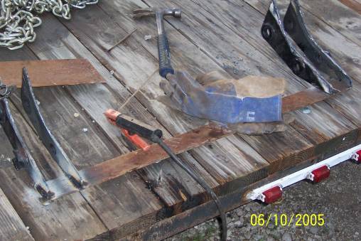

/forums/images/graemlins/grin.gif Just thought I would share with all of ya what I'm doing. I wanted a QA bucket on my CK30 but didn't want to spend the extra money. So I decided to build it.
The first pic is what it looks like off the tractor and the back tabs with the pins cut off. Also just before I used the grinder to smooth things up.
This is a lot of fun. /forums/images/graemlins/grin.gif /forums/images/graemlins/grin.gif

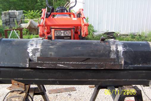

the second picture is of the tabs with the spacer bar welded across the back. A shot of it before i ground it smooth. I welded the spacer bar on before I cut it off the bucket so that it would remain spaced the way it was on the bucket. worked out real good.

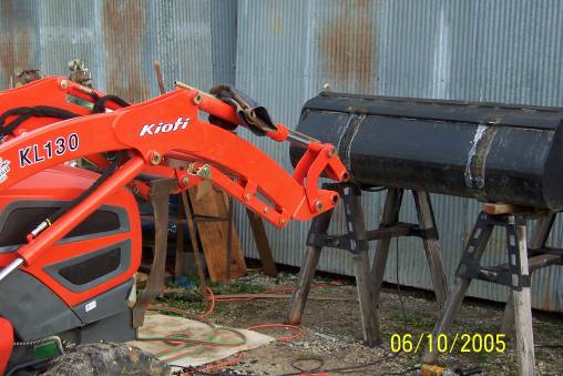

a shot of the tractor loader arms looking at the bucket as If to say What the heck is going on!! /forums/images/graemlins/grin.gif

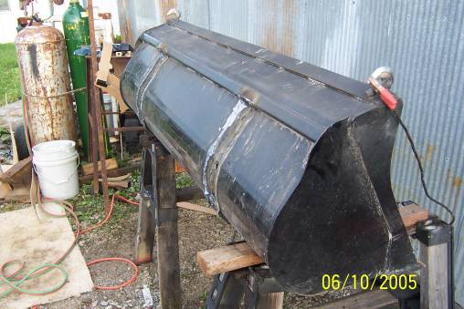

a shot of the tabs and spacer as I'm doing the final welding. I didn't have time to take many more pictures but I added more strips along the curved part. for spacers and to fit up against the bucket.
I was burning daylight. needed to get as much done as I could.

Last picture of the Day. The QA attached to the loader arms. I have a few more things that I want to do to It but I wanted to see how it fit. Seems to fit and work nicely. I will post more pictures as I progress. Mark

Keep us posted, looks good.
   / Look what I did to my poor Loader bucket!! #7
Holy mackerel, can you say "substantial"?
I have the QA for my Kubota loader and the ATI adapter for the bucket but have been progressing cowardly regarding cutting the pin ears off.
Nice job, keep posting.
Martin

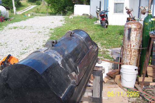

well here is a few more pics. this is the view of the bucket with the lip and the the bottom pin holder. I got a shot of it just before I primed and painted it.

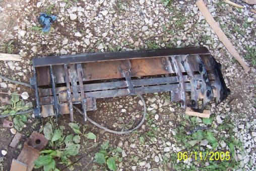

picture of the bracket that fits the loader.
