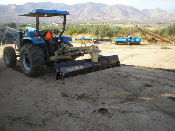

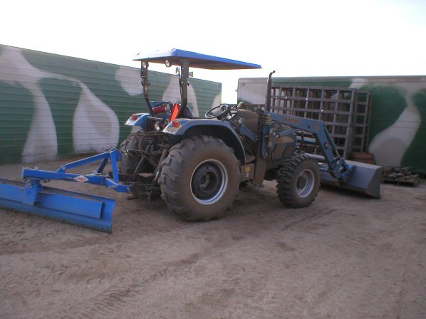

Just my :2cents:, assuming that you are going to be using this blade behind your 5530 and not some other tractor. If you are going to work the blade and not just do fluff type work, DO NOT get anything less than 100lbs per foot. It will end up bending and you will need to get a heavy duty blade anyway. This I know from first hand experience and being nieve and trusting the dealer. :( $1000 mistake that was. :mad: I bent the blade THE FIRST time that I used it, not bad, but bent it. I used it for 2 more years before I could afford to get a good one. The killer of this whole debacle was that I had questioned the dealer about the strength of it to start with and was told that it was plenty of blade for my tractor. When I sent them pictures of the moldboard being actually pushed backwards and the guide plate being bent, I was told that I had abused the implement and that there would be no warranty for it. :smiley_aafz: This was a 680lb Mid West rear blade. What I would now consider a decent medium duty blade. Problem was I was using it behind a 9300lb tractor and it was just to much for that blade.
Here's a pic of the Mid West blade and my Land Pride 45 series. :cool:

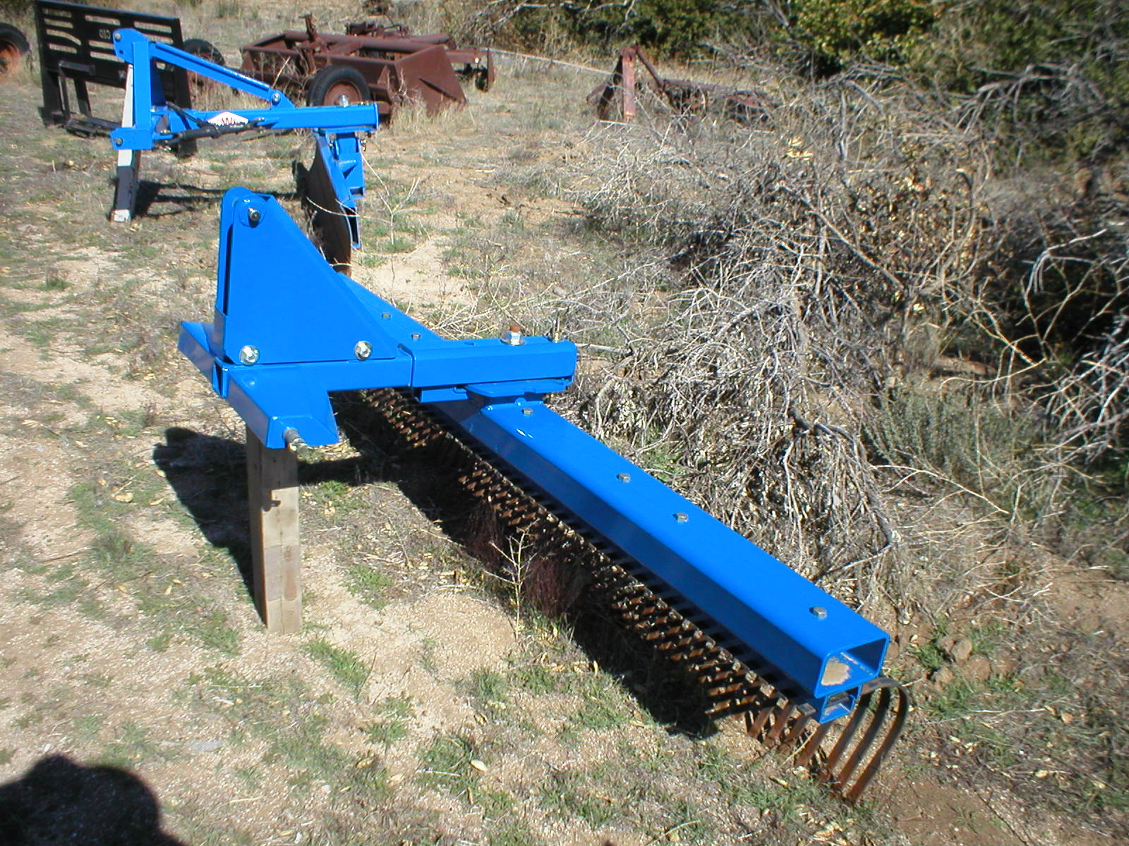

Imagine a pretty much flat piece of 5/16" plate that had a 6" channel iron welded to it and then bent backwards a few inches. :eek: That would be a closer picture of what it is now than if I tried to explain how the curve of the blade is now not so curved and the 8' length is not straight, but bends backwards.
No I am going to use the hitch and beam to make a "killer landscape rake". :drool: I churroed my original landscape rake, then made a new tine bar that would not bend, so then the cat 1 hitch was the next weak point and proceeded to bend. That 1/4" material just does not work well behind a heavy tractor. when I get this one done, it will have hydraulic offset and angle. Any tilt needed will be with the Top & Tilt set that I have on each tractor. Take a look at the tube on the rake. That is a 7"x 4" tube with 3/8" wall. It has channel fastened to it that holds all the tines. When I'm done with this, it should weight between 700 & 800lbs. :cool: I will be sure to have pics up when I do it. ;)

Brian,
If it were me I would rather have a row of S tine cultivators with the narrow feet on about 4" to 6" spacings. Would be good for raking heavier devris yet still allow most of the dirt to pass through. Then a standard landscape rake with less overall weight could perform clean up.
