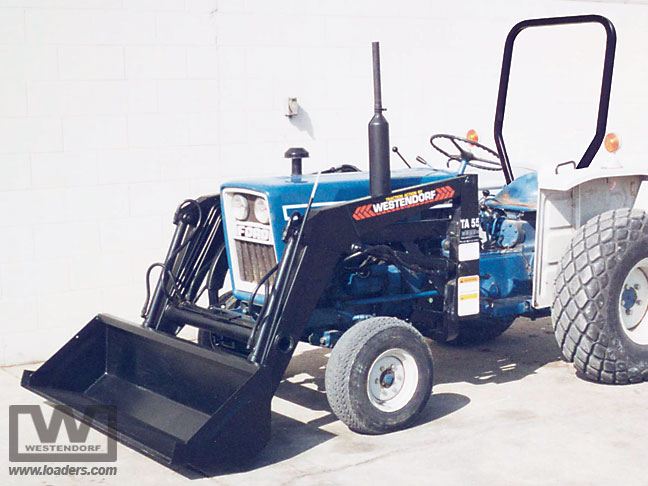

ford 1600
What brand or at least who makes a front loader for a Ford 1600 tractor. And how difficult is it to put on and take off??

Like the man said a Bushhog 2240 or 45 or what ever the number is.
But be warned. Its a small 2 wd tractor with a standard hydraulic pump made in the late 70s to mid 80s. You might be front end heavy and slow to lift.
If you put a loader on it get the lightest possible to do your work. A bushhog 2245 Koyker 150 or 160 or something similiar.
Theres a lot of new bracketless loaders for sale that are cheap 600 to 1500 but theyre made to mount mid mount not braced to the front end.
Brackets are the problem, then accessing your hydraulics.
Unless you Love the 1600 trade for a slightly bigger tractor with loader on it.
   / Lookin for loaders #5
A Westendorf loader is the easiest to take on or off without tools, stands or even a slab of concrete... See Video of complete hydraulic power mount. The TA-55 loader is a fit for the Ford 1600 - you can use the loader selector online to research the fit.
