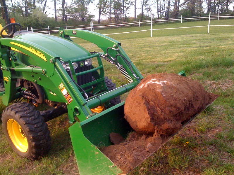

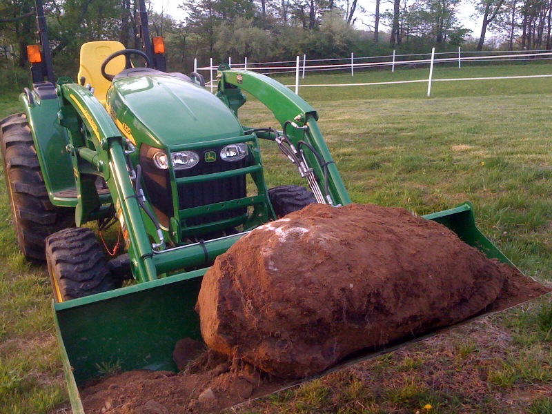

My new JD 4320 w/FEL arrived yesterday. I will replace my "For Sale" B7510. The Kubota
was under-powered for my needs on 18+ acres. I'm already putting it through it's
paces to help remove dirt for my wife's round pen. Plus, look at the muther of a bolder I removed with the FEL, although a Markham Welding Co. (as on my Kubota) tooth bar will be ordered this week. I hope to find this forum as great as the Kubota one.
