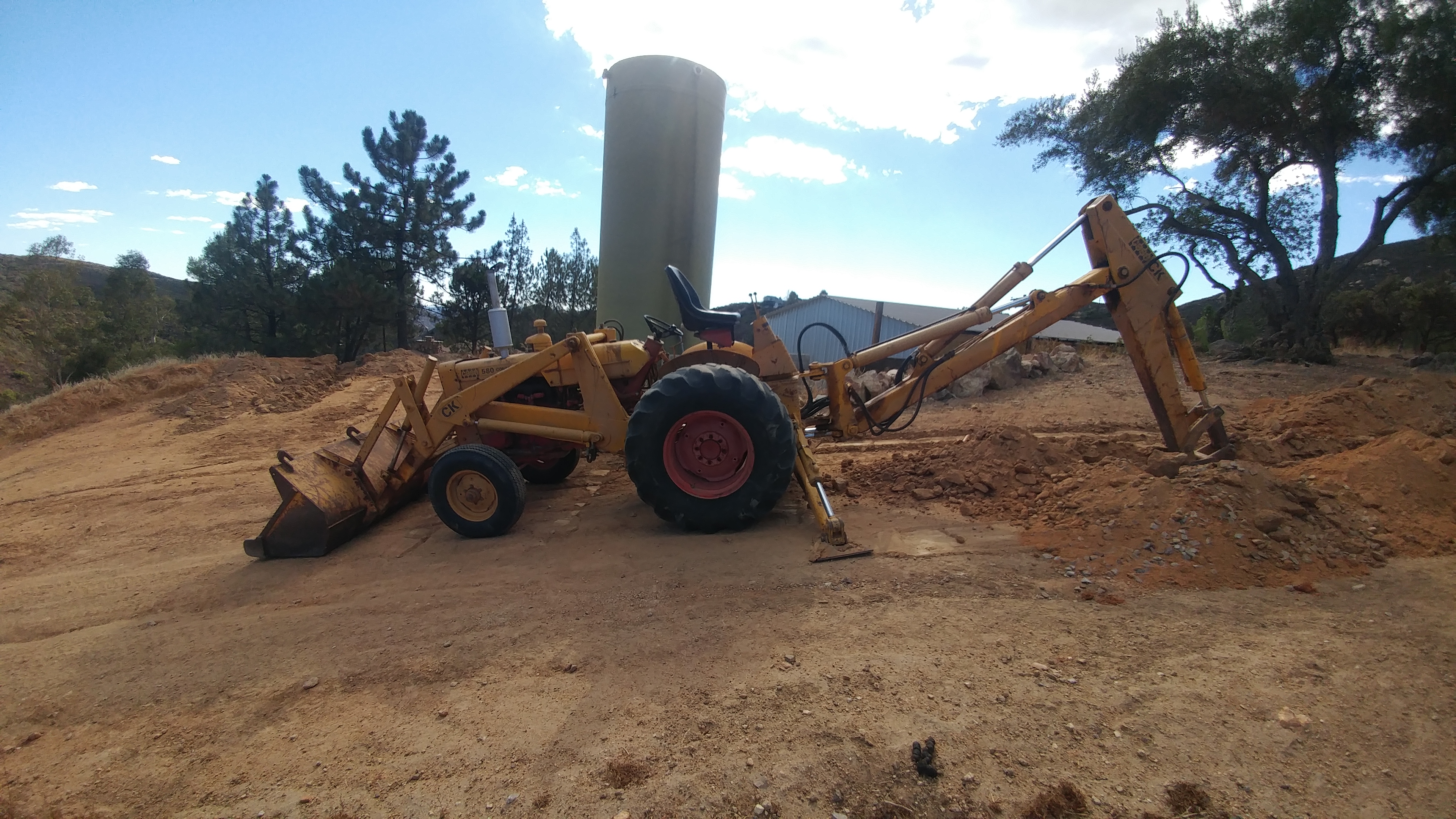

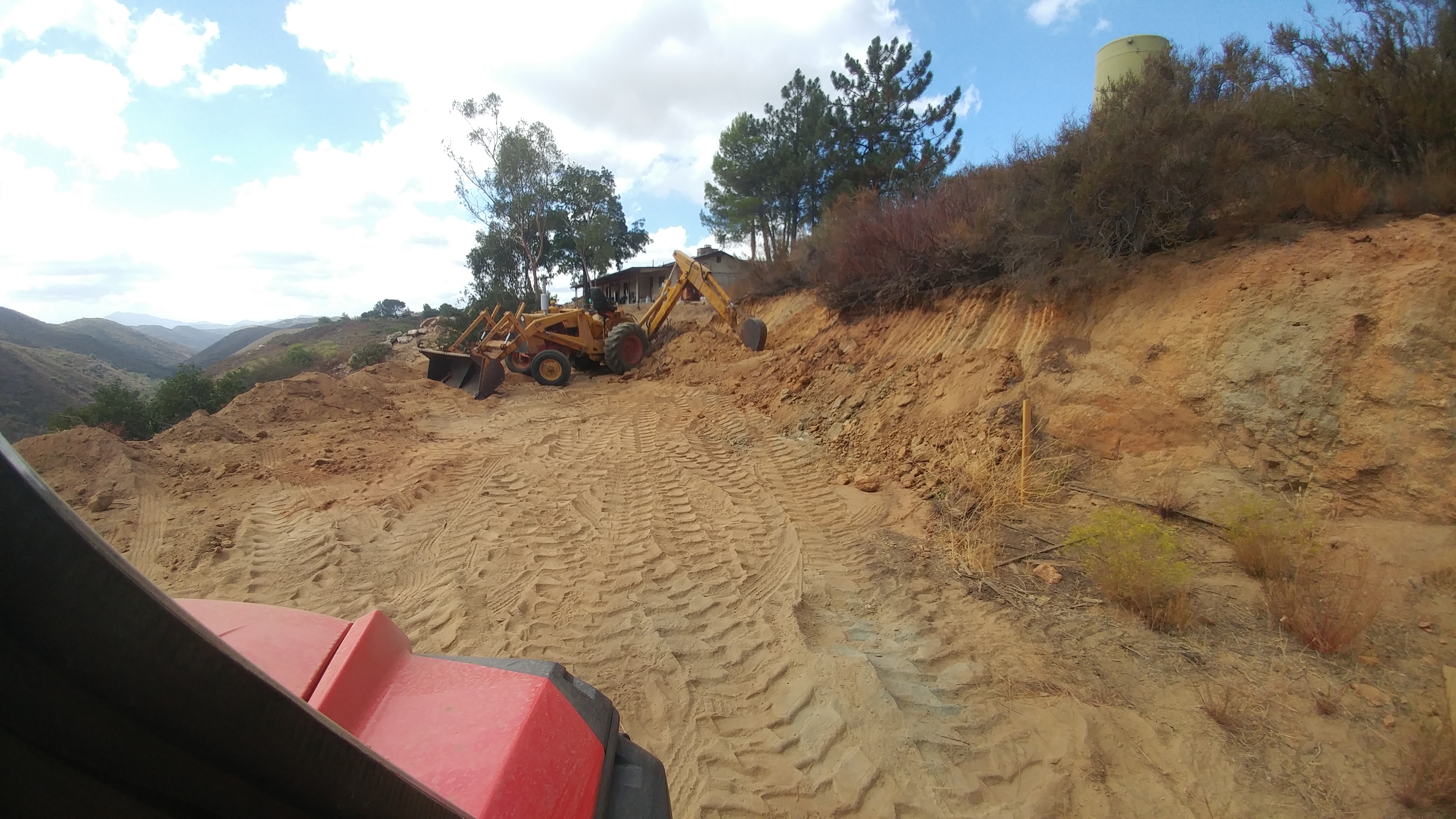

It's done so well... I removed an embankment where my solar was going to be placed... about 10-12' wide of 7' high bank that's atleast 100' long (someone do the math on that yardage! haha). Used the hoe to dig the bank, and the loader to move the dirt to the opposite side of the path... downhill. This path, was an old access from my neighbors house to an old shack and trail that leads down into a canyon behind our houses. A perfect place for solar. Out of my sight, but within sight of the neighbors... so, I asked permission of them to place the huge 56 panel array BEFORE I started to dig.
Here's the hoe working the embankment (and sitting there, since I blew a hose);

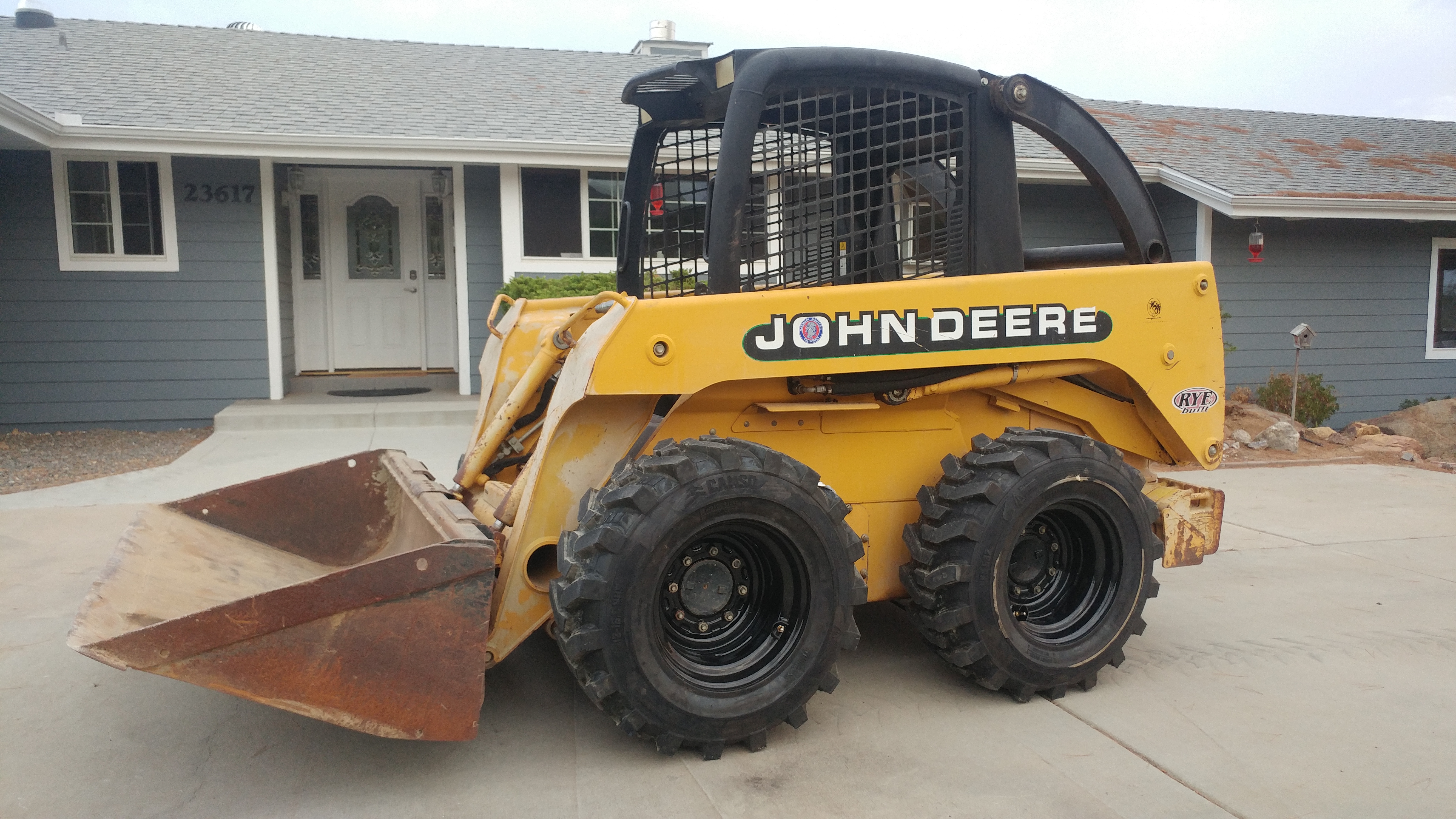

I've recently purchased a John Deere 240 skid steer, with only 630hrs on it. Did some maintenance on it, and got it tip top shape. Here it is, as it sits today;
