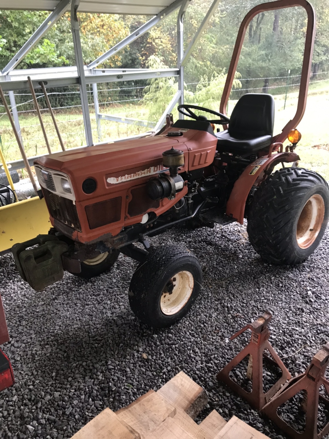

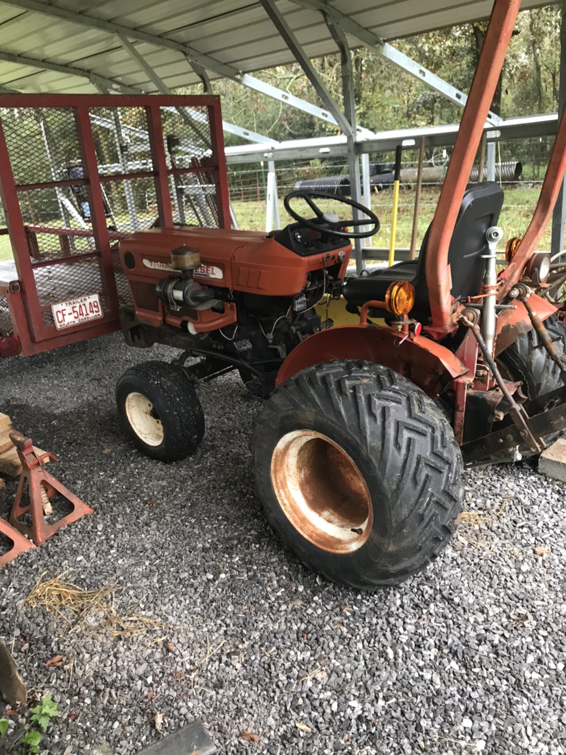

Here are a couple pics of the ym169

This YM169 will need some going over, the brakes will need adjusting or shoes replaced. After it quits raining here I will be able to check it out better, all fluids were supposed to have been changed according to PO, don't see any leaks so far, coolant in radiator looks good, engine oil is on the mark. Got to get some brakes on it and then put a finish mower behind it and see what happens.
