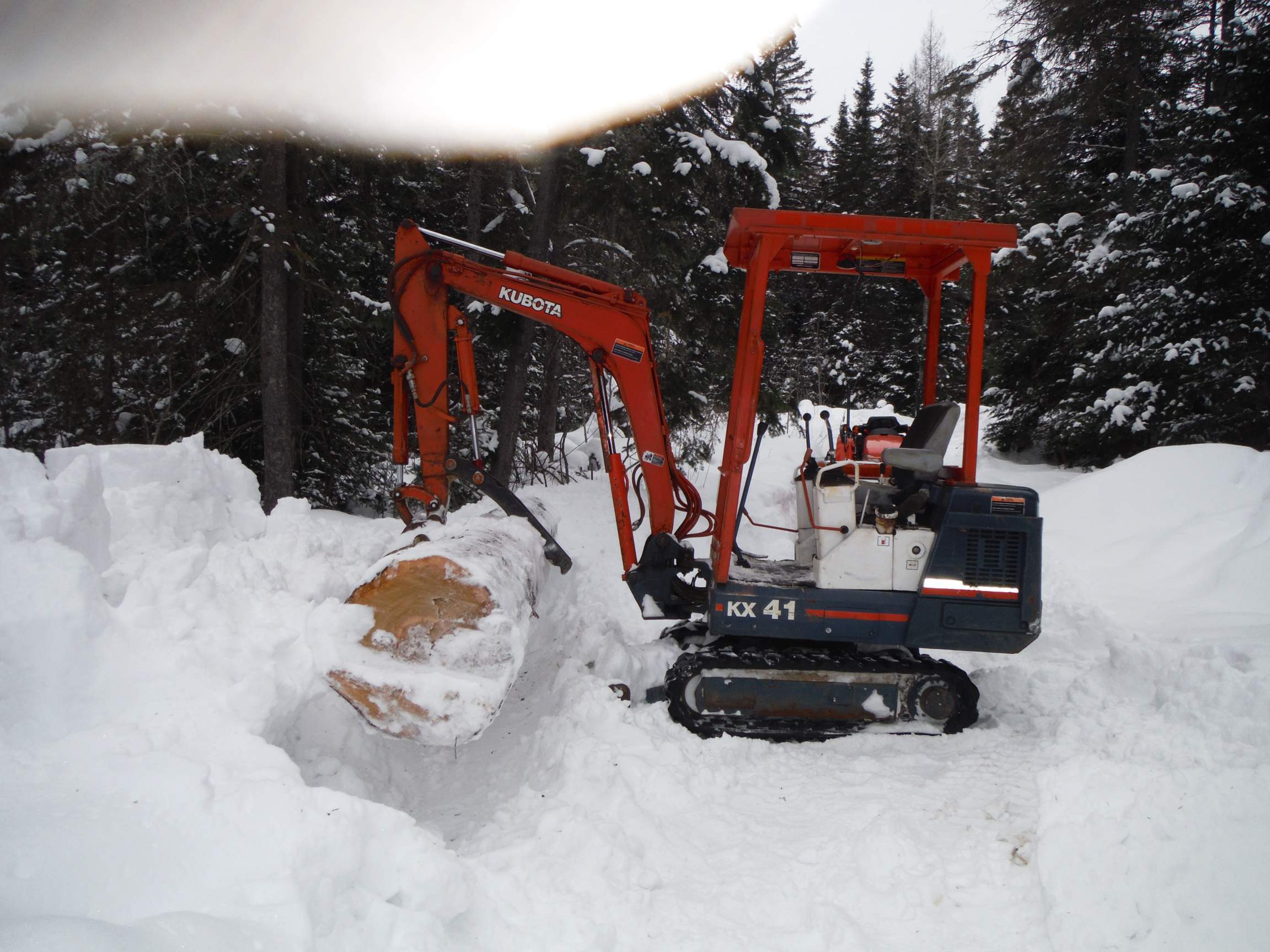

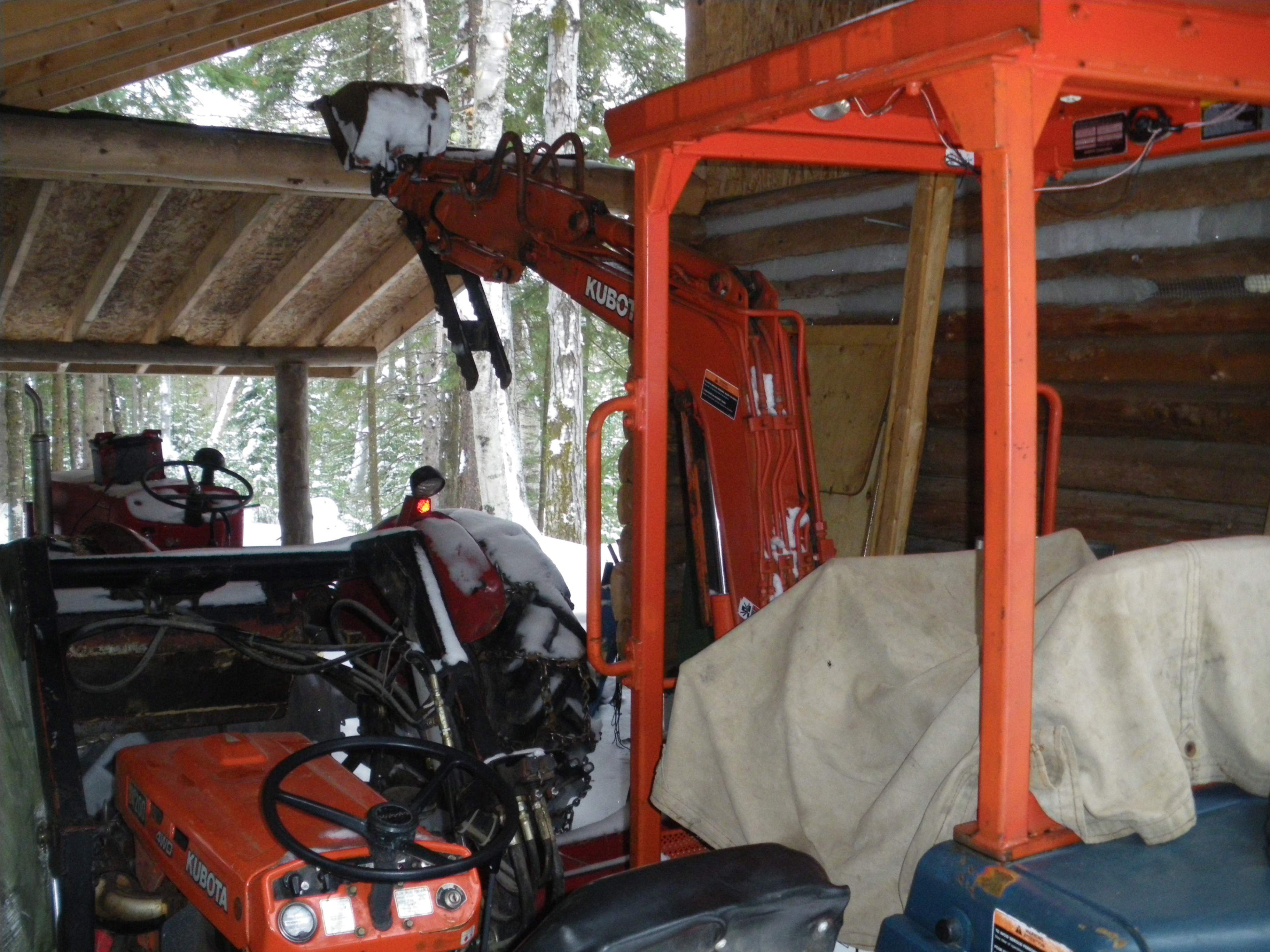

It would be nice to have the money for an 8K machine but then I would need money for a 12K trailer. Since I don't have a basement to dig and at least a year to do the digging I am hoping this machine will do the trick. With all the snow I did not get it home till after dark. I got stuck trying to trailer it back into my camp so unloaded it and drove it in. Next project is a small dump trailer, but think I will have to build it just large enough to get this machine on because its slow. I estimate it would take an hour to drive from camp to were my home will be built about a mile away. Anyway everything works well, one brand new track, new turntable bearings. Aux Hydraulics plumbed to a thumb. It had been 112 hours since last oil change and finding that it takes the same oil filter as my B4200 that I had on hand, I changed the oil. It was -10 C outside and I figured I would circulate the oil by cranking it over without using glow plugs. Machine fired right up. I did not expect that because neither of my other two Kubotas will cold start with out glow plugs. I am also impressed by how quiet the machine is. No ear protection needed.

The little KX41 can lift a good size log. Since the B3200 could not lift it, its probably in excess of 1,000 lbs.
