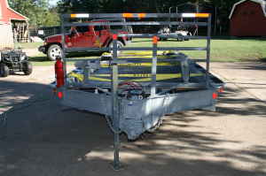

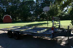

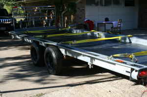

It's a 20 ft two 7lb axle trailer. I haven looked at it yet but talked to the owner. She told me it didn't have brakes witch is hard to believe. I absolutely want pull a trailer this size without brakes especially if my 7,000lb tractor is on it. Assuming she痴 correct how much trouble is it to add brakes to the current axle(s). I noticed Northern tools have some 12" brake kits for around $300. It that something an average handy person can do or does the axles need replacing? I have a 2008 Silverado which I think has about a 8,000lb tow rating. Below are some pictures and the trailer is a little different but I'm going to use it for multiple purposes and will never put over 8,000 lbs pulled by my truck on the highway. Anyone seen a trailer like this or is it home made? I sure do want it but the brake issue is causing me to hesitate. Thanks, Bob

IF the wheels are mobile home axels don't bother.they will carry the load but not easy to put brakes on.If it has a auto bolt pattern then mabe. Over all just to keep safe find a used factory made double axel with 4 brakes 6 lugs rated at 9999 lbs with a 2 5/16 hitch.

I've got a trailer with mobile home axles and it's a nightmare. Don't buy it unless you plan on converting. I'd make sure you're getting a deal with those axles - the tube can be saved and new backing plates and wheel hubs installed on your spindle with conventional stuff. It'll cost a grand to do it.

Strange looking trailer.
I would need to understand what materials the frame is constructed from to make any recommendations. It looks like the sides may be large pieces of angle iron with C channel or I beams underneath a metal floor. I wonder if there are additional frame members that run the length of the trailer. If the frame does not have additional members running the length of the frame then it may not be capable supporting your 7K tractor.
This trailer certainly weighs more than 2K pounds, possibly 3K or more. The weight of the trailer combined with your 7K tractor certainly exceeds the 8K tow capacity of your truck.
I can not tell if it has mobile home axles from the picture. MH axles typically are rated for 6K although some are rated for 7K. If they are MH axles the cheapest, easiest way of getting brakes would be to buy two mobile home axles with brakes. Cut the MH axles and weld them at the correct length. Swap the new mh axles for the old then wire it up. I have done this in about half a day with a retired welder helping.
MH axles in my area cost around $75 each for axles with brakes, tires with rims are $25. I picked up two almost new tires for my trailer on friday. They were Duro tires and said they were for tailer or mobile home use.

Like others have said the MH axles are one thing and if they do not have backing plate mounts you are in a can of worms. I would say even if it has everything needed to add brakes its going to weight about 3,000# to 3,500# empty. Way too much for your 1/2 ton GM with the tractor in tow. No trailer is going to allow you to put a 7,000# tractor on a trailer and keep it in your tow rating.
