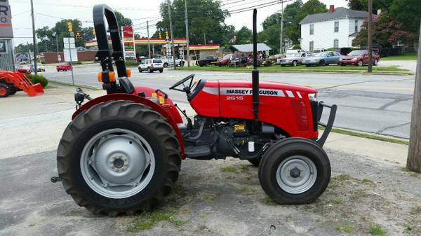

Looking at MF 2615 tomorrow, could use some advice
   / Looking at MF 2615 tomorrow, could use some advice #1
daugen
Epic Contributor
Feb 27, 2012
20,992
New Hope PA
in between now
I'm looking at a used 175 hour 2011 MF 2615, which I understand has an engine, if not the whole tractor, built in India
to Perkins design. I'm ok so far, Perkins is all over the world, but what about parts availability if say a gear breaks or a
clutch goes out? There's the issue with engine parts availability, filters, etc, and then the balance of this fairly simple geared tractor.
No FEL, just a second tractor for me to put a five foot heavy garden tiller on and also to do some mowing.
So my question is who owns one of these and has parts access been an issue? Is there any aftermarket or are you stuck going to
a dealer? If the pto broke something inside, would I wait two months for parts?
I went to the engine mfg Simpson's website; they are basically number two behind Mahindra. In other words big.
With properly obtained Perkin's licenses, probably back from the Colonial days...
I've looked at older tractors and they have been dreadful. Here's an almost new five year old one that's very simple and appears
to be a nice basic utility tractor. I'd buy a Mahindra and not worry about the parts; but what about this Massey?
211 MASSEY FERGUSON 2615
I can buy this for twelve even with tax and new fluids and filters.
thanks
Drew
   / Looking at MF 2615 tomorrow, could use some advice #2
The MF2615 is a good tractor with its Perkins licensed engine. It has very low hours and looks to be in excellent shape. If you don't need 4wd or a loader it should easily do your mowing and tilling chores. As far as non stock parts go, Mahindra is no exception. Another member has waited about 6 weeks so far for parts for his new Mahindra tractor. Parts availability can be iffy with any brand. Things like replacement clutch, filters, tires, etc. are usually available within a short time but internal engine, transmission, PTO parts may take a while to get.
thanks guys.
Well I bought it, seemed like brand new, everything worked, no leaks, apparently was a garage queen.
12 grand including tax for a 2011 with 170 hours.
What was nice was going into the local Massey dealer, which appeared sadly on its last legs, and they had every replacement filter in stock.
Plus the outer air filter which was 75 bucks for a Kubota was 55 for the Massey.
The parts guy had been there 42 years and he said these tractors were very reliable once several years into the run.
He also said he thought he'd never have as reliable a diesel as a Perkins until Massey/Agco started using Finnish Sisu engines in their larger tractors.
Those engines he felt were very impressive.
I just have to remember it's a two stage clutch and not keep pushing the clutch down all the way to shift gears. That disengages the pto.
Probably one of those cases where if nothing has broken by now, this tractor will hopefully go a long time without issues. It was dry as a bone underneath.
Am thinking I probably ought to change the coolant due to being 5 years old ,another thing for the list before they deliver it next week.

   / Looking at MF 2615 tomorrow, could use some advice #4
Congrats on your new to you purchase.
   / Looking at MF 2615 tomorrow, could use some advice #5
Very nice.
How much HP?
