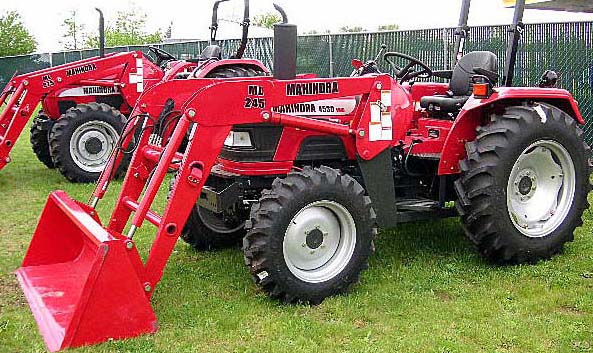

Zettajoe, I just sent you a PM (private message). The 4110 is a really strong compact, certainly on the upper end of the compact range. The 4530 is a utility tractor and is substantially larger and lifts a lot more in the FEL or on the 3-point.
   / Looking at the Mahindra tractors #6
I was looking at those same two tractors. The 4530 is much bigger.
