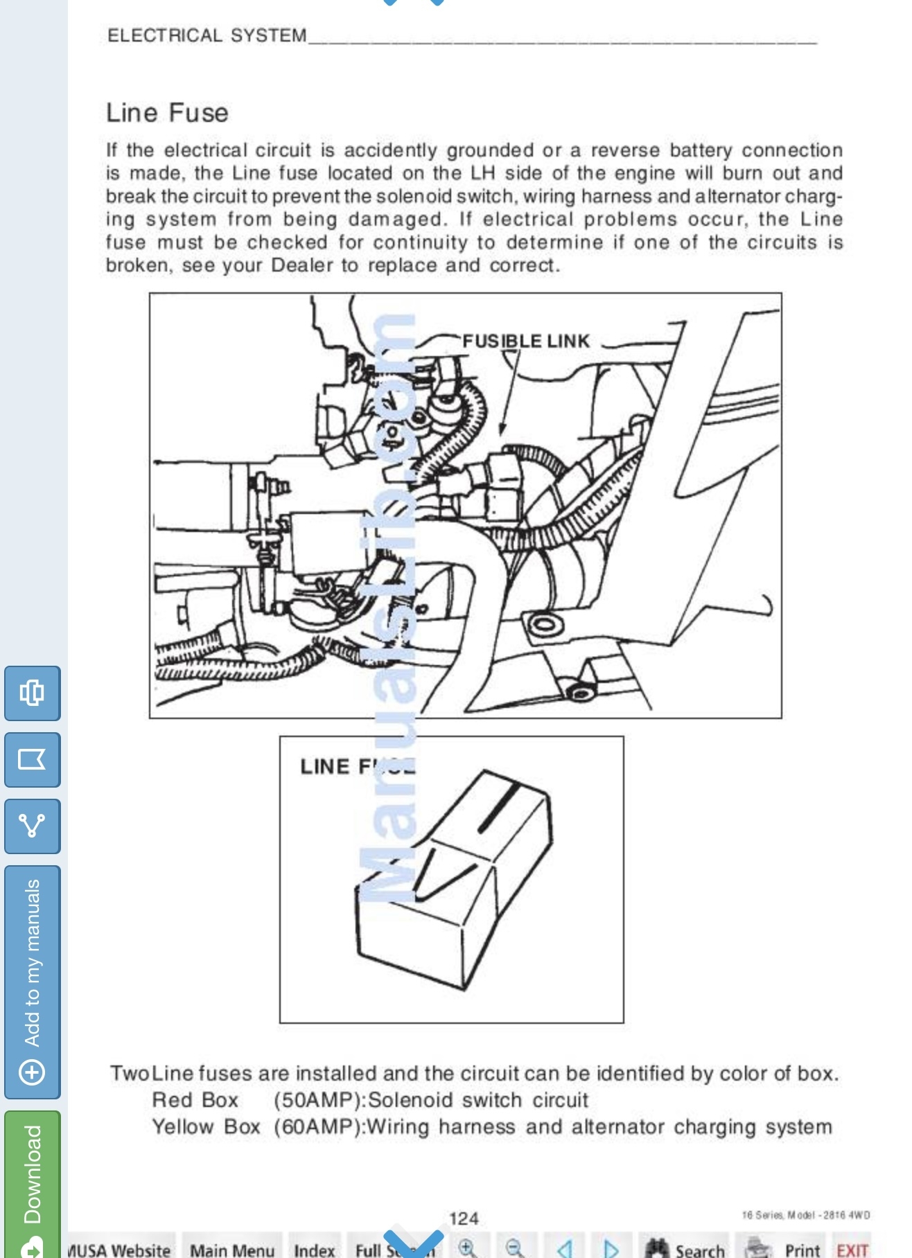

I'm troubleshooting a problem on a 1526 and looking for a wiring diagram. Does anyone know of a source?

I’m working on a 3016 HST and could also use a wiring diagram. Fuel shut off solenoid not working and replaced it. Evidently a wiring issue. Any help in getting into the dashboard would be good too.
Thanks!

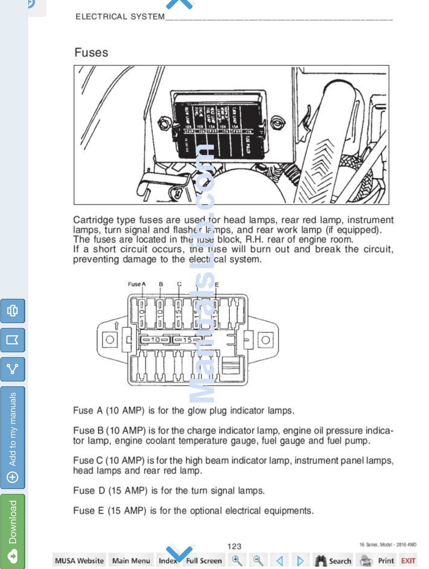

No idea if these will help anyone here, but believe in the power of sharing information…
